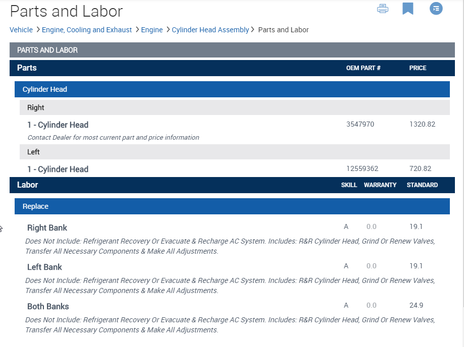

How long should it take to repair a head gasket.

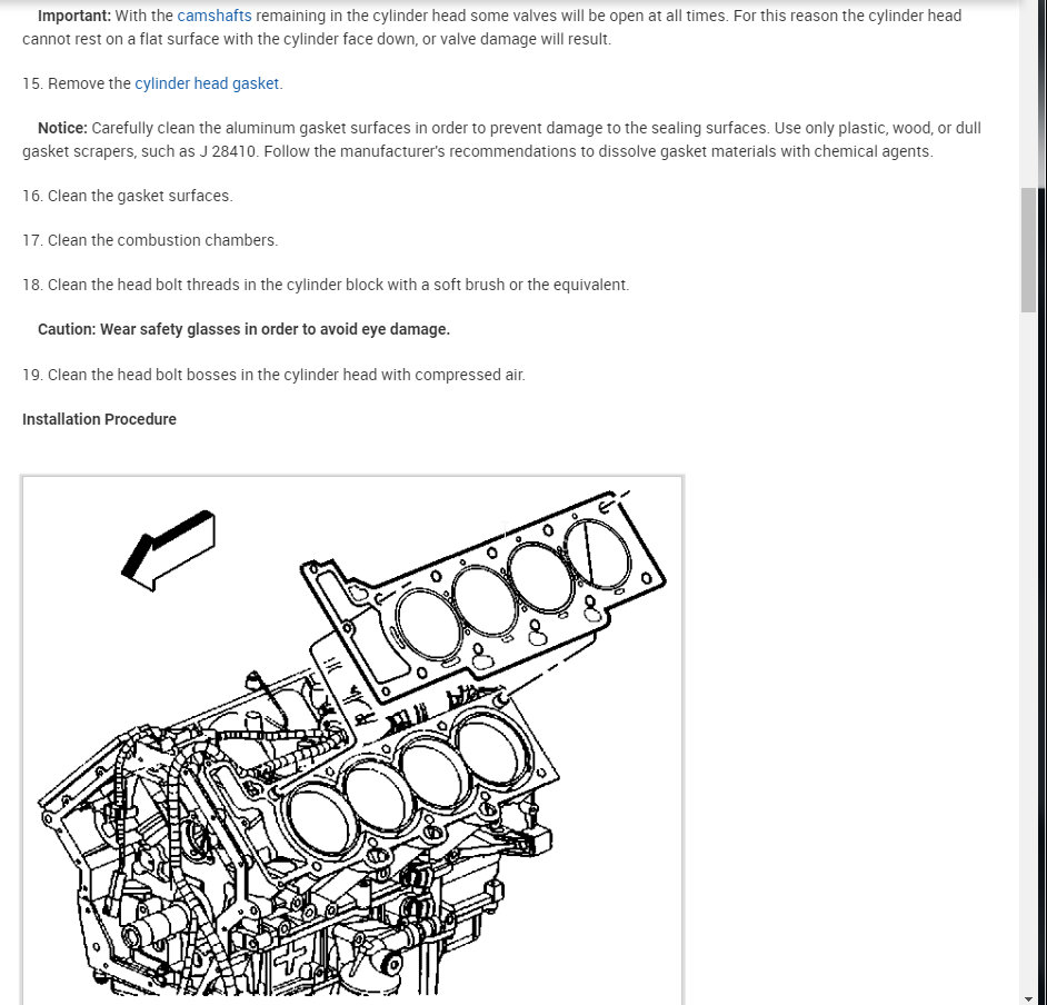

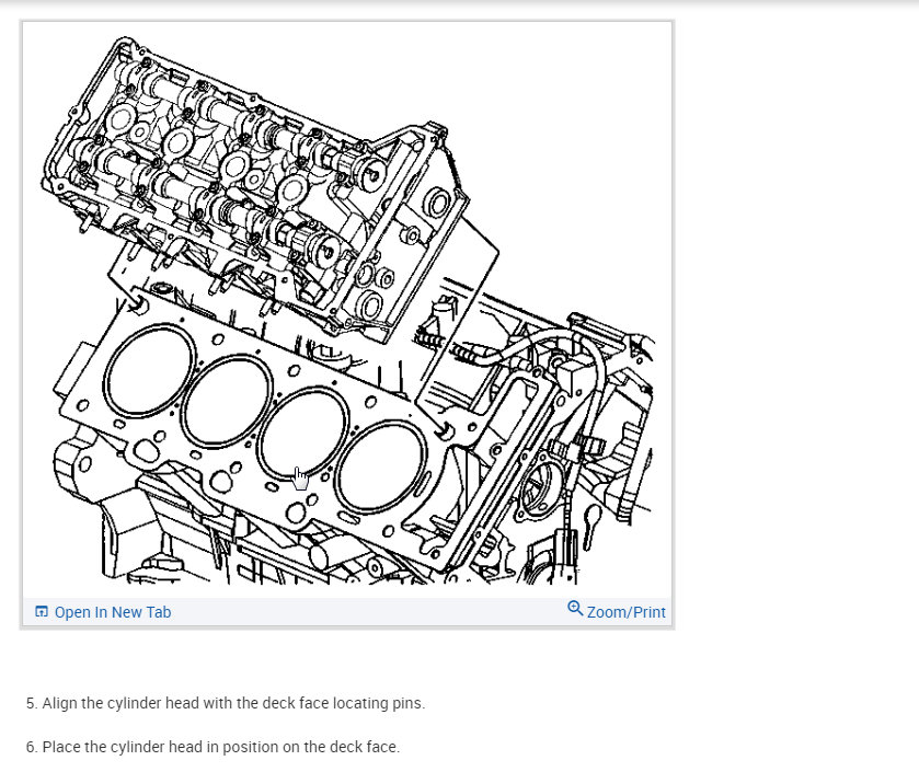

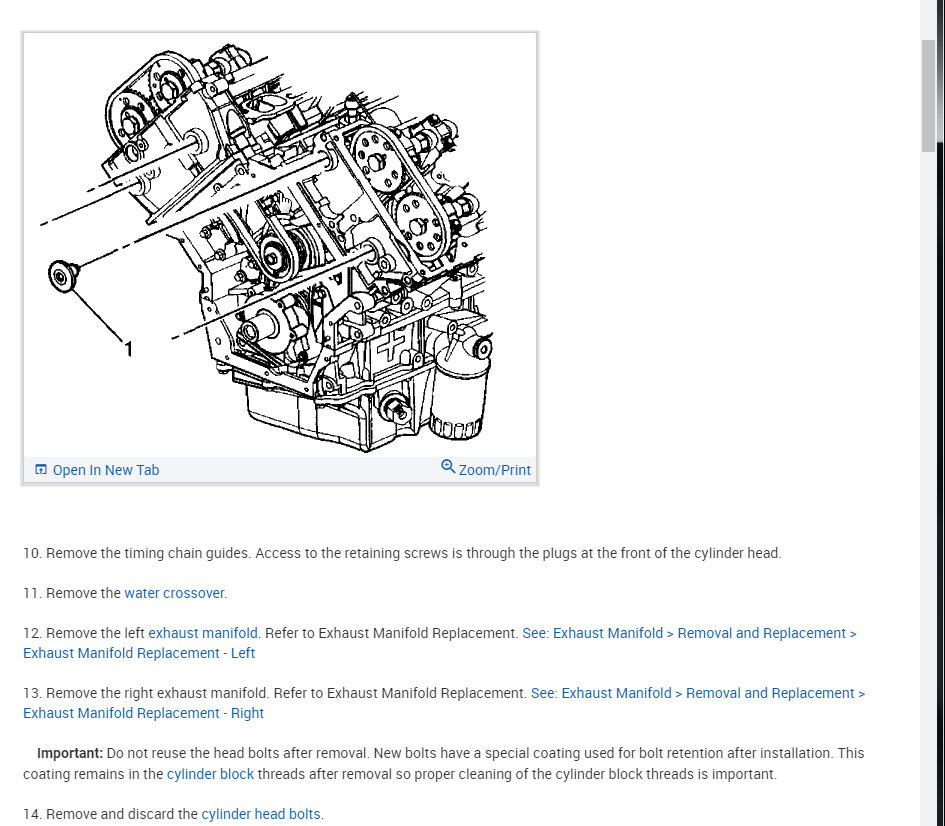

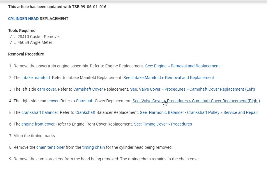

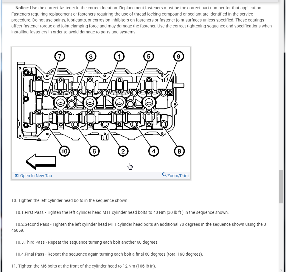

I included the process and the labor time (last page) according to AllData. Let me know if you have questions. Check out the diagrams (Below). Please let us know if you need anything else to get the problem fixed. Thanks
