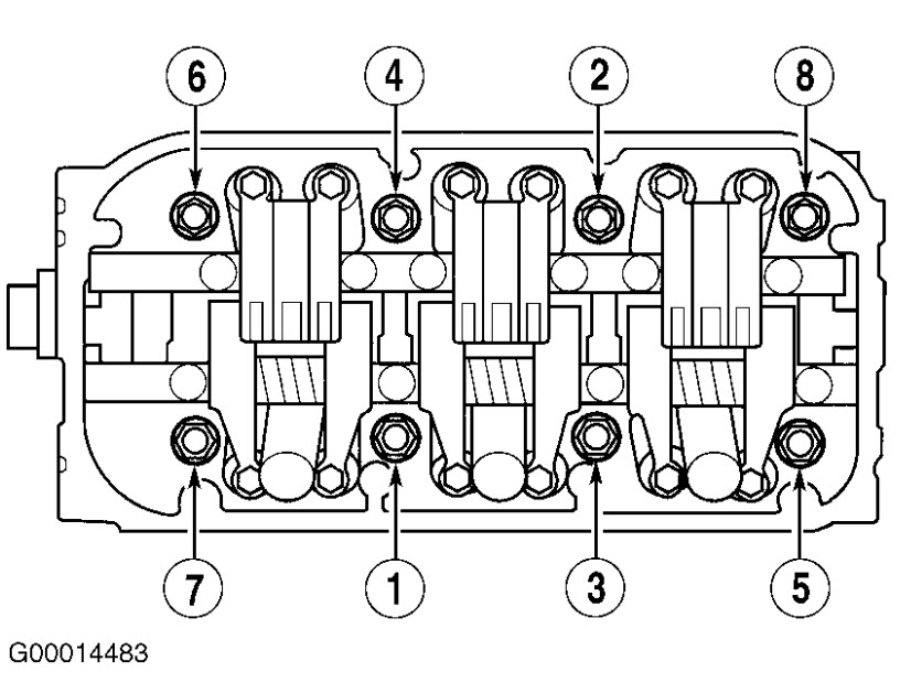

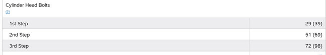

I need the cylinder head bolt sequence and torque.

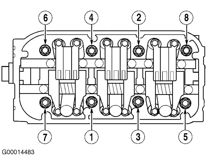

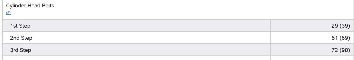

see pictures for torque and sequence. first columns in ft. lbs. second column numbers. Here is a video that show the correct way to use a torque wrench with diagrams and specs below.
