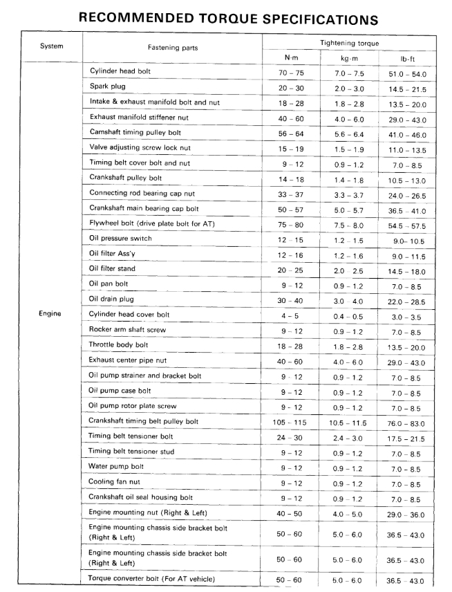

The cylinder head bolt toque is 51 to 54 Foot pounds here is a video that shows how to use a torque wrench with a complete engine torque guide below.
