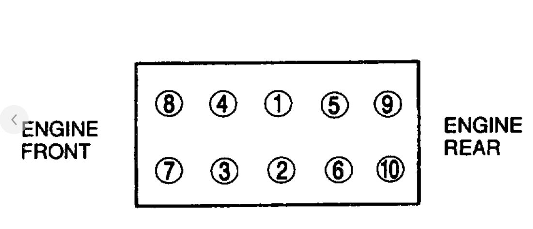

Head bolt torque and sequence ?
2000 MAZDA PROTEGE
15,800 MILES • 1.6L • 4 CYL • 2WD • AUTOMATIC
PENNYE ROBERTS
The vehicle listed above is the LX model. please help! I keep getting conflicting information from the web.
Sep 15, 2019 at 2:35 PM
Welcome to 2CarPros.
Here are the torque specs and procedures. The sequence is listed in the picture I added.
Cylinder Head Bolt Tightening Sequence
Torque:
1st: 17.2 - 22.0 Nm (1.75 - 2.25 kgf-m, 12.7 - 16.2 ft. lbs.)
2nd: + 85° - 95°
3rd: + 85° - 90°
___________________________________
Note that the second and third time you go over them the above listed numbers are not ft/lbs. They are in degrees of turning.
Let me know it that helps or if you have other questions.

head bolts torque sequence for a 2000 mazda 1.8l protege
Oct 31, 2020 at 11:57 AM (Merged)
SATURNTECH9
  • 30,869 POSTS
https://www.2carpros.com/forum/automotive_pictures/416332_2000_mazda_protege_1_1.jpg
Tighten the cylinder head bolts in two or three steps in the order shown to achieve a final torque of 76-81 Nm (56-60 ft. lbs.) There you go.
