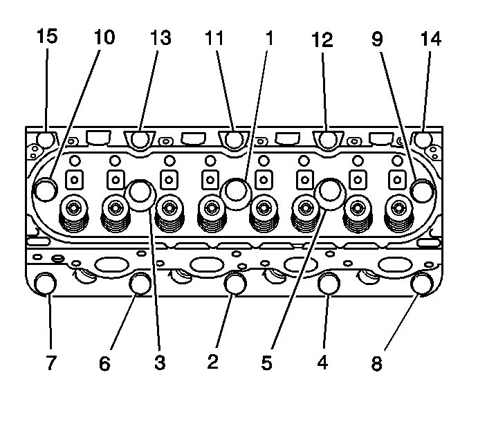

Here is the sequence for torque.
8. Tighten the cylinder head bolts.
1. Tighten the M11 cylinder head bolts (1-10) a first pass in sequence to 30 Nm (22 lb ft).
2. Tighten the M11 cylinder head bolts (1-10) a second pass in sequence to 90 degrees using J 45059 .
3. Tighten the M11 cylinder head bolts (1-10) a final pass to 70 degrees using J 45059 .
4. Tighten the M8 cylinder head bolts (11-15) to 30 Nm (22 lb ft). Begin with the center bolt (11) and alternating side-to-side, work outward tightening all of the bolts.
