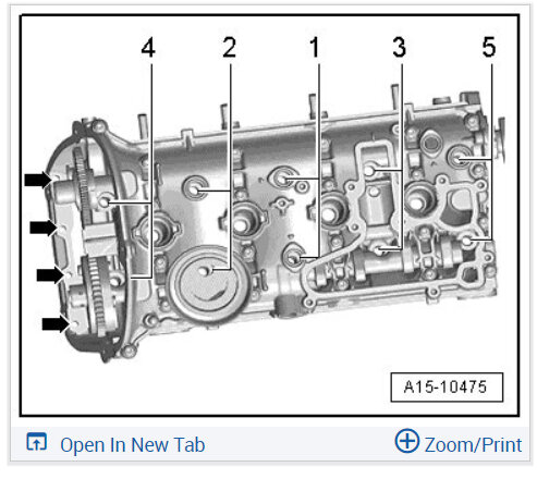

Cylinder Head Tightening Sequence on the 1.8L Engine
Tighten the cylinder head bolts in - 1 to 5 - sequence.
Partially tighten to 40 Nm using a torque wrench.
Turn another 90° using a rigid wrench.
Partially tighten the bolts - arrows - to 8 Nm.
Tighten the bolts - arrows - 90° further using a rigid wrench.
