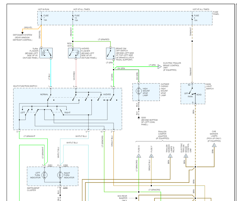

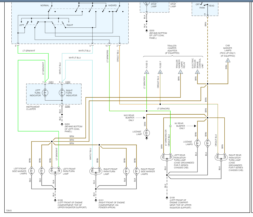

My hazards have been out for a while but recently my turn signals stopped working. All other lights functioning as normal (except one tag light) I replaced the MFS and the flasher on the dash fuse panel. No luck Fuse 13 is hot always and 7 is hot in run. Looking at the schematic, it looks like there may be two separate flasher modules. Is this correct? If so, I can't find the second one. I am just starting to check wiring. Seems odd they would stop working seperately. Thanks for any help you can offer. Jim

It does look like there are two flashers, but I think the problem is the multi-function switch. Dirt gets down inside of it and messes with the contacts, you can try Cylinder relearn the switch about 20 times to see if it cleans the connects.
Here are the wiring diagrams and a guide to see where you lose power:
Here is how you can change the switch out in case you need it:

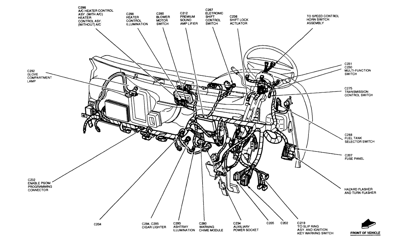

Yep, sorry about that, MFS now I get it. There are two flashers in the fuse panel in front and one in the back of the panel.
The Turn Flasher is located behind LH side of the instrument panel, on the front of fuse panel.
and
The Hazard Flasher is located behind the Left Hand side of the instrument panel, on the rear of the fuse panel, behind the turn signal flasher. check out the image below.

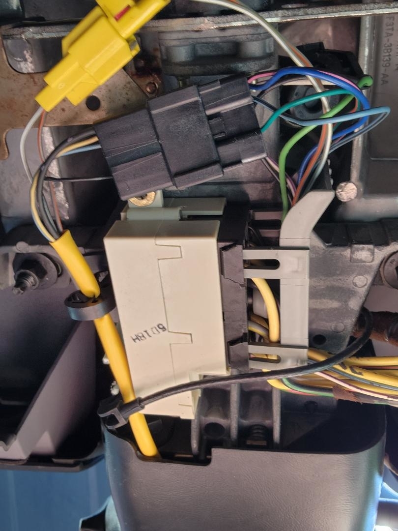

Hey Ken, update on my truck. After doing some bench testing and continuity tests, I discovered that the MFS I just bought was a POS! Not working! I put the old switch back in (with a replacement flasher) and I now have turn signals again! My big problem now is, where is the hazard flasher? I checked the backside of the dash fuse panel and there is not nor ever has been a flasher on the back. The photo shows a mystery box on the bottom of the steering column. Any idea what this is? I see nothing that looks like a flasher.
Aug 23, 2022 at 10:22 AM
That is not the flasher, that's for sure. Good job on the MFS find. Bad parts are no fun at all. The manual says the flasher is on the backside of the fuse panel.
