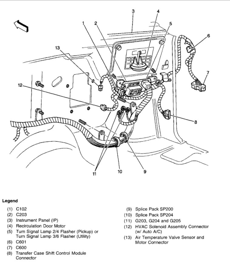

My blinkers and hazard lights just stopped working. I do not know where the flasher is located or which relay to replace. I have changed all fuses. What could it be just for them to both stop working at the same time out of the blue?

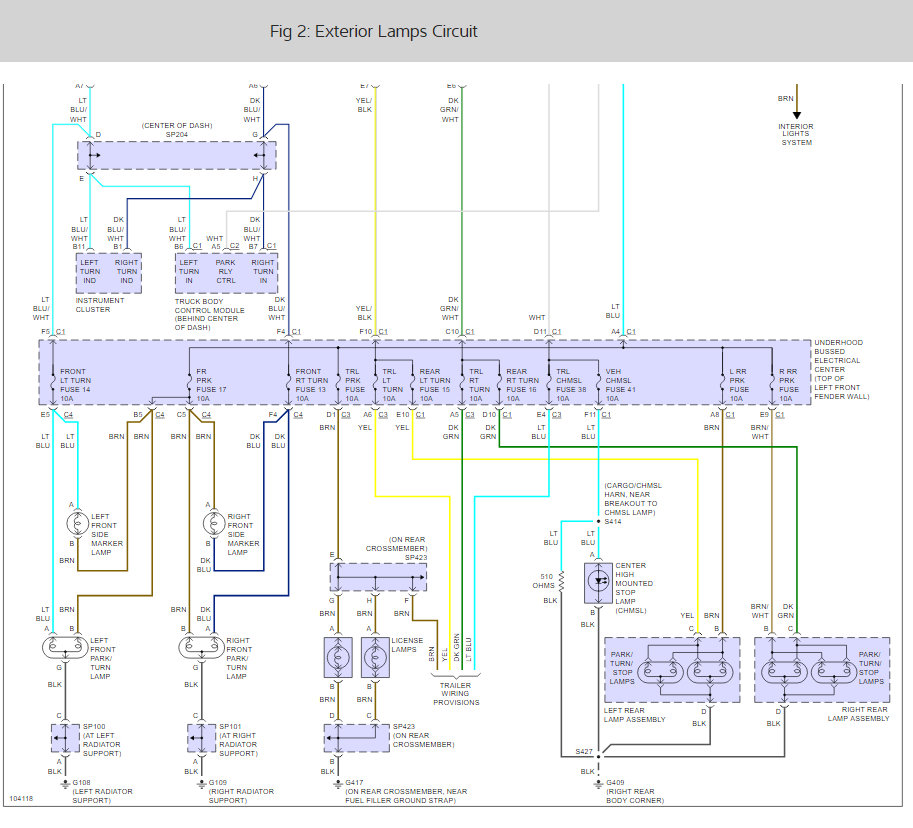

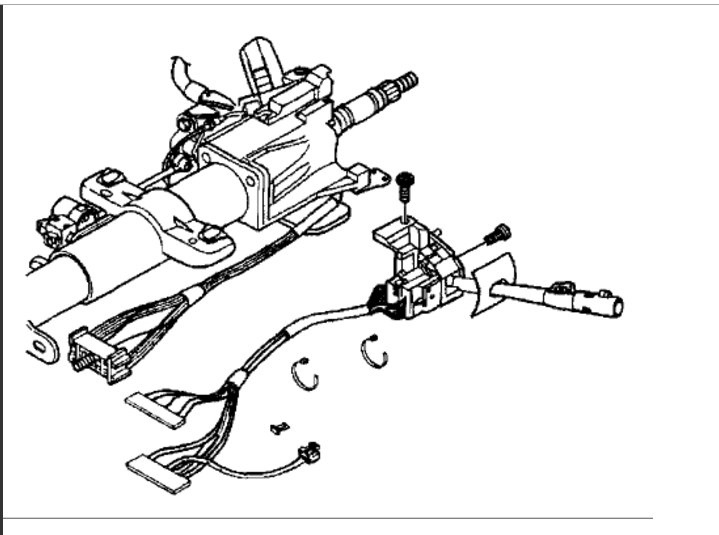

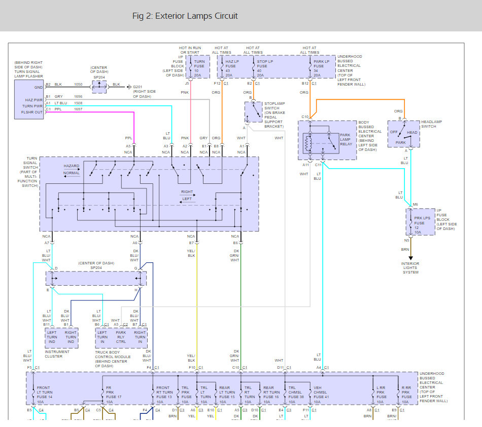

There are more fuses in the system then just one so please recheck those. If the all okay then check the combination switch and the flasher.
Here are some guides and diagrams to help you get the job done:
Please run this test and get back to us we are interested to see what it is.
