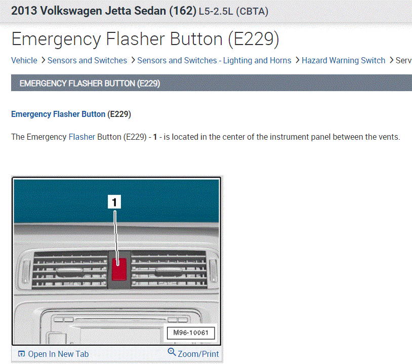

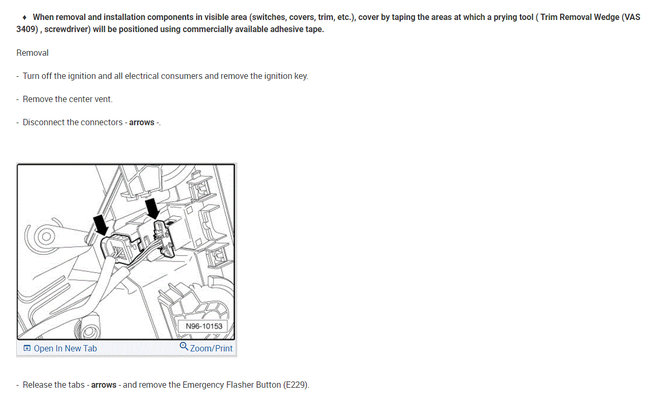

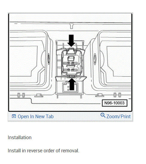

How do you replace the hazard switch on the car listed above?
Jun 2, 2021 at 6:37 PM
CERTIFIED EXPERT
110,175 POSTS
The switch isn't too hard of a job. If you look below, I have attached the directions for the removal and replacement of the switch for you.
I hope this helps. Let me know if you have other questions.
See pics below.
