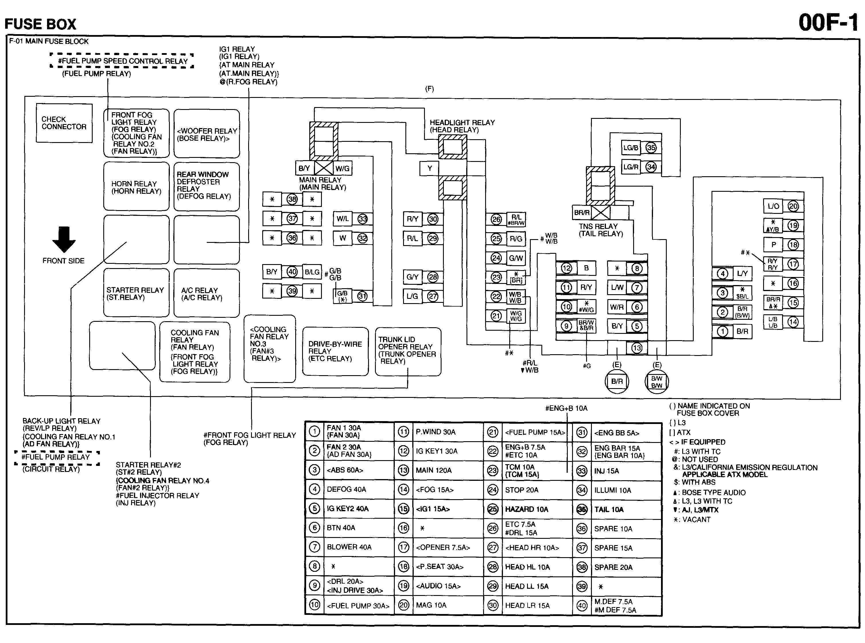

There is a relay in the under hood power distribution box. See picture 1.

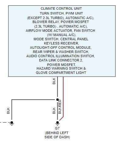

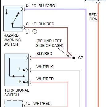

Also, check ground 7. It is under the dash, left side. I attached two pics which are schematics. I am questioning that ground because it is common to both components.
