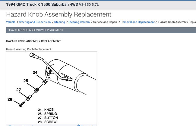

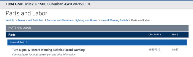

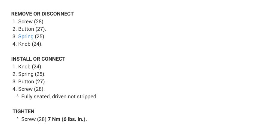

In the diagrams down below I have included the Original Equipment Manufacturer [OEM] part number for reference as well as the instructions for the removal and installation of the hazard warning switch[including a diagram of the location] for your vehicle for you. Please go through this guide and get back to us with how everything turns out. I hope that this helps.

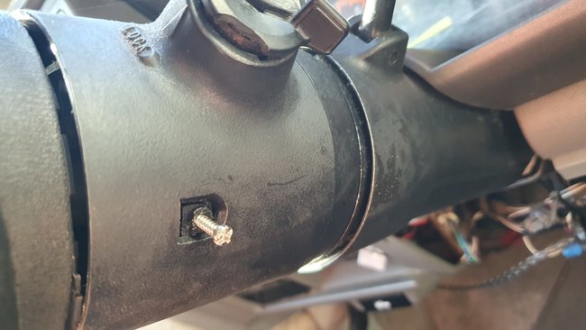

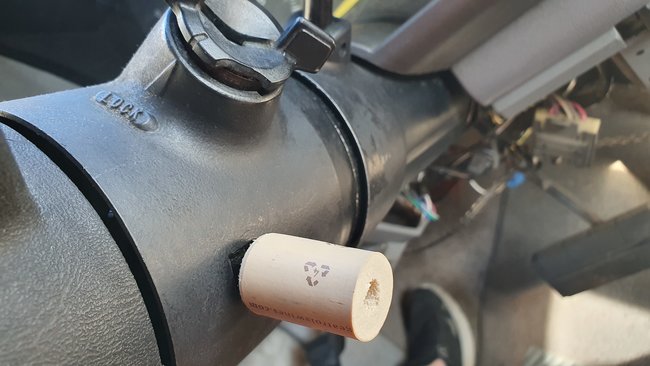

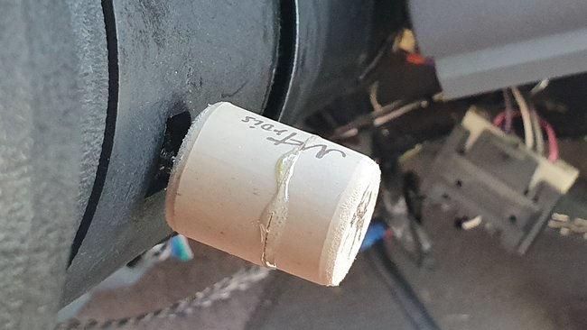

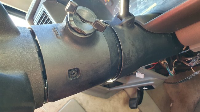

Thank you so much for your help! I really appreciate it! Even before the breakfast, I got into the truck and looked for the switch. The hazard switch was broken off flat but I was able to manage stick a screw into the small hole in the middle. The switch worked fine as it should be. The truck is pretty much beat up everywhere and I decided not to replace the switch with a new one.
The location of the switch is just bad. Very easy to knock it down with driver's knee. So, even if I replace with a $18.00 new switch, I can't guarantee it will stay there forever.
I am so happy that it was such an easy fix for the truck. I can warn people now when driving!!!
*** The first picture shows the location of the Hazard switch, second picture shows how I stuck a screw in the hole, and the third picture shows the truck from outside.

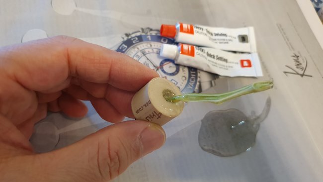

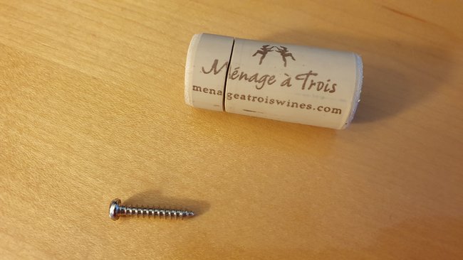

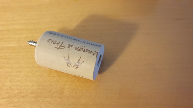

Just like my father used to say, "never toss the cork." In order to save my fingernails I made custom Hazard switch. Thank you so much, again!
