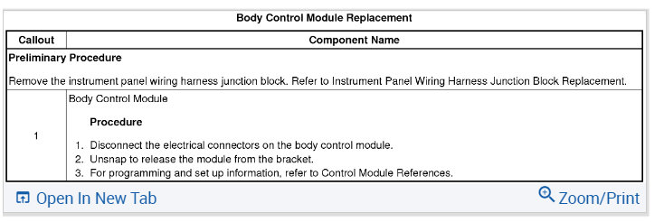

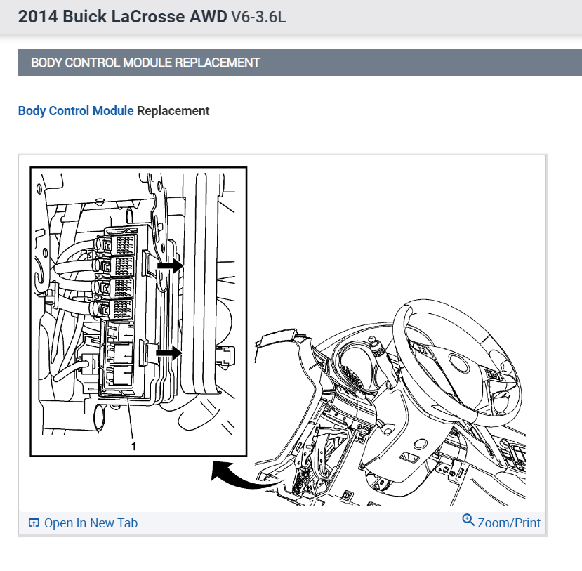

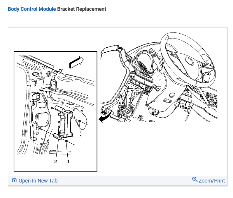

Yep, it sounds like the BCM is going out. To be sure let's do a CAN scan which is the future of automotive repair you can get a CAN scanner from Amazon for about $30.00. here is a video to show you how and a link to a scanner from Amazon. I have left instructions on how to change out the BCM in the diagrams below.

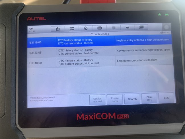

Okay, thank you for this information. After having the car scanned the code:
U0140 - Lost communications with BCM.
I attached the image below so that you can see what displayed. Also, is there a way I can get the model/part number for my BCM without having to remove it first?

Nice work on the scan.
Body Control Module - 13580698 - $198.37 OEM
