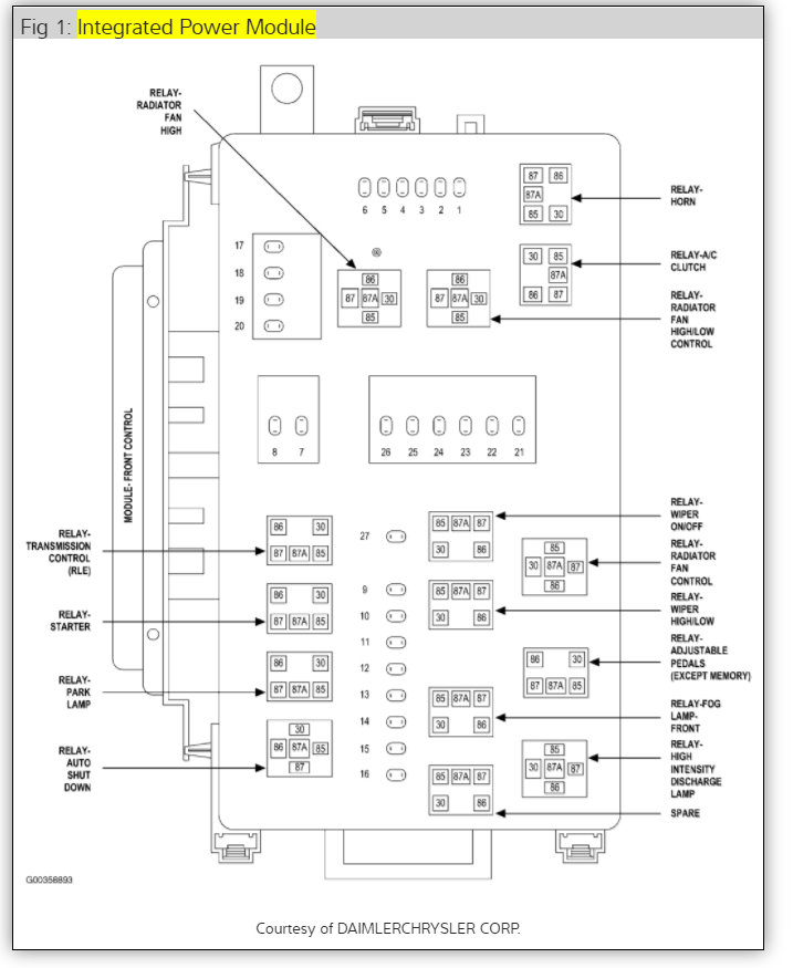

I already checked the fuse box, replaced the hazard button on the dash, and i changed a relay (that is related to the flasher lights) inside the instrument panel. Still does not work! I am wondering if anyone is familiar with my problem.

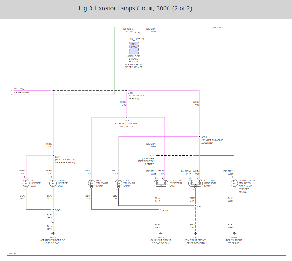

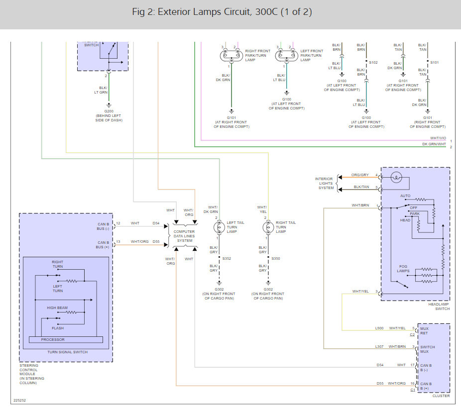

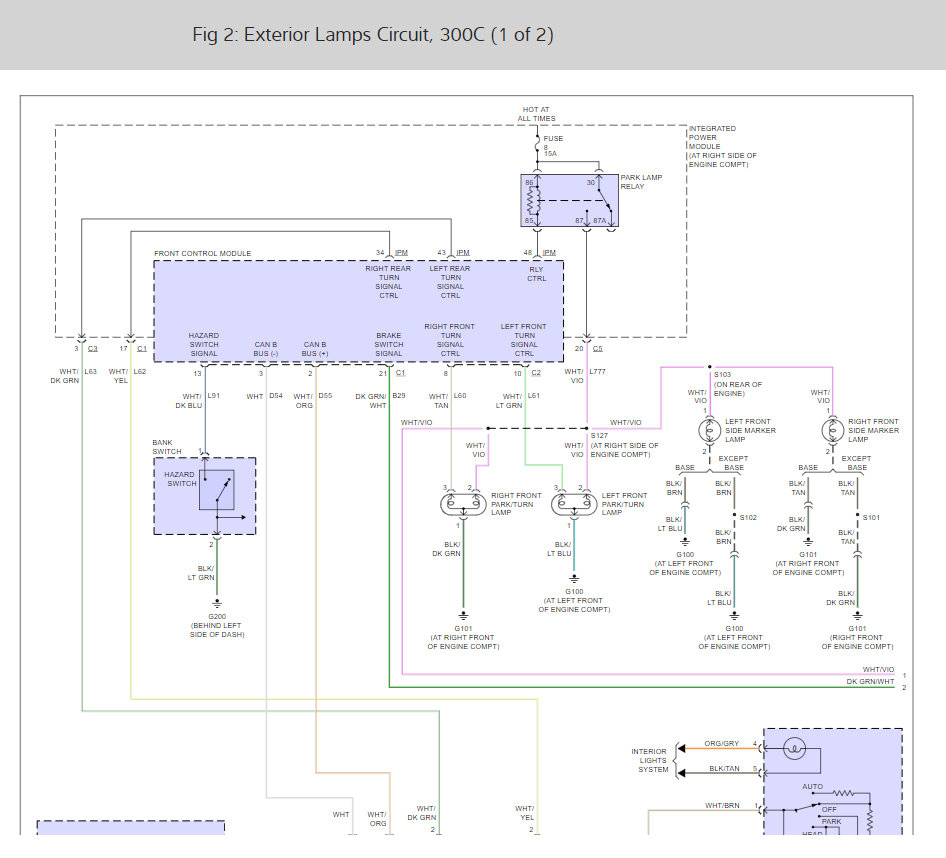

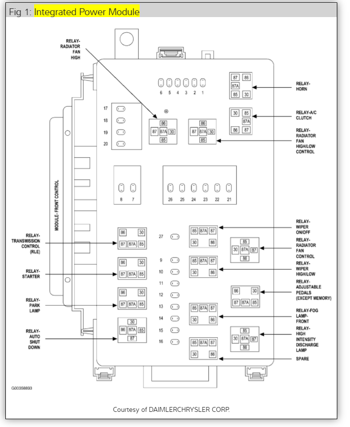

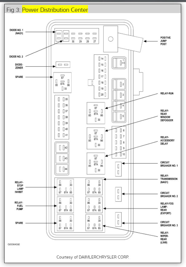

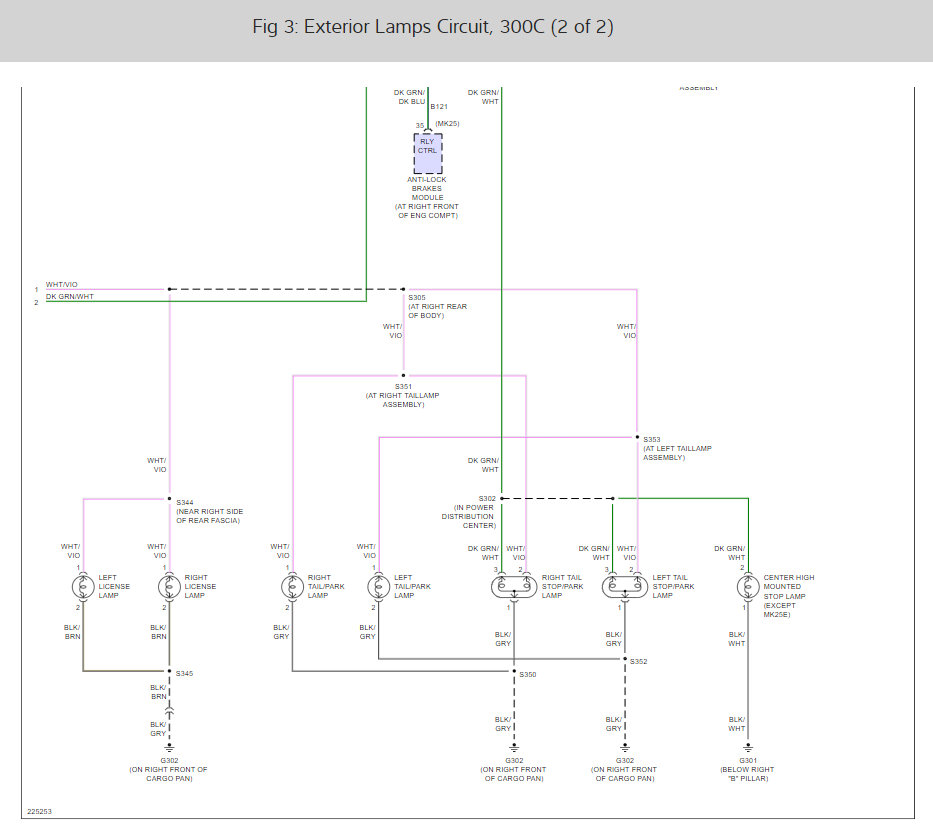

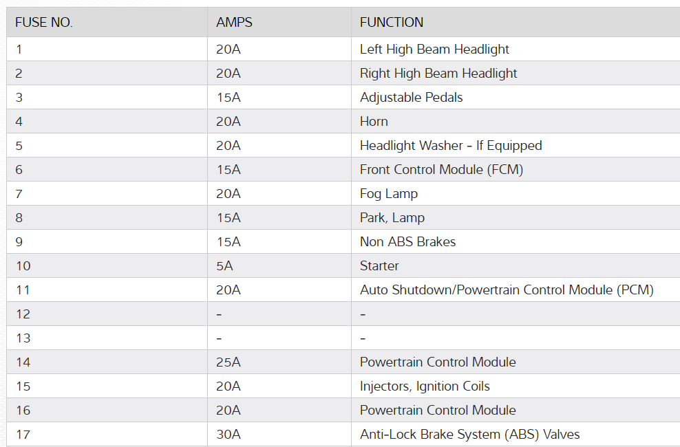

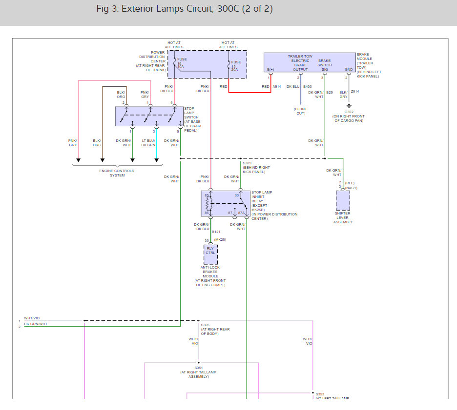

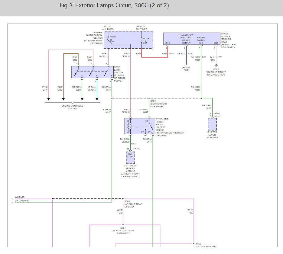

This can be the hazard switch itself which ground the circuit at the front control module. Here is a wiring diagrams to help you see how the system works.

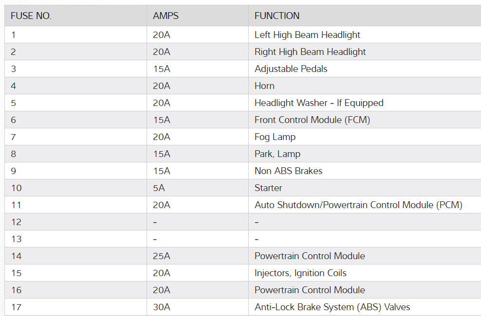

Also check the fuses.
I would try grounding the hazard switch wires to see if the hazards start working
Check out the diagrams (below).

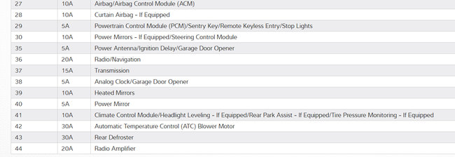

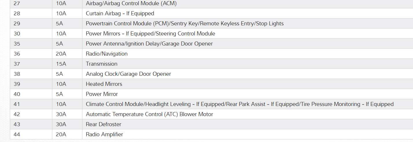

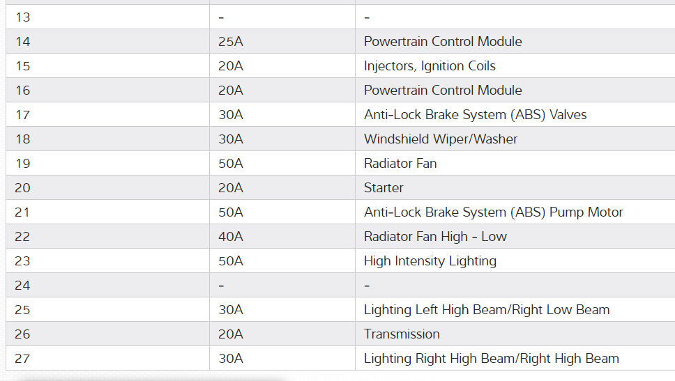

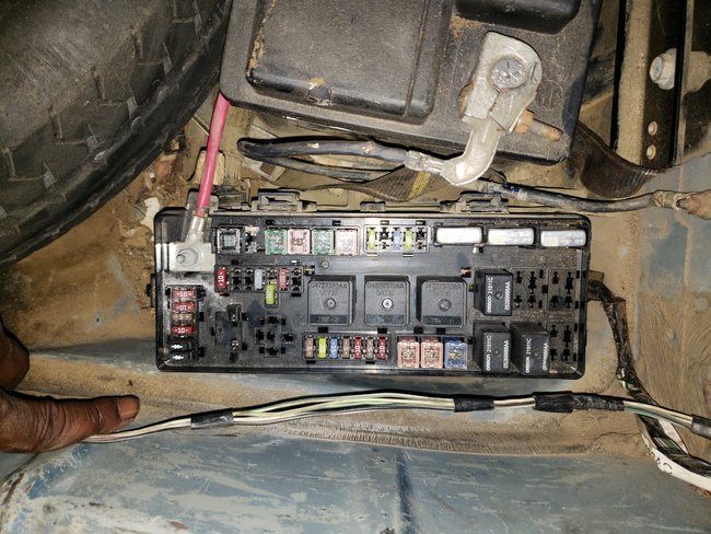

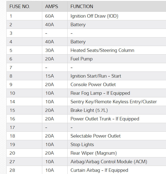

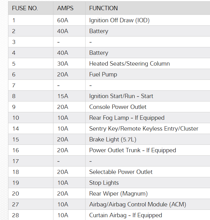

I just found out how to fix this, in the trunk fuse box is the big silver 25 amp fuse. In the upper right hand side. Its either #11 12 or 13. I don't know because I switched all of the at once.
