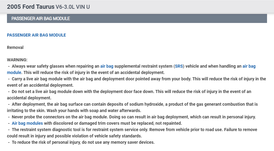

And the second question is, what is the safest method to go about removing the passenger airbag in the car listed above?
I'm familiar with the power one of those has, so my assumption is the standard disconnect the battery, wrap the terminals in electric tape for extra safety and turn the key on for 10-20 minutes to discharge the capacitors and then let it sit overnight (and of course, safety glasses, nitrile gloves, etc.). I want to approach it as safely as possible so there's no setting off of the airbag, as I don't have the almost $1,000.00 I'm being quoted for that job.

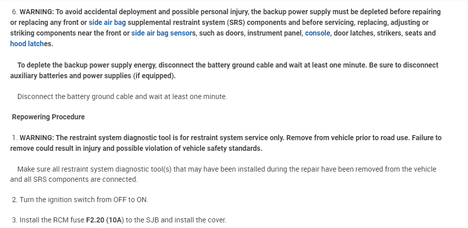

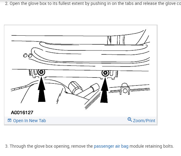

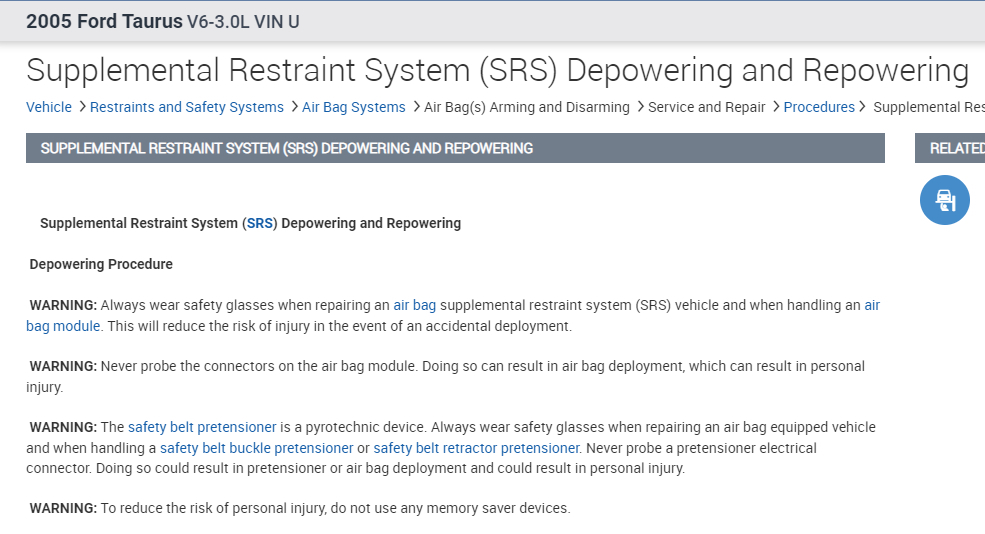

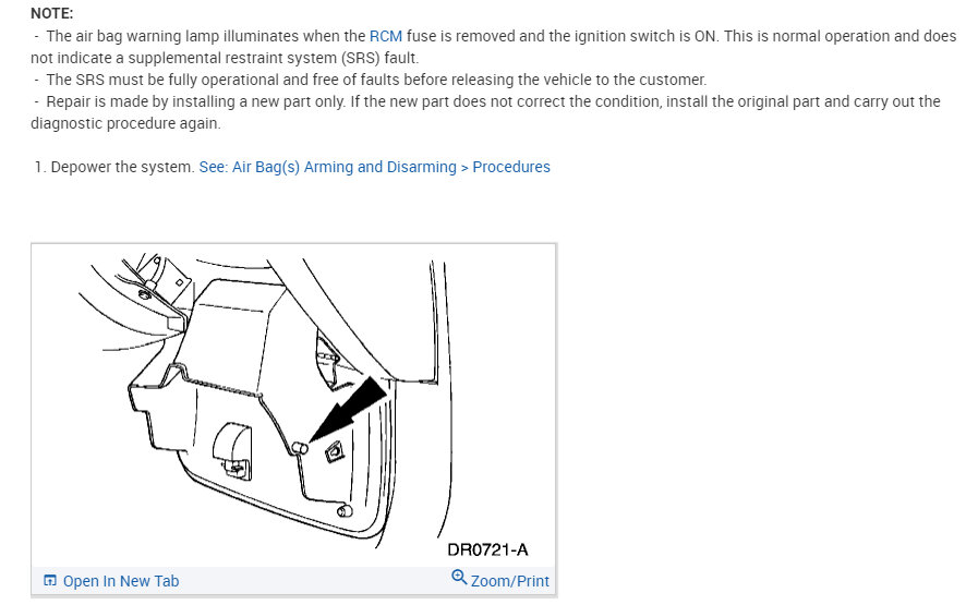

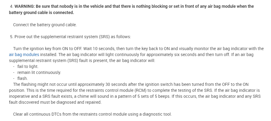

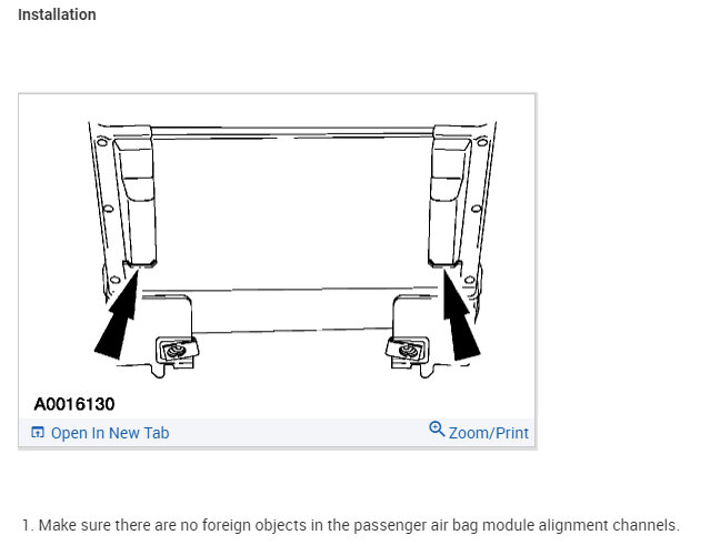

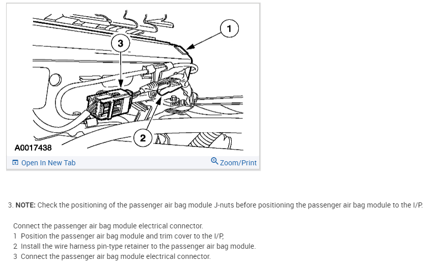

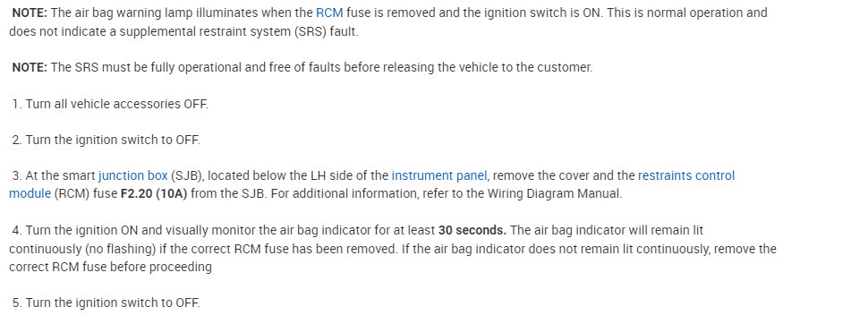

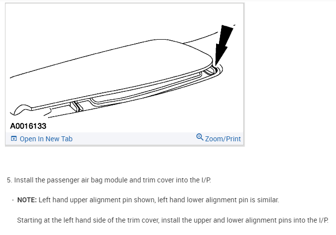

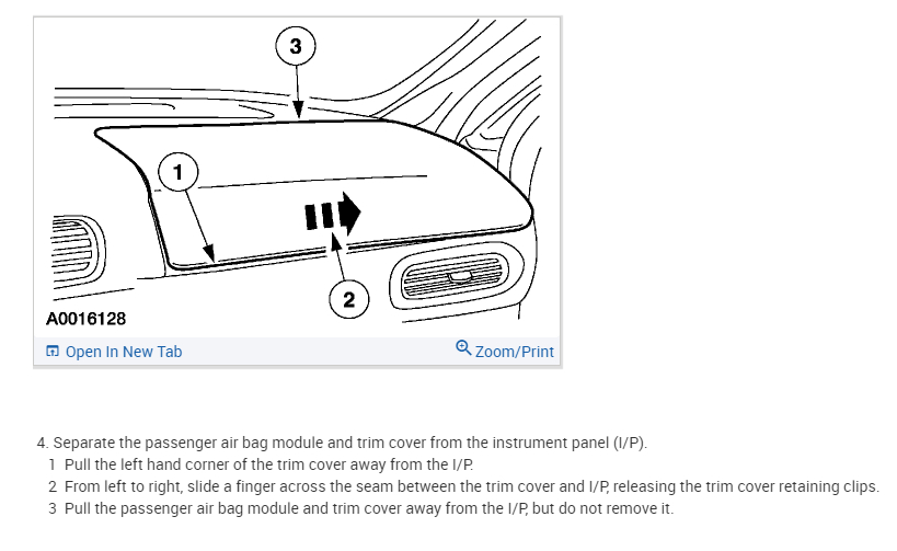

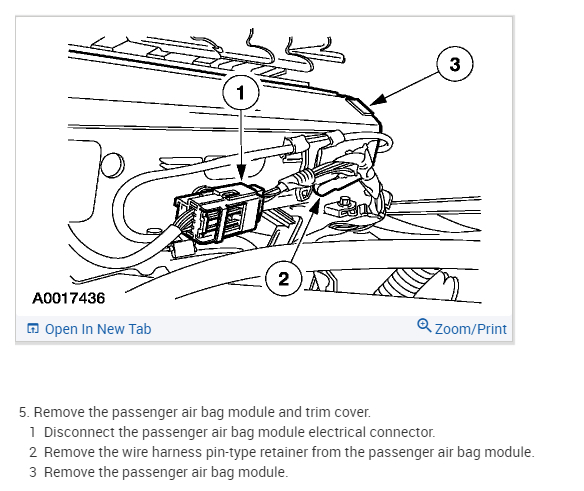

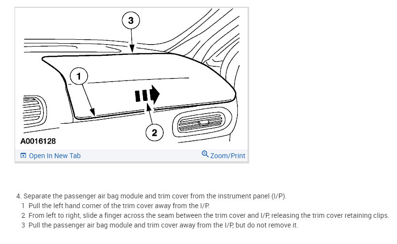

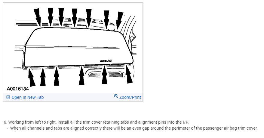

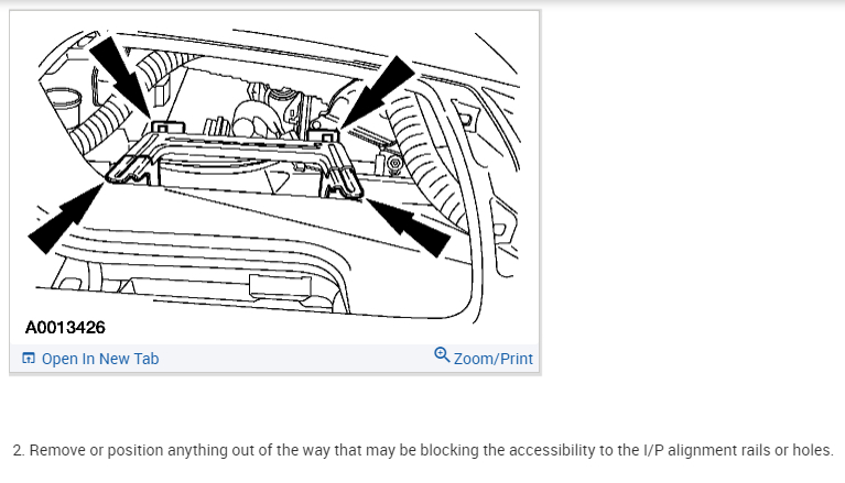

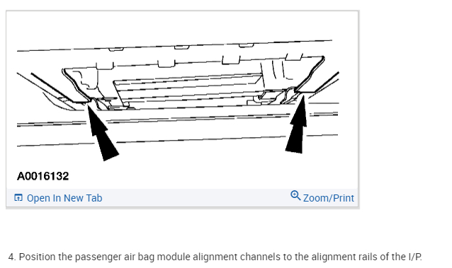

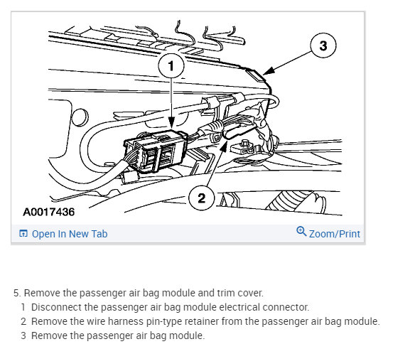

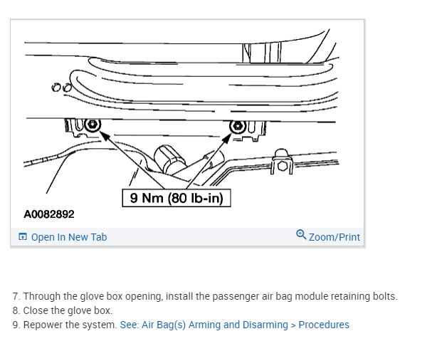

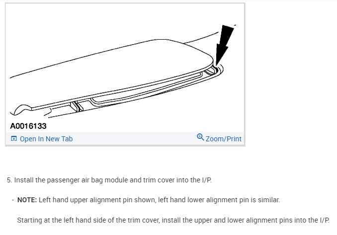

The vacuum hose should be the same as what you purchased. As far as the airbag is concerned, you need to be careful and follow the directions I'm attaching below.
The first four pics are the directions for depowering and repowering the system. The remaining pics are the direction for removal/replacement of the airbag.
See pics below.

I plan to follow everything to the letter, but I'm curious, is the fuse removal necessary when the system is going to be de-powered by disconnecting the battery and using the key cycle to discharge the capacitors (also going to let it sit overnight after disconnecting and key-cycling, and wrap the terminals with electrical tape just as an added precaution)?

First, you are very welcome. I'm glad to know it is helpful.
As far as the fuse is concerned, I would suggest removing it in the order indicated. There are capacitors that can hold power. Even though the battery is disconnected, I would still remove the fuse. We want to do everything we can to prevent the airbag from accidental deployment.
I don't want to scare you. LOL Just stick to the directions and you'll be fine. Also, allowing it to sit overnight with the battery disconnected is a good idea.
Let me know if there is anything I can do to help.
