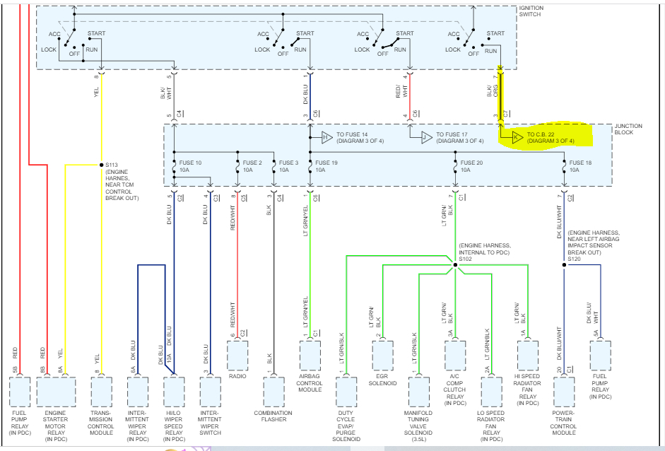

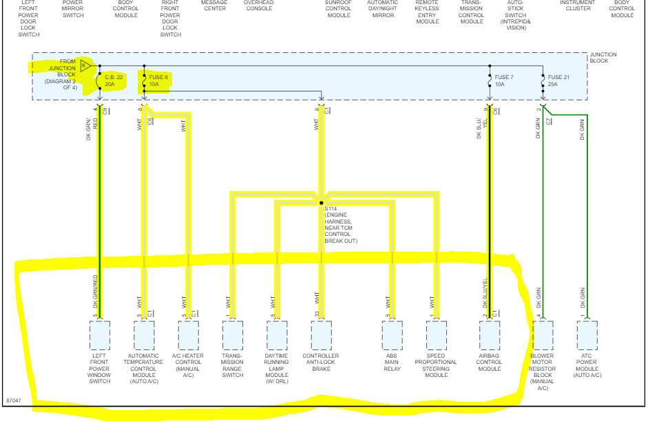

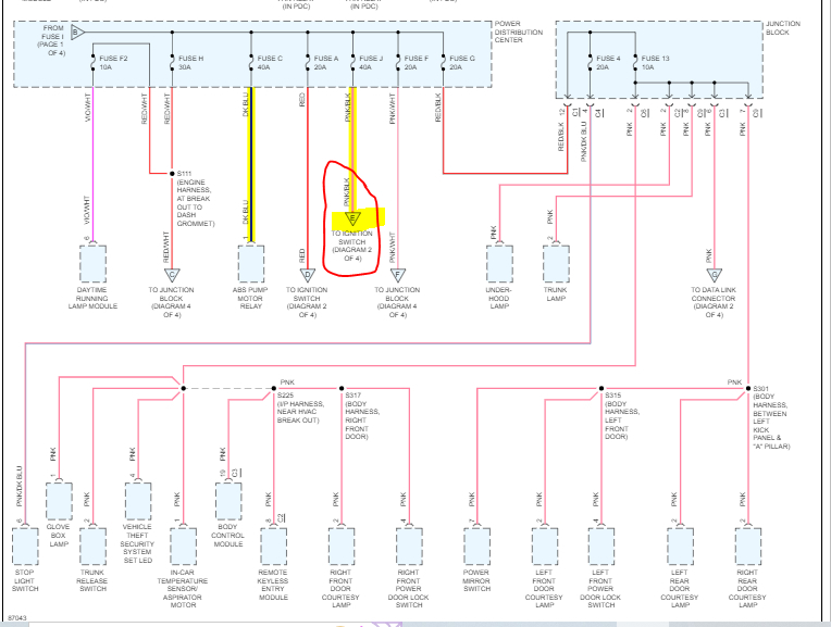

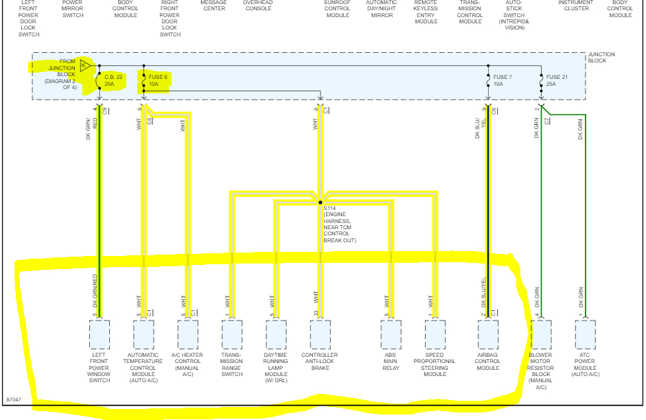

However, I believe I know what the issue may be. If you look below, I attached the wiring schematic. Everything that I consider relevant has been highlighted.
In the last pic, I highlighted and circled all the components you mentioned. Note they get power from two different fuses in the junction box. Actually, the power windows get power from a circuit breaker. Since this happened all at once, we need to work backward to see where power is lost. I have a feeling if you were to remove the fuses in the last pic, you would find there is no power to them. If you want to try that first, here is a link that explains how it's done.

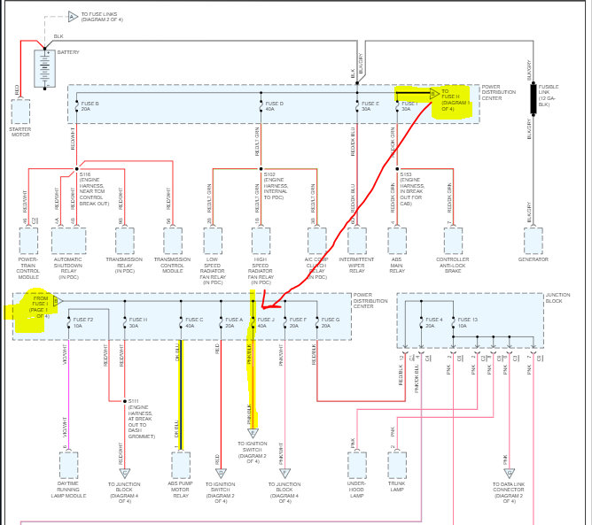

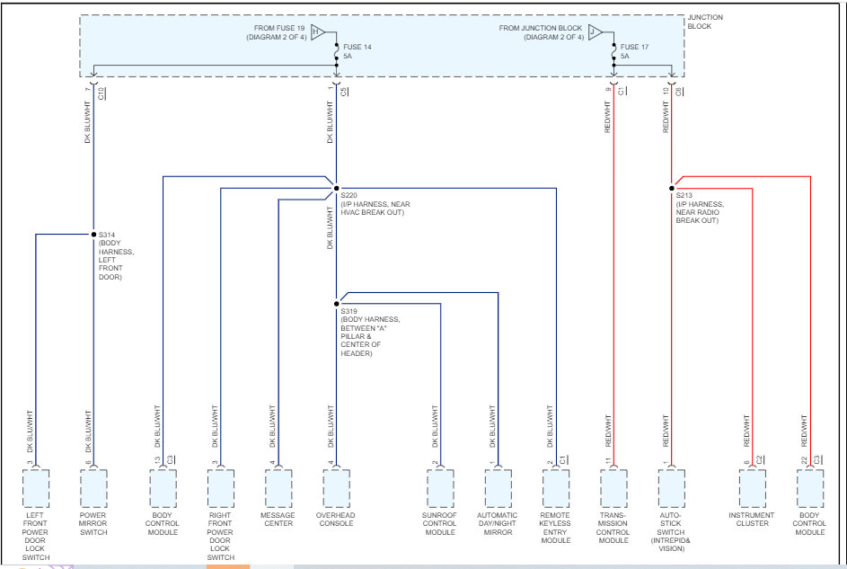

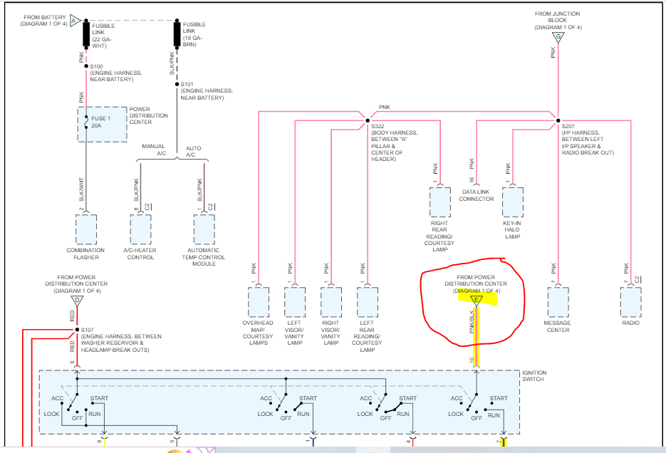

If there is no power to fuse 6 and circuit breaker 22, look at pic 4 (from left to right). Note that power comes from the ignition switch. Power to the switch comes from fuse J in the under-hood fuse box as seen in pic 2.

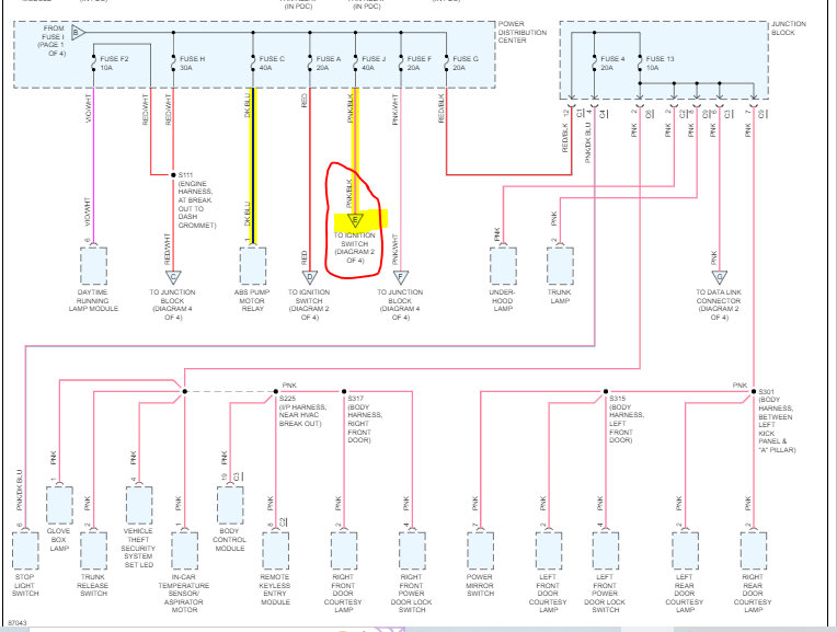

The power to fuse two fuse J is direct from the battery. See pic 1.
I suspect fuse J has failed in the power distribution box under the hood. I would start there.
When you check fuse J, first confirm the fuse is good. Also, it is very important to confirm there is power to and from it.
I realize this likely sounds confusing. Let me know if you have questions and what you find.
See pic below.
