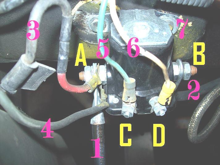

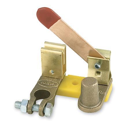

LETS INSTALL ONE OF THESE (OR SIMILAR) ON THE BATTERY SO THAT YOU CAN QUICKLY KILL IT WITHOUT THE NEED OF TOOLS! YOU CAN GET THIS AT AN AUTO PARTS STORE PRETTY DARN CHEAP.
SEE MY 1ST PIC

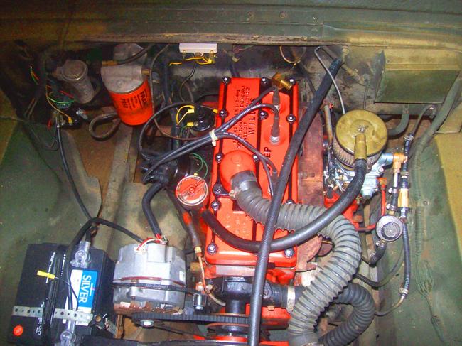

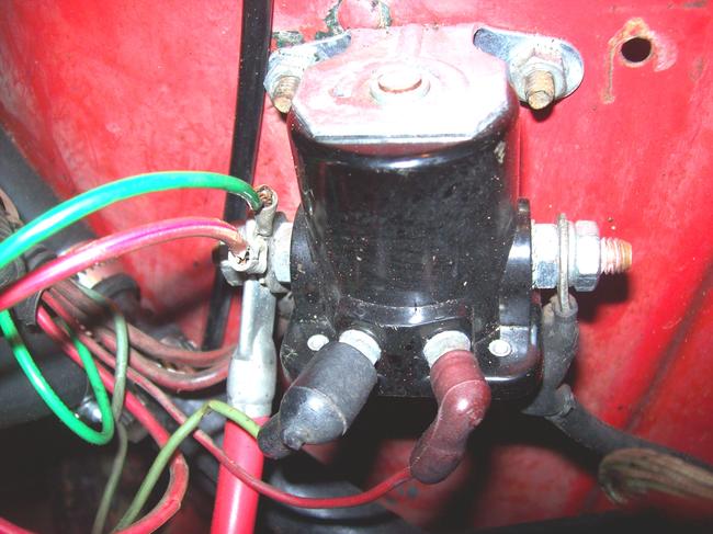

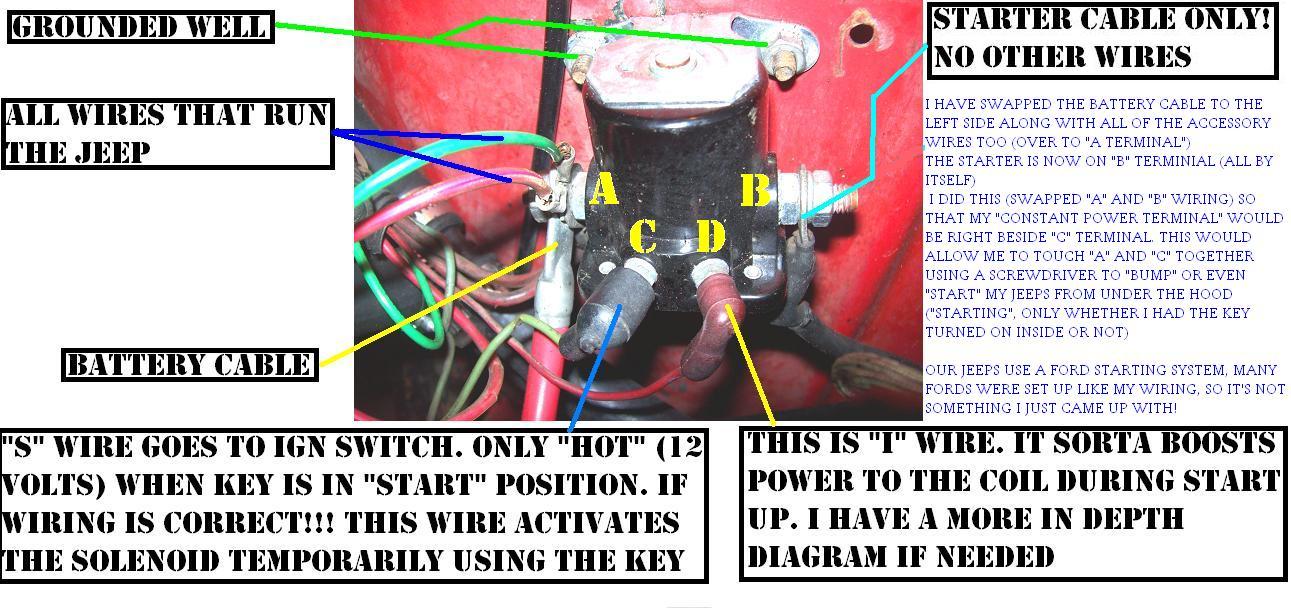

IN PICS 2 AND 3 YOU WILL NOTICE I HAVE SWAPPED THE BATTERY CABLE TO THE RIGHT SIDE IF THE SOLENOID (B TERMINAL)
I HAVE SWAPPED THE BATTERY CABLE TO THE LEFT SIDE ALONG WITH ALL OF THE ACCESSORY WIRES TOO (A TERMINAL)
PIC 2 IS MY 1946 WILLYS WIRED TO BE LIKE MY 1977 CJ-5 IN PIC 3 (NOT THAT THIS IS RELEVANT AT THIS TIME) I DID THIS (SWAPPED A AND B WIRING) SO THAT MY "CONSTANT POWER TERMINAL" WOULD BE RIGHT BESIDE "C" TERMINAL. THIS WOULD ALLOW ME TO TOUCH "A" AND "C" TOGETHER USING A SCREWDRIVER TO "BUMP" OR EVEN "START" MY JEEPS FROM UNDER THE HOOD ("STARTING", ONLY WHETHER I HAD THE KEY TURNED ON INSIDE OR NOT)
OUR JEEPS USE A FORD STARTING SYSTEM, MANY FORDS WERE SET UP LIKE MY WIRING, SO IT'S NOT SOMETHING I JUST CAME UP WITH!

LETS LOOK AT WHATEVER SIDE YOUR STARTER CABLE IS ON. IT SHOULD BE ALL BY ITSELF. THERE SHOULD NOT BE ANY OTHER WIRE ON IT! (SEE MY PIC 2 AND 3)
JUST TO CONTINUE TO AID YOU IF WE AIN'T GOT IT FIXED YET
WHEN IT "HANGS UP" AGAIN
BEFORE YOU KILL THE POWER
SNATCH OFF WIRE "C"
IT SHOULD STOP!
"C" IS THE WIRE THAT MAKES IT'S WAY ALL THE WAY BACK TO THE IGNITION SWITCH
TO THE "START" POSITION
IF THAT DON'T STOP IT
JUST FOR GIGGLES
SNATCH OFF WIRE "D" (I'LL EXPLAIN IT'S OPERATION LATER)
