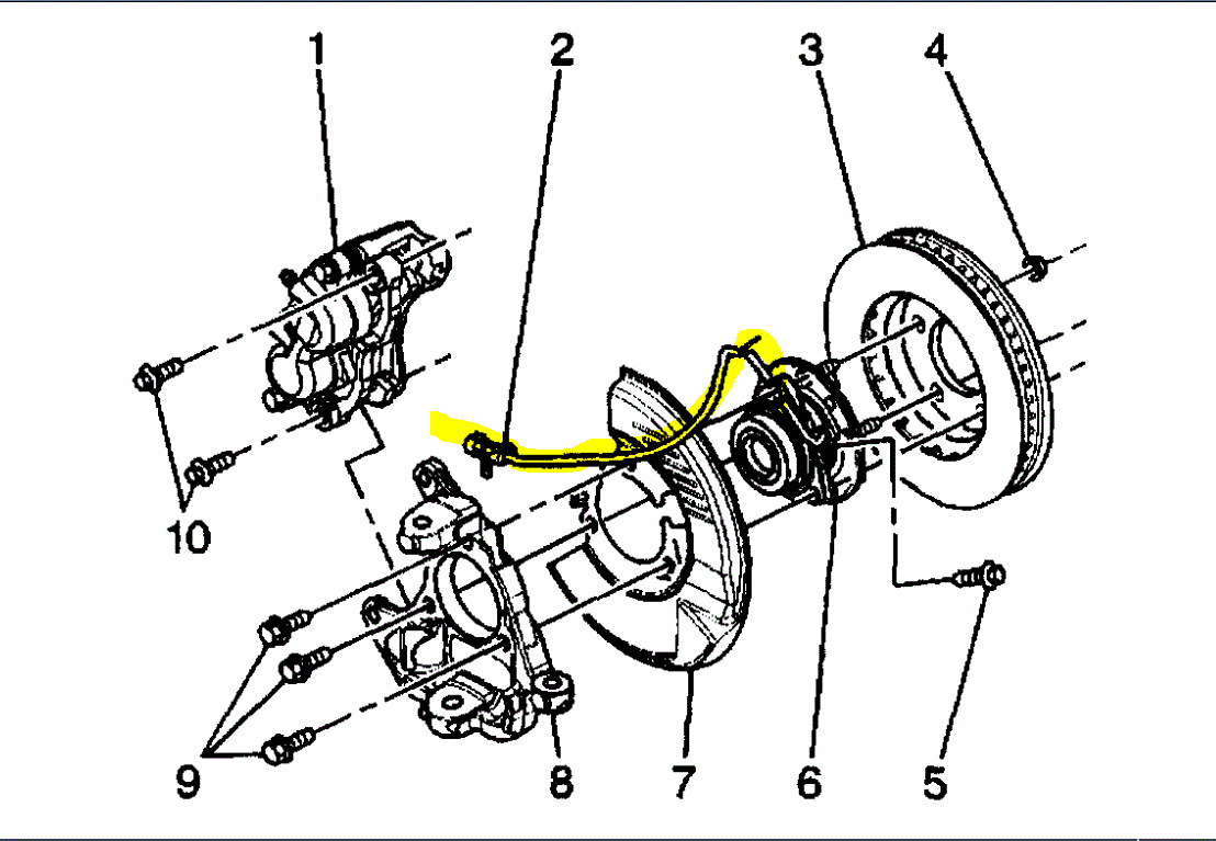

I attached a pic below showing the wheel speed sensor's location behind the wheel. Check that wire I highlighted and make sure it is connected and not damaged.
