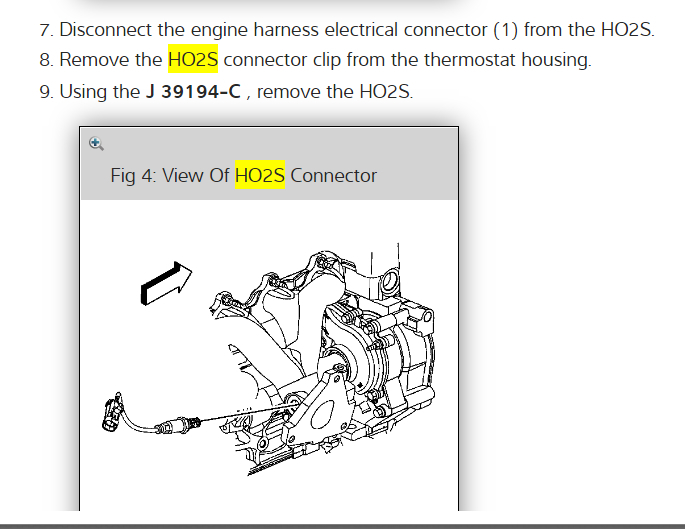

Don't know where it is located on the car listed above; lS 2.2l.

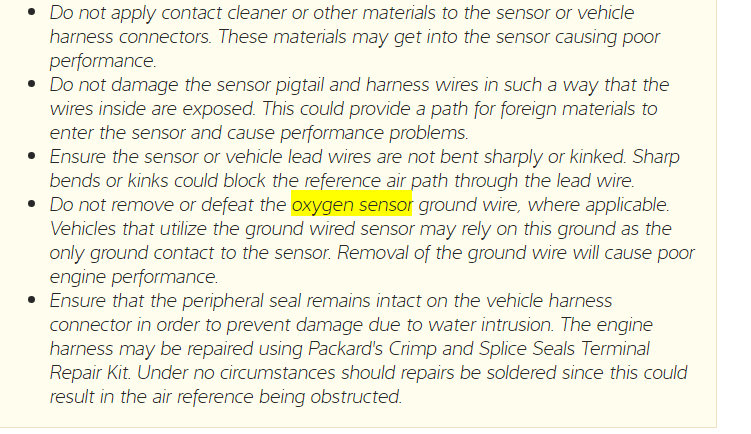

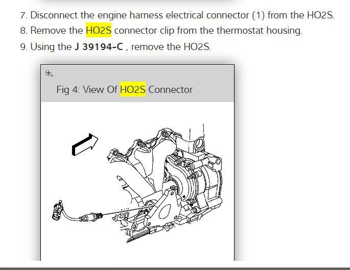

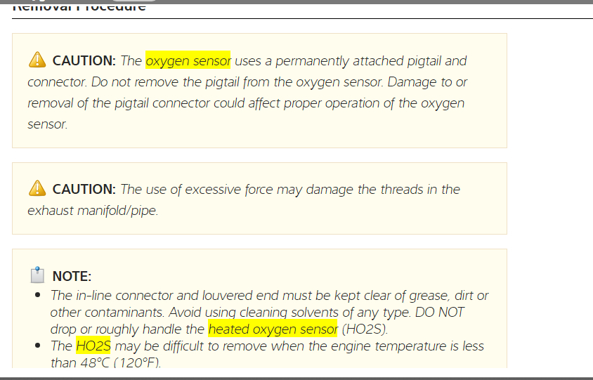

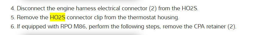

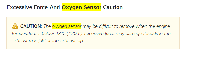

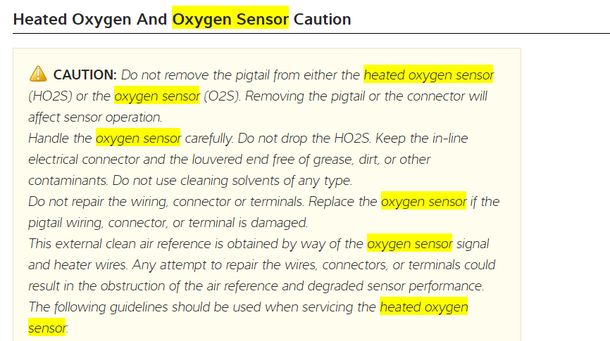

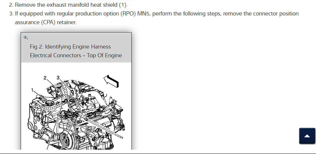

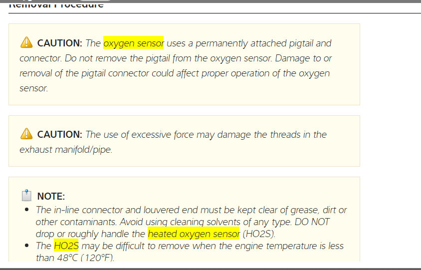

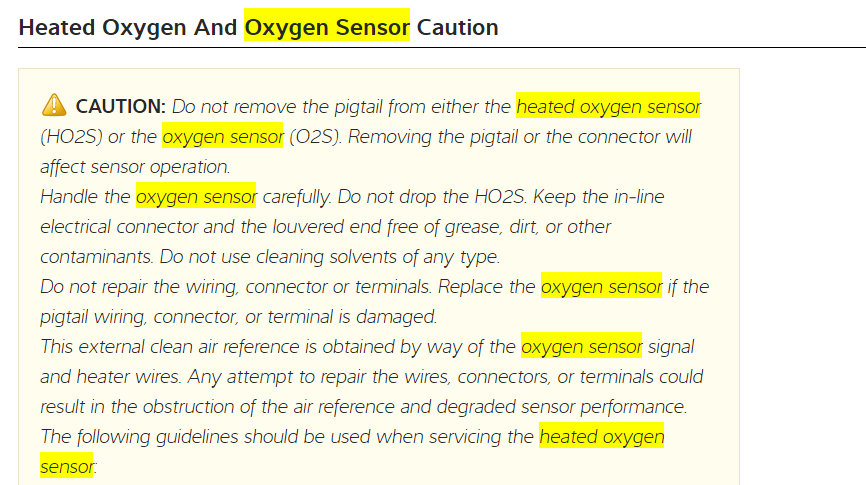

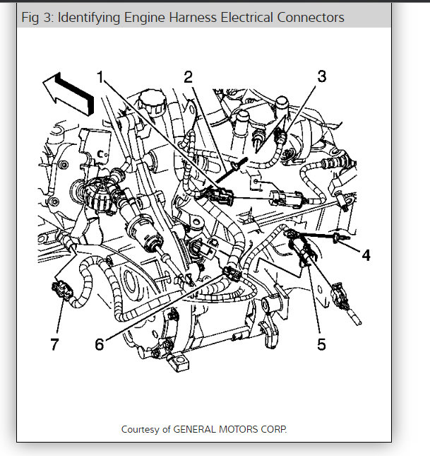

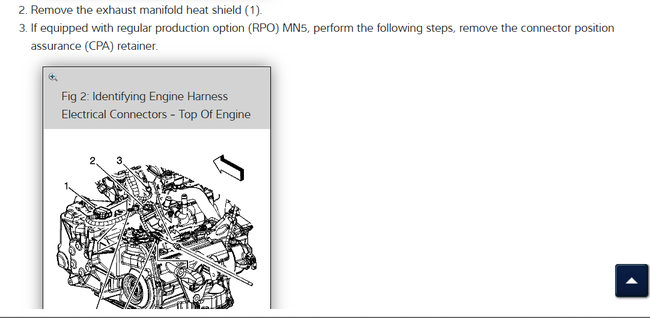

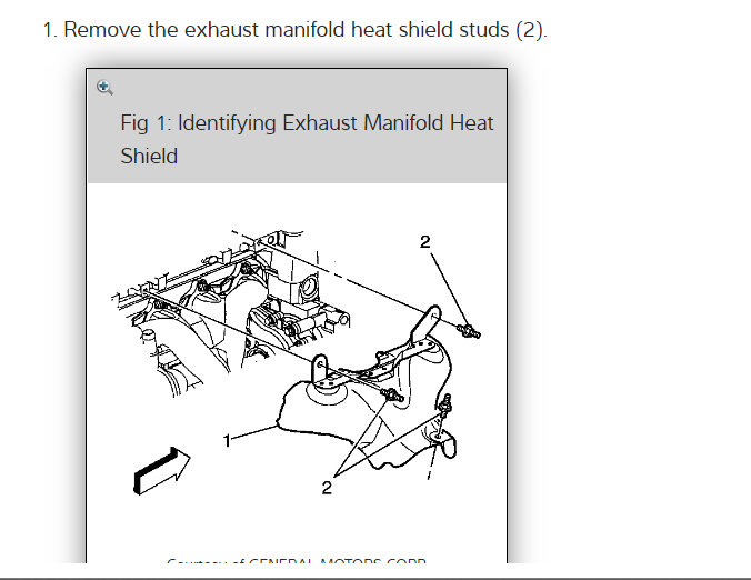

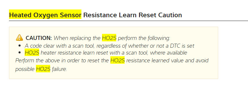

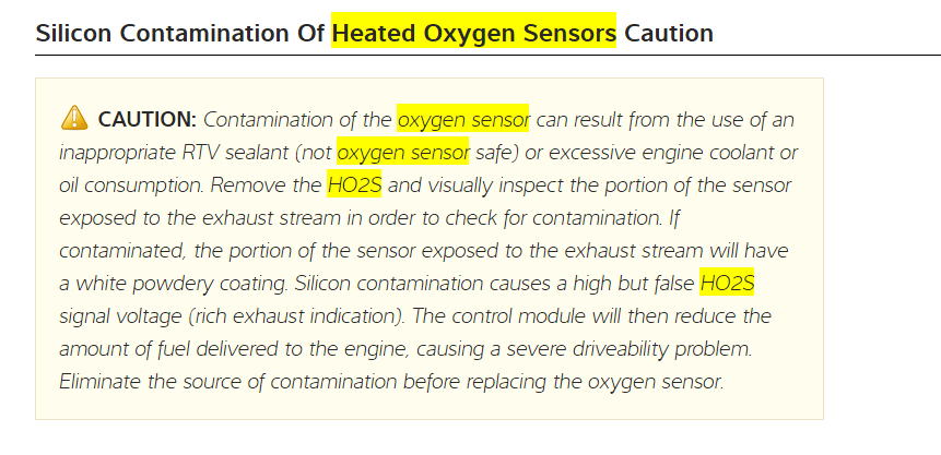

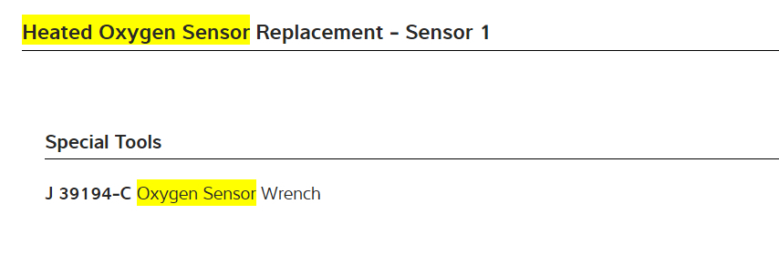

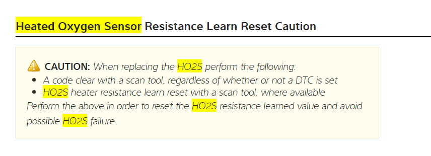

I have included in the diagrams down below the factory guide for the removal of the HO2S1 sensor from your vehicle. The installation is the reverse of the removal procedure. Please go through this guide and get back to us with how everything turns out.
Thanks,
Alex
