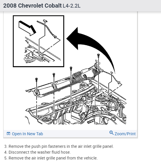

Just need to know how to take off the windshield wipers to get the old plastic portion off I have the replacement.

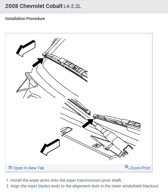

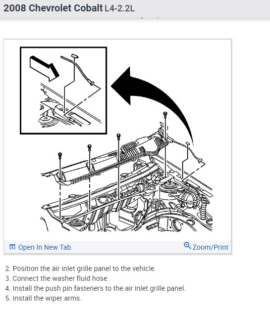

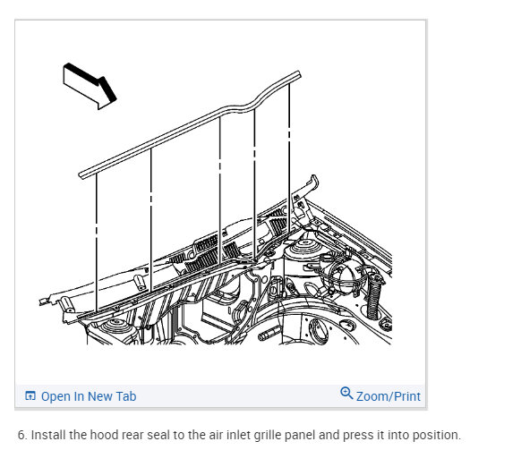

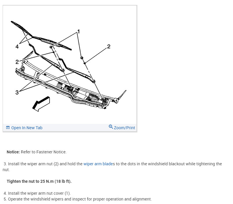

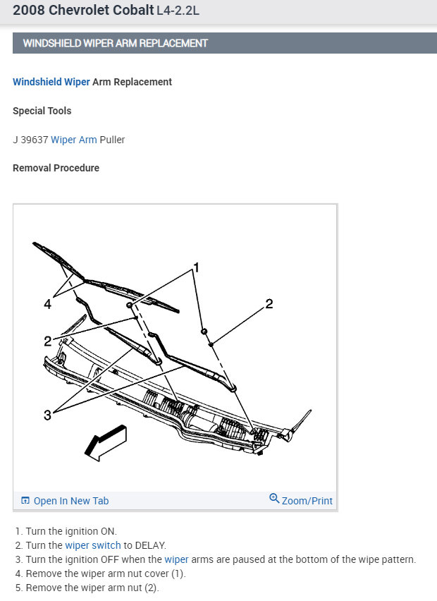

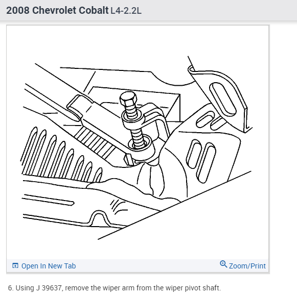

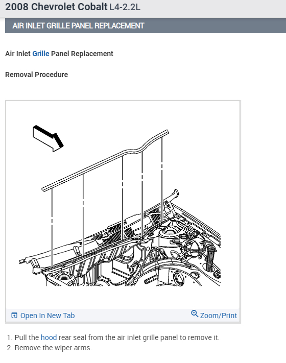

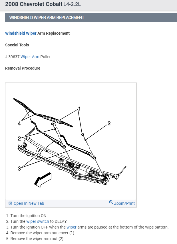

The wiper arms are pressed on the shaft and will need to be pulled off using a special tool.

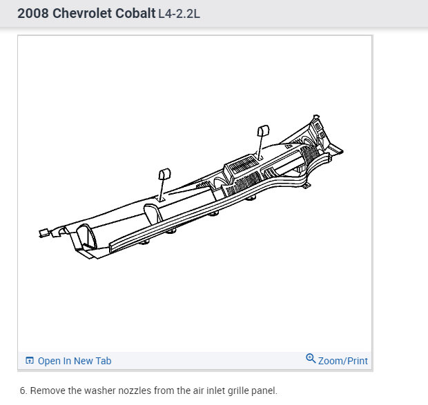

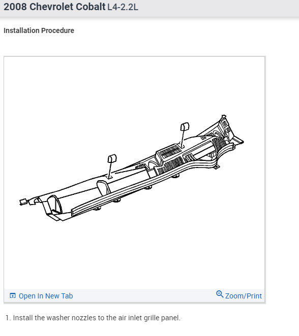

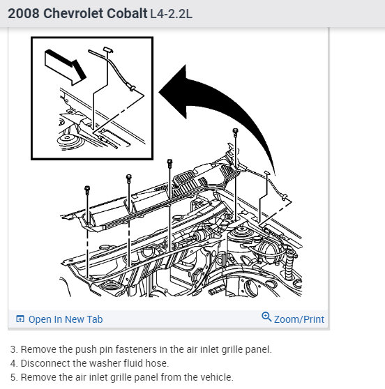

After the arms are removed, the plastic piece (cowl) can be removed by taking off the fasteners.

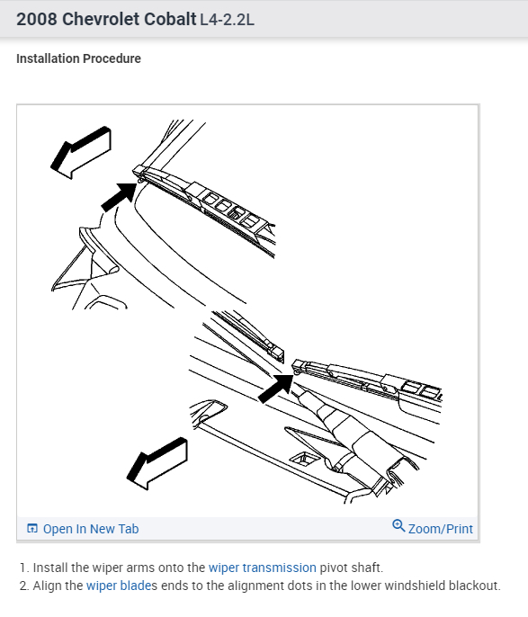

I have attached the wiper arm and the cowl removal and installation procedures below.
Let me know of any questions.
