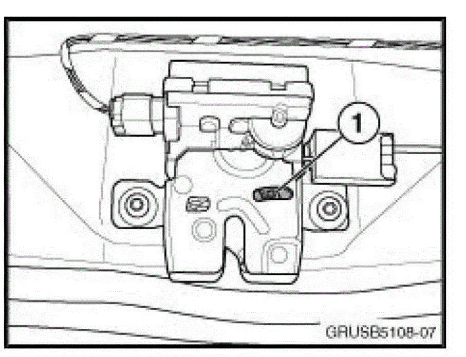

pic 1
3. Remove the lodged black plastic ball from the area around the release lever (1).
4. [NEW] Replace the emergency release Bowden cable per repair instruction RA 51 24 065.

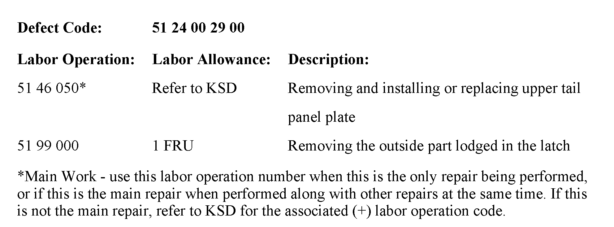

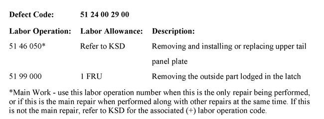

pic 2

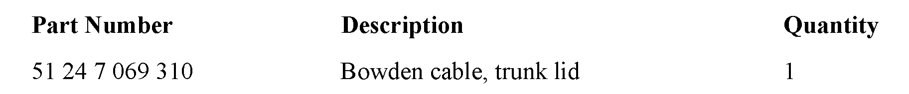

PARTS INFORMATION
pic 3
WARRANTY INFORMATION
Covered under the terms of the MINI New Vehicle Limited Warranty.

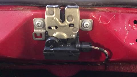

No mine latches but keeps unlatching randomly, sometimes it keeps doing it sometimes doesn't.
Mar 23, 2020 at 11:24 AM
NASER NASER
  • 836 POSTS
No it still did it even with the piece away from the latch.
Mar 23, 2020 at 11:32 AM
I hope you are doing well. As far as the issue, for it to unlatch at random times, there must me some shorting to power. Take your test light and see if you start moving wiring around if you get hits of power.
Mar 23, 2020 at 11:47 AM
NASER NASER
  • 836 POSTS
you mean hits of power to any of the wires just by moving them? isn't some of them supposed to have some power already even when the latch is open or closed?
Mar 23, 2020 at 12:08 PM
I looked through the schematic, and to the best of my knowledge, power should only be sent to the latch when requested.
Mar 23, 2020 at 12:59 PM
NASER NASER
  • 836 POSTS
Took off the above tag latch trim and disconnected the button and it stopped doing it, still opens with remote.
Mar 23, 2020 at 1:19 PM
Something is shorted to power. Chances are the switch is bad.
