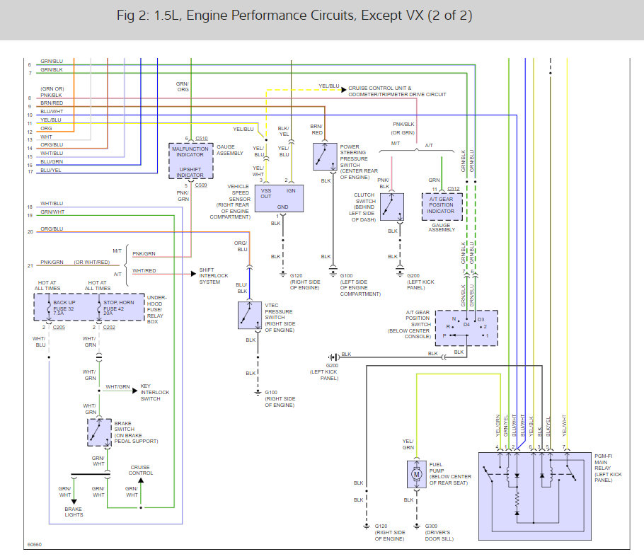

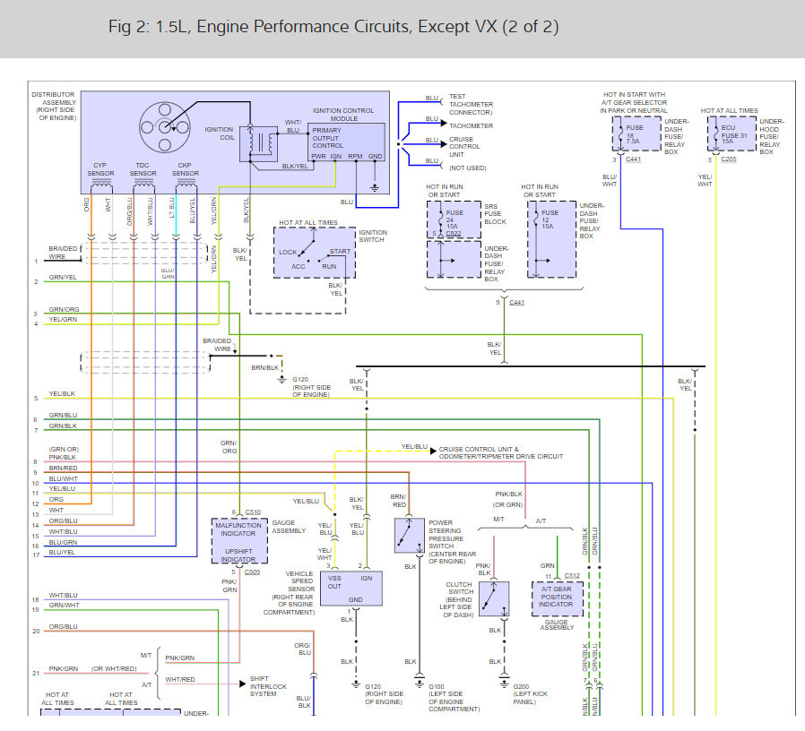

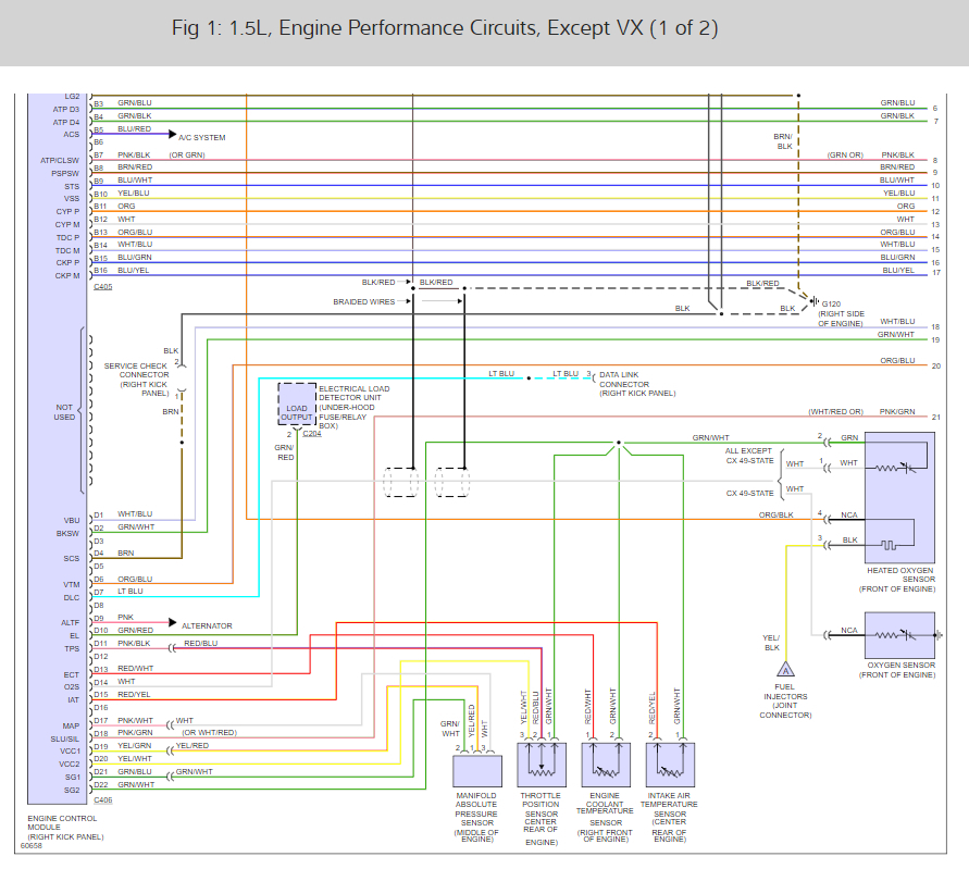

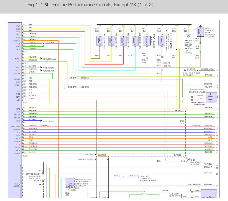

Hello, this sounds like you have a bad ground or power feed to the computer or the computer is bad. So to be sure lets use this guide and the engine wiring diagrams below to help you see how the system works and to see which wires to test.
The PCM is behind the right kick panel.
Check out the diagrams (below). Please run this test and get back to us.

I read what you sent, and studied the diagrams. The Haynes manual has the same ones. Just not in color. I am not sure if you meant to follow the test for a cam angle sensor or to "figure out" which sensor to test on my own. My 1993 Civic has a distributor with a built in crank sensor, but I do not think it has a cam angle sensor. The crank sensor has battery voltage.

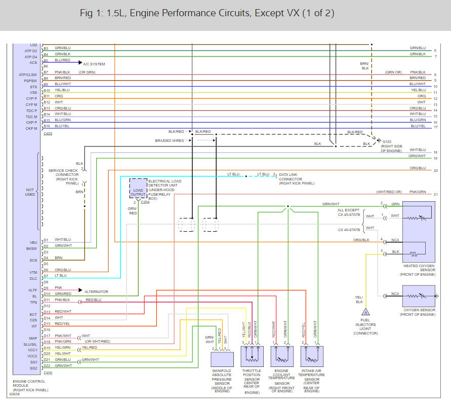

I checked all of the ECM harness pins for voltage. The ones that should have power, do have power with the ignition switch on. I think. I do not know which one is supposed to have battery voltage with ignition switch on.
I have battery voltage at pgmfi main relay on pins #1, 3,5,8,. And pin#6 while cranking.

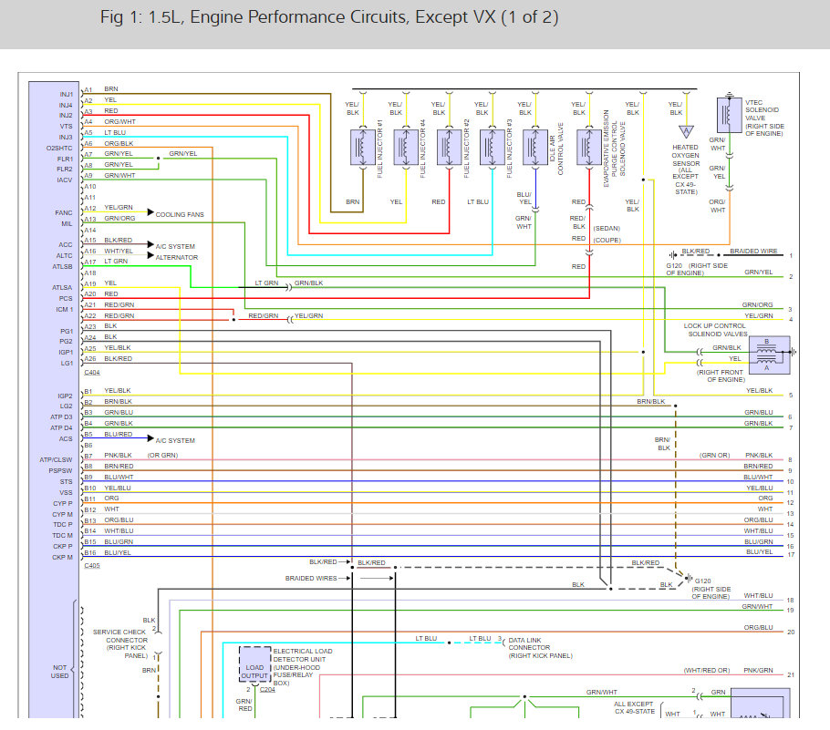

I did continuity tests from pgmfi main relay pin #2 to ECM harness pin #A23. (Ground) infinite resistance.
Continuity test from pgmfi main relay pin #3 to ECM harness pin #A25 & B1. Infinite resistance. A25 and B1 have battery voltage.
Continuity test from main relay pin #8 to ECM pin #A7 & A8. Infinite resistance.
A7 and A8 do not have battery voltage at ECM harness, with ignition switch in on position. But pin #8 at pgmfi main relay does have battery voltage, ignition switch on. Is that normal?
I checked all four fuel injector harness plugs for voltage. The yellow/black wires at injector plugs have 12 volts, ignition switch on.
The other wires at fuel injector harness plugs have 0.02 volts, ignition switch on. The fuel injector harness plugs are getting 12 volts now without jumpering the pgmfi main relay. They weren't getting voltage before without jumper wiring main relay.

I also did continuity tests from fuel injector harness wires to ECM harness. All were infinite resistance.

Here are the ECM harness pin voltage records, ignition switch on. The battery was at 11.78 volts when I did these checks. I have since charged it.
A1, brown, fuel injector #1, 11.78 volts.
A2, yel, inj#4, 11.77 volts.
A3, red, inj#2, 11.77 volts.
A4, not used, no wire.
A5, lt blu, inj#3, 11.76 volts.
A6, org/blk, O2 sensor,11.76
A7, grn/yel, pin 8 at main relay, NO POWER
A8, grn/yel, pin8 main relay, NO POWER.
A9, grn/wht, EACV solenoid, 11.76 volts.
A10, not used
A11 not used
A12, yel/grn, radiator fan relay UH fuse box, 11.76
A13, grn/org, check engine indicator inst cluster, 11.68
A14, not used
A15, blk/red, AC comp clutch relay, 11.73
A16,white, alternator,11.75 hot all the time, switch OFF
A17,lt grn, lock up control solenoid, NO POWER.
A18, not used
A19,yel, lock up control solenoid, NO POWER
A20,red, purge control solenoid, 11.78
A21, IGP1,red/grn, dist ignition input signal, 11.38
A22,IGP2, red/grn,dist ign input signal, 11.38
A23,blk, pin#2 MainRelay grnd, NO POWER
A24,blk, VSS, NO POWER
A25,yel/blk, main relay pin #3, 11.77
A26,blk/red, data link groundH, NO POWER
B1,yel/blk, Main Relay pin #3,
11.78 volts
B2, org/blk, grnd H,
NO POWER
B3, green, shift position indicator inst cluster, 10.66
B4,grn/blk, shift posItion indicator inst cluster,
NO POWER
B5,blu/red,AC pressure switch, 11.49
B6, not used
B7,green, shift position indicator imst cluster
NO POWER
B8,brown, power sterring pressure switch,NO POWER
B9,blu/wht, Main Relay pin #6, fuse #18, NO POWER
B10,ye/grn, VSS, 4.9 volts
B11,orange, distributor CYL sensor,NO POWER
B12,white, dist CYL sensor,
NO POWER
B13,org/grn, dist TDC sensor
NO POWER
B14,wht/blu, dist TDC sensor
NO POWER
B15, blu, dist CRANK sensor,
NO POWER
B16, blu/yel, CRANK sensor
NO POWER
D1,wht/blu, fuse #32 UH fuse box, hot at all times,
11.90 volts
D2,grn/wht, NO POWER
D3, not used
D4,brown, service conn, ABS control, NO POWER
D5 not used
D6, book says goes to oil pressure switch B, but the pin is empty on my harness
D7,lt blu, data link conn,
NO POWER
D8, not used
D9, pink, Alternator,
NO POWER
D10,grn/ref,ELD Unit UH fuse box, NO POWER
D11,pnk/blk, TPS,NO POWER
D12, not used
D13,red/wht,coolant temp sensor, NO POWER
D14,white, O2sensor,
NO POWER
D15,red/yel, IAT sensor,
NO POWER
D16, not used
D17,pnk/wht,MAP sensor
NO POWER
D18,wht/red, gear shift interlock control unit 3.19volts
D19yel/grn, MAP sensor
NO POWER
D20,yel/wht, TPS,
NO POWER
D21,blue, MAP sensor,
NO POWER
D22,grn/wht, coolant temp,IAT,service conn, O2 sensor, no power
I have no idea if my findings are "normal". I hope this helps you in determining where to go next.

Update: I grounded ECM pin A7 with a straight pin attached to a length of wire. I stuck it into wire entry side of ECM harness. Ignition switch on, fuel pump came on but CEL did not go off. Engine did not run.
I also hooked a test light to battery (+) and touched the wires (not the yellow/black ones) at the unplugged fuel injector plugs. Ignition switch on. The test light faintly lit up at each injector plug.
I can make the fuel pump come on by jumper wiring the main relay pins, or grounding A7 at the ECM, but the CEL does not go off and the engine does not run.

I just read on the internet that the pgmfi main relay pin #8 is supposed to be grounded by the ECM. The ECM is also supposed to supply 12 volts (battery voltage) to pin #8 while cranking. My main relay pin #8 has 0.75 volt with ignition switch "on", and 0.75 volt while cranking. I hope this info helps you help me.
I will check the ECM pins that pertain to grounding for continuity ASAP.

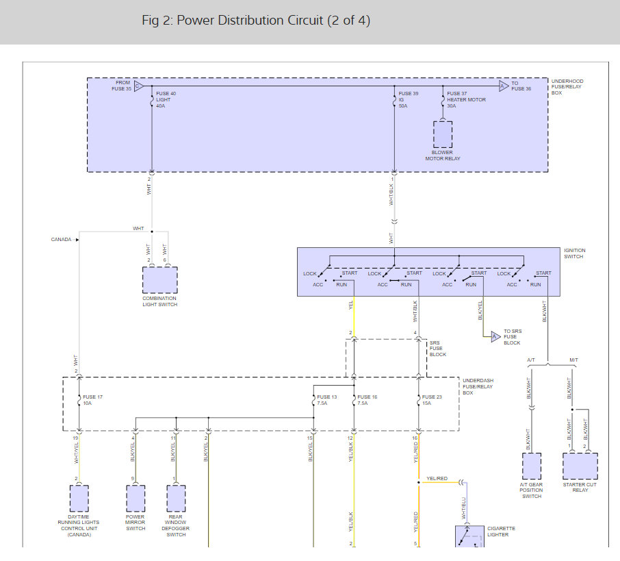

Oh ya, we can get you fixed up. The voltage while cranking is low. I am wondering if the battery is good. Here is a simple test you can do to see if the battery passes:
Also, lets check the ignition switch to make sure it is putting power out like it should. Here is the switch wiring diagrams.

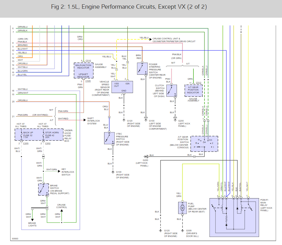

Also, main relay pins #1, 3, 5 have battery voltage. #6 has 8.69 while cranking. #7 should have battery voltage to power the fuel pump. It does not. #8 was the only one that "wrong". 0.75 volts. I read its supposed to have battery voltage when cranking.
Any ideas on that?
Aug 14, 2018 at 6:23 PM
For the fuel pump I see #4 as the fuel pump feed off of the PGMFI relay yellow and green wire correct?
Aug 16, 2018 at 10:46 AM
93 CIVIC DX
  • 22 POSTS
The yellow/green wire connects pin #7 to the fuel pump harness. No #4 pin on 92-95 Civics. #7 is not getting power at the main relay.

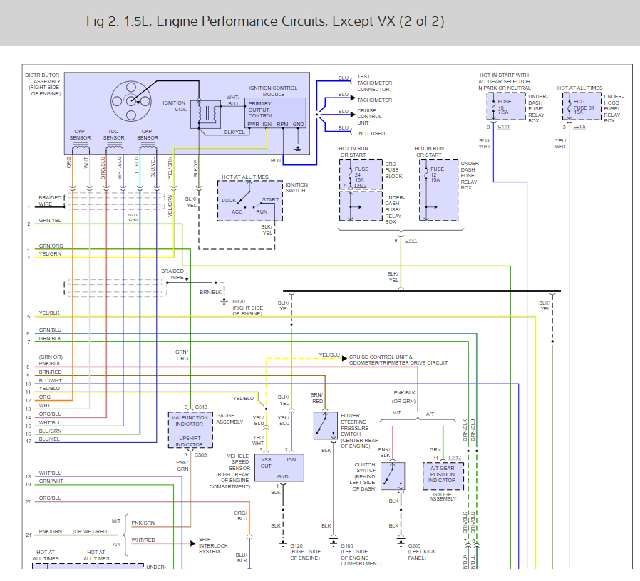

#7 at the PGM FI gets power for the ECU fuse #31. Do you have power there?
Aug 17, 2018 at 10:07 AM
93 CIVIC DX
  • 22 POSTS
Yes, ECU fuse #31 under hood fuse box,15amp, has battery voltage. I checked all the fuses and they were all good. Just as a precaution I changed #31, #24 15amp ACG fuse, & #18 7.5amp, starter signal fuse with known good fuses. They all have battery voltage, switch on. I have battery voltage at main relay pin #s 1,3,5. #7 should get battery voltage from inside the relay. But it does not get power at all unless I jumper wire it from pin #5. Then the fuel pump hums and pumps fuel to the fuel rail. The injectors will not do there thing though. So the engine will not run.

Fuse #31 connects to ECU at D1. It has battery voltage there at all times.
#7 does not have voltage.

#7 goes straight to the fuse panel so I would say that is the issue. Check the wiring diagrams to confirm #7 on the PGMFI

Actually, I think #7 connects directly to the fuel pump harness. I did a continuity check from the main relay harness pin #7 to the fuel pump harness and there was continuity there. (No breaks in the wire.)
