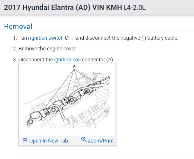

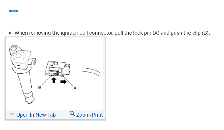

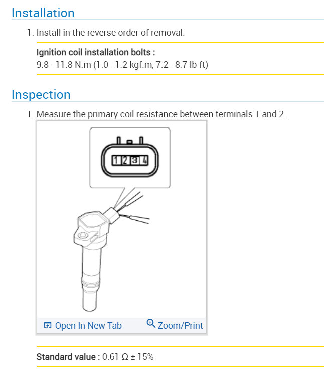

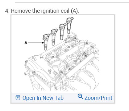

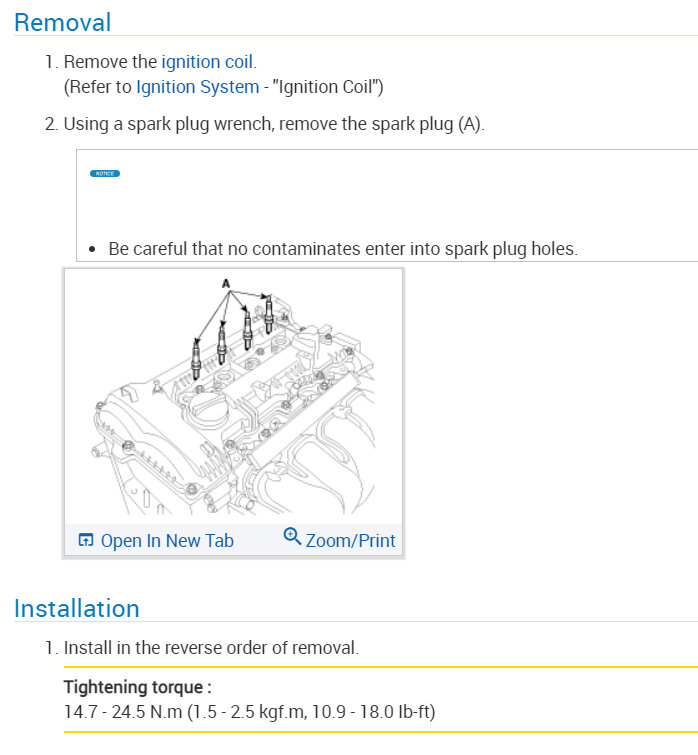

It sounds like they installed the wrong spark plugs or the gap is off. Here is a guide to help you do the job correctly and instructions for your car in the images below.
https://www.2carpros.com/articles/how-to-change-spark-plugs
Spark plug:
Type ELR9IQP9+
Gap 0.8 - 0.9 mm (0.0314 - 0.0354 in.)
Check out the images (below). Please let us know if you need anything else to get the problem fixed.
