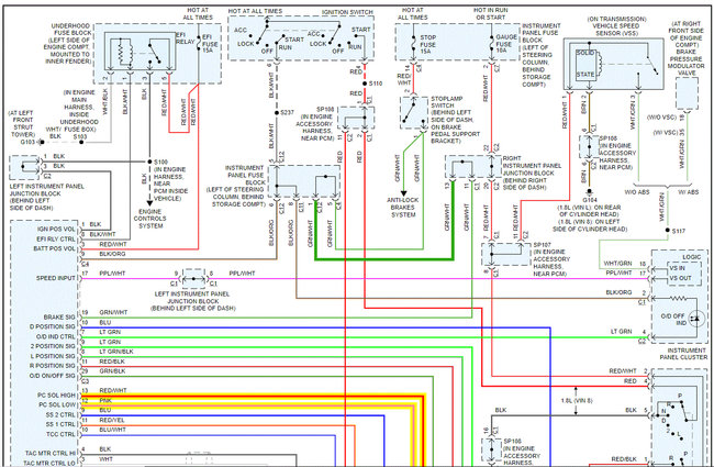

Good evening, the vehicle is experiencing harsh shift while changing gears. I have scanned the vehicle the codes found on it memory is P2716 . How will I know the exact solenoid and what else should be checked for?

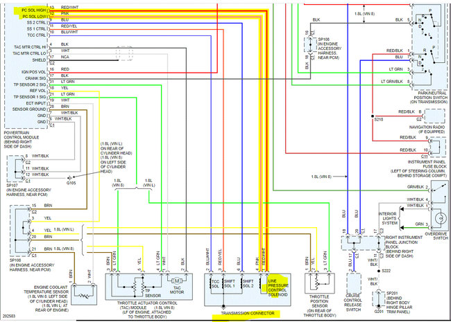

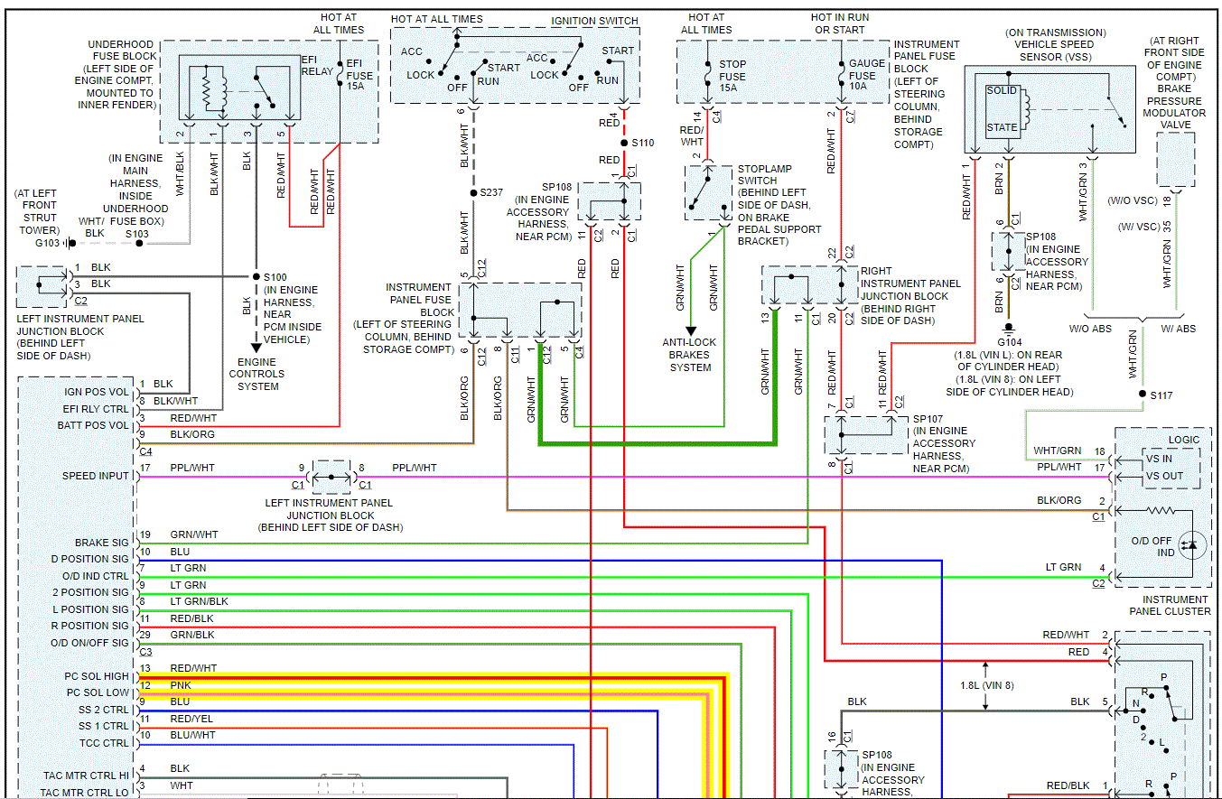

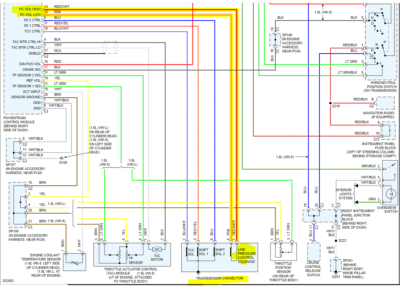

I don't know if you could also help me with the circuit diagram, from the PCM to the solenoid.
Aug 30, 2021 at 2:40 PM

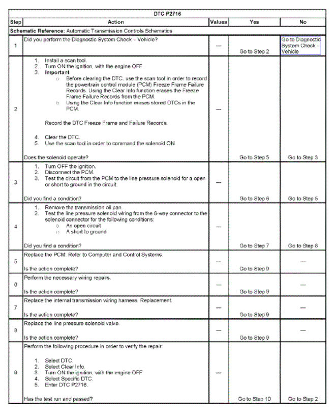

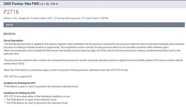

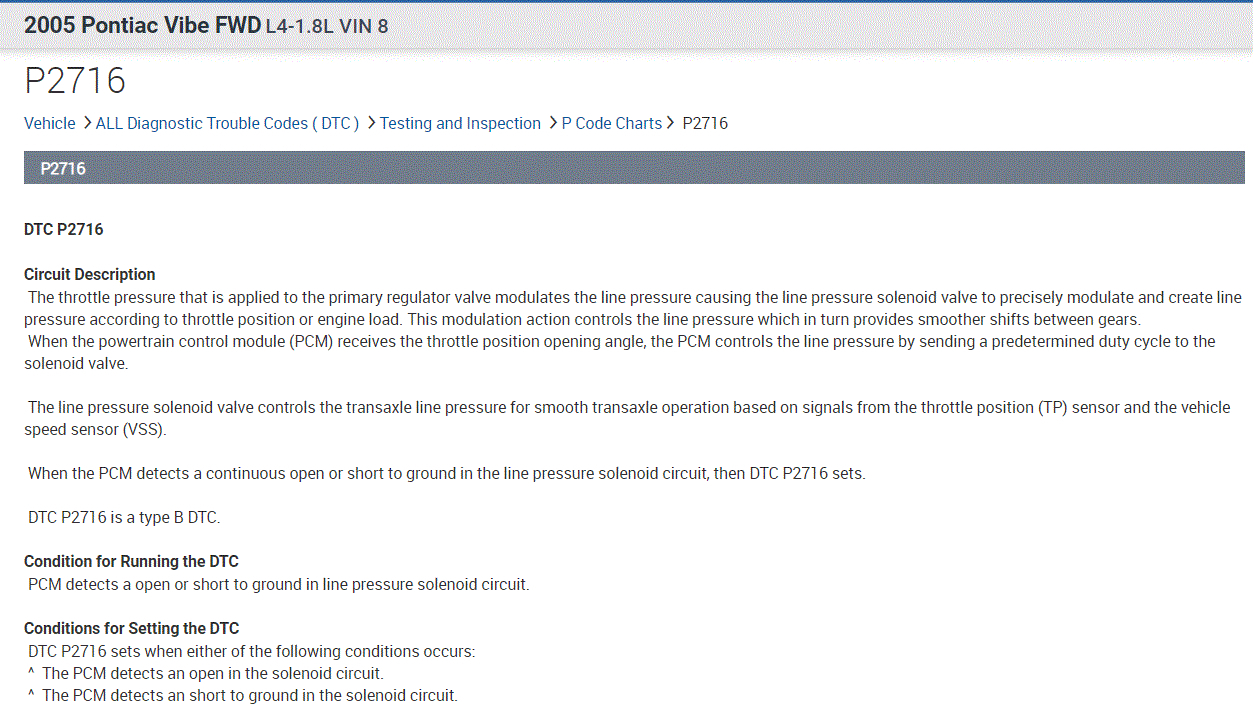

Based on the code and your description, there is either an open circuit or short to ground in the line pressure control circuit. The line pressure solenoid valve controls the transaxle line pressure for smooth transaxle operation based on signals from the throttle position (TP) sensor and the vehicle speed sensor (VSS). If the shift is harsh, the pressure is likely too high.
If you look at the first two pics below, I provided the wiring schematic. It was a page long, but I had to cut it in half to make it readable for you. I did overlap them and highlighted the wires related to the solenoid and where they connect at the PCM.

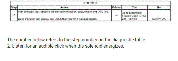

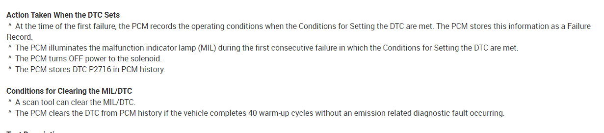

The remaining pics are the diagnostics related to the code you provided. Take a look through them and let me know if you are comfortable doing them.

It has been fixed, one of the wires had open circuit. Thank you
