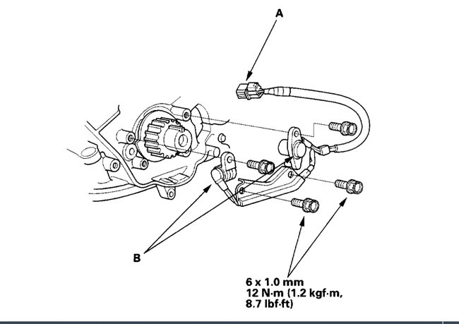

I have a feeling it is related to the crankshaft position sensor. There is a chance it was damaged or disconnected. If you take a look at pic 1, it shows what I'm referring to. It is located behind the crank pulley which fell off. Check it first.
To help confirm that it is likely this sensor, see if there is spark to the plugs. If the sensor is bad, there won't be spark. Here is a link that explains how to check for spark:

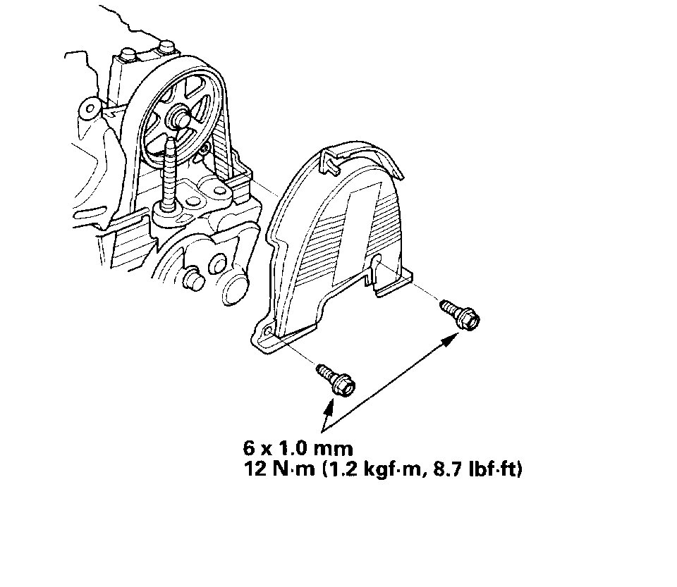

Okay, I've got everything off now and I'm sure you know I had to take off the balance belt to get to the sensor. My next question is, do I have to remove the timing belt and line everything back up with it also or just that belt?
Dec 29, 2020 at 5:27 PM
I need to confirm the engine size. Is it the 2.3L SOHC? If it is the aforementioned engine, the balance shaft belt needs to be removed. Here are the directions. This would actually be a good time to replace the timing belt. Here are the directions for both. The attached pics correlate with the directions.

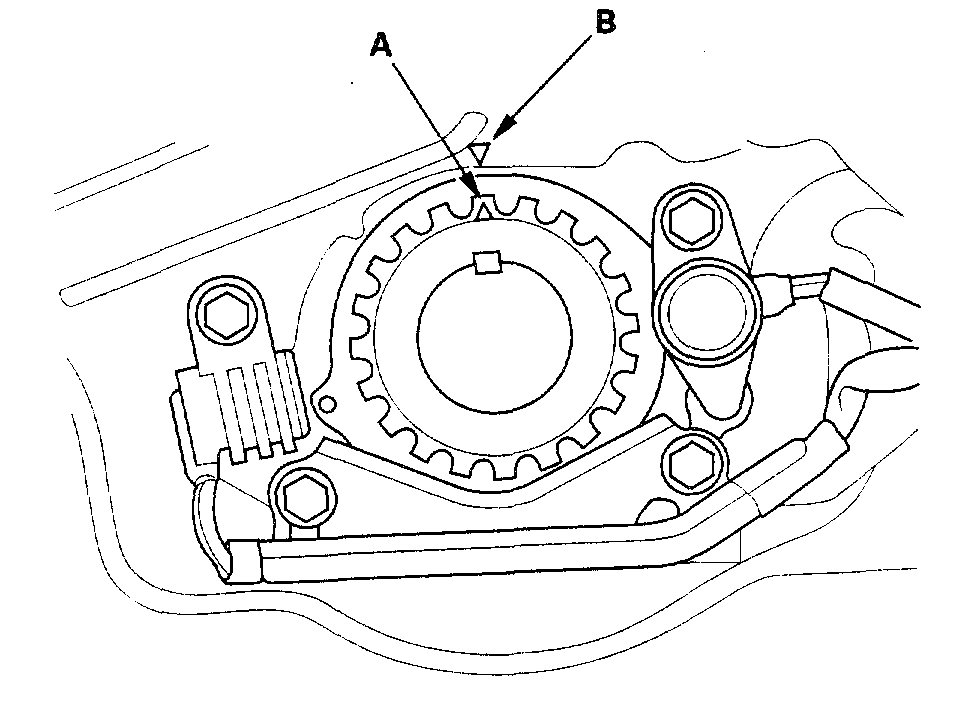

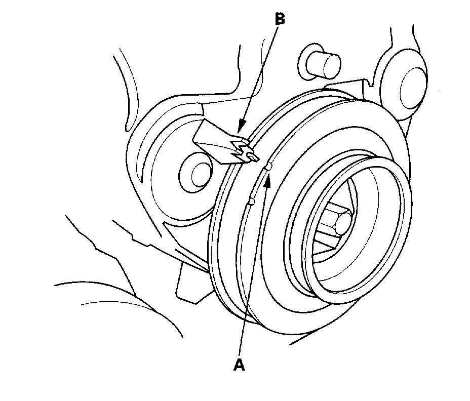

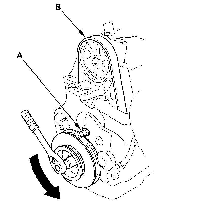

3. Turn the crankshaft pulley so its TDC mark (A) lines up with the pointer (B).

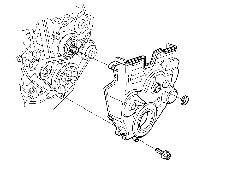

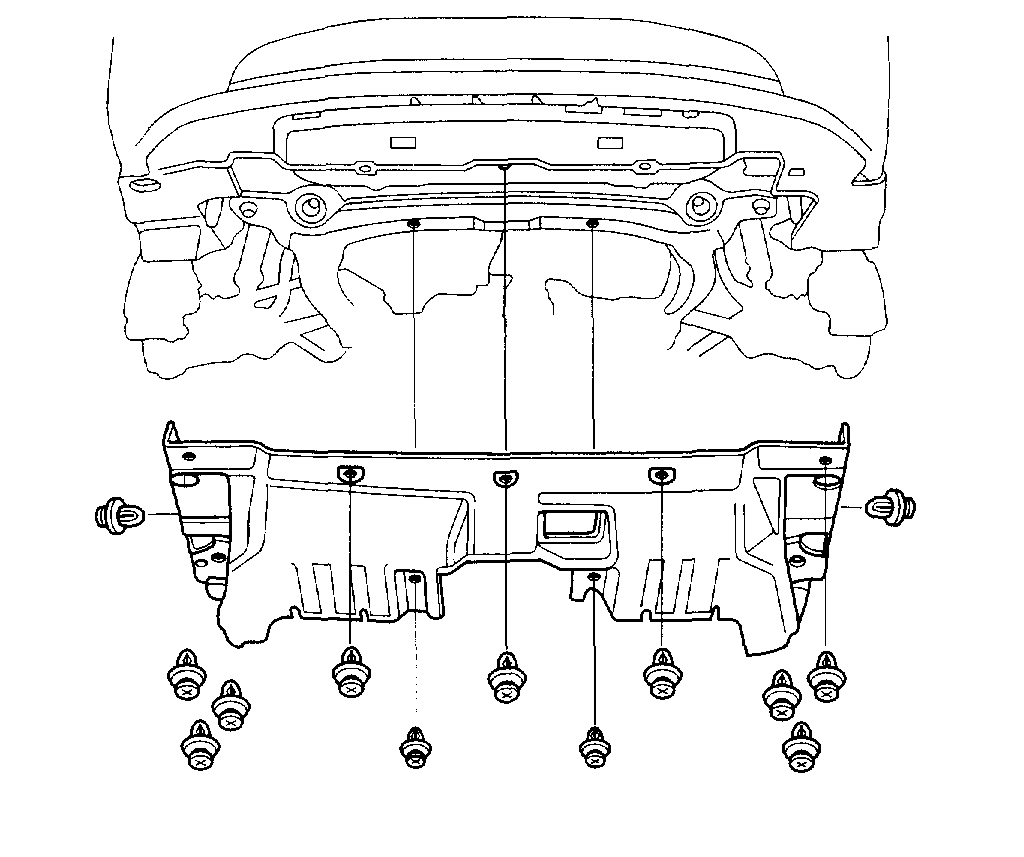

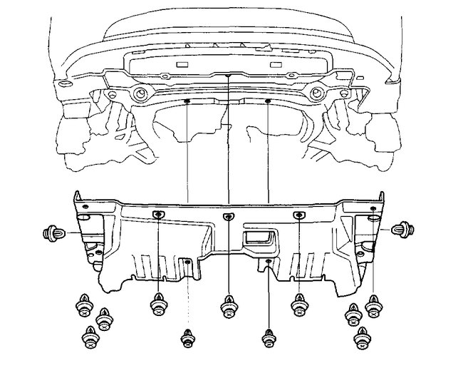

5. Remove the splash shield.

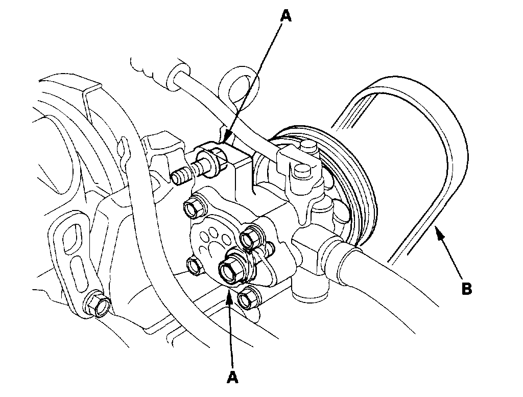

6. Loosen the mounting bolts (A), then remove the P/S belt (B).

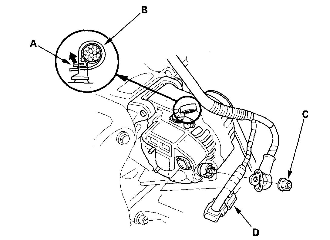

7. Disconnect the alternator wire harness.
^ 1 Pull up the lock (A), then release the wire harness tie (B).
^ 2 Pull back the boot and remove the 6 mm nut (c).
^ 3 Disconnect the connector (D) from the alternator.

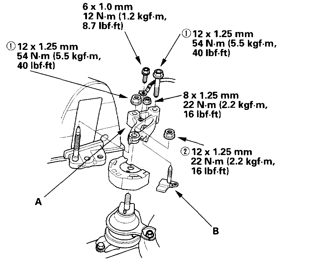

10. Support the engine with a jack and wood block under the oil pan.
pic 5

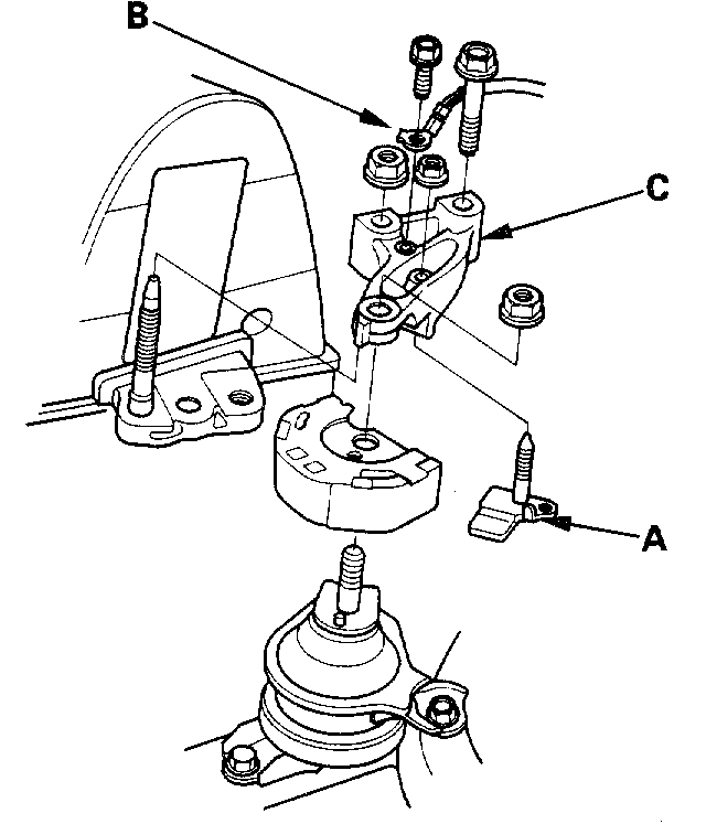

11. Remove the stopper (A) and ground cable (B), then remove the upper bracket (C).

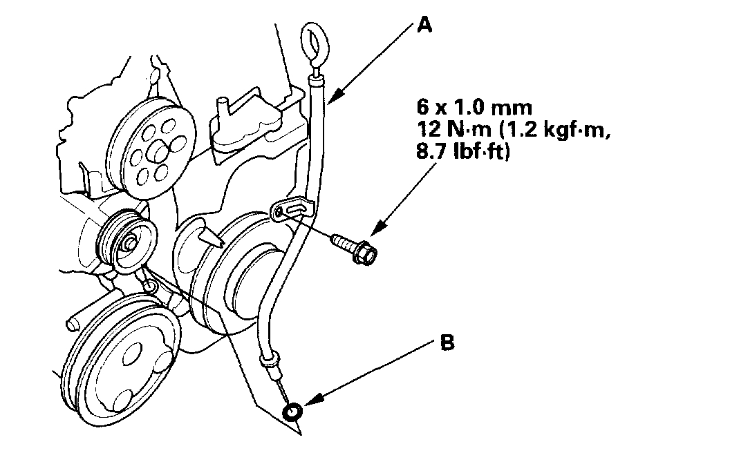

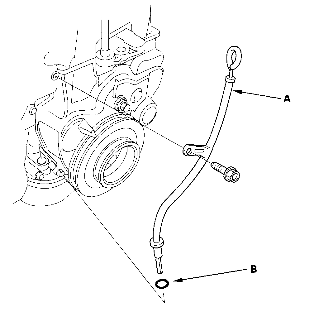

14. Remove the dipstick and tube (A). Discard the O-ring (B).

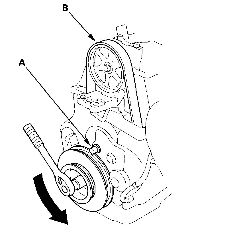

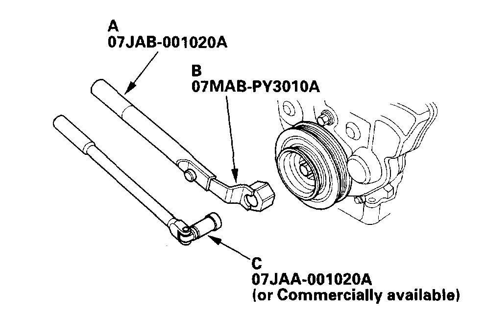

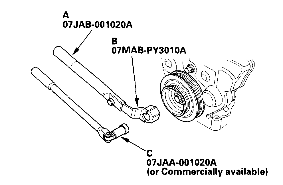

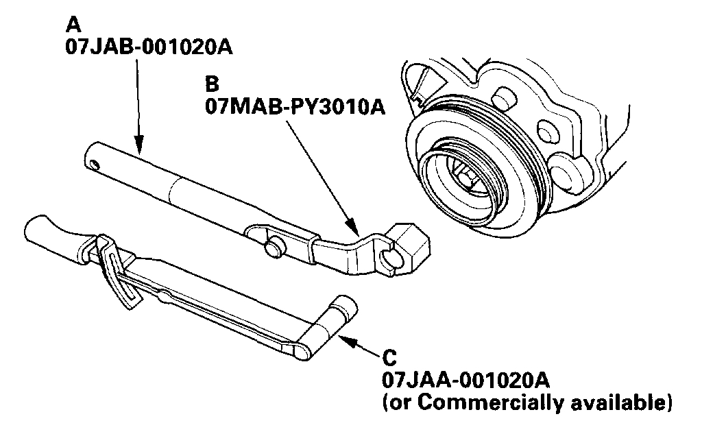

15. Hold the pulley with holder handle (A) and holder attachment (B).
16. Remove the bolt with a heavy duty 19 mm socket (c) and breaker bar.

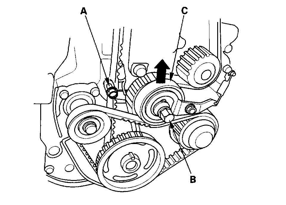

19. Release tension from the balancer belt:
^ 1 Install a 6 mm bolt (A)(from the timing cover) through the hole in the end of the timing belt adjuster arm to temporarily lock the arm in place.
^ 2 Loosen the adjusting nut (B) 2/3 - 1 turn.
^ 3 Push the tensioner (c) up to take tension off the balancer belt.
^ 4 Retighten the adjusting nut (B).

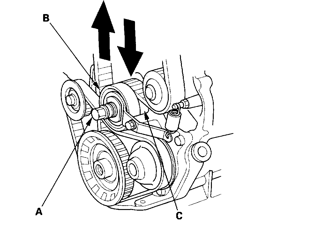

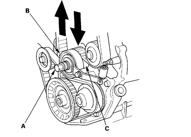

20. Release tension from the balancer belt and the timing belt:
^ 1 Loosen the adjusting nut (A) 2/3 - 1 turn.
^ 2 Push the balancer belt tensioner (B) up to take tension off the balancer belt.
^ 3 Push the timing belt tensioner (c) down to take tension off the timing belt.
^ 4 Retighten the adjusting nut (A).

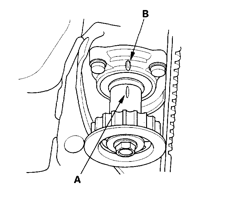

3. Set the crankshaft to TDC. Align the dimple (A) on the tooth of the timing belt drive pulley with the pointer (B) on the oil pump.
pic 13

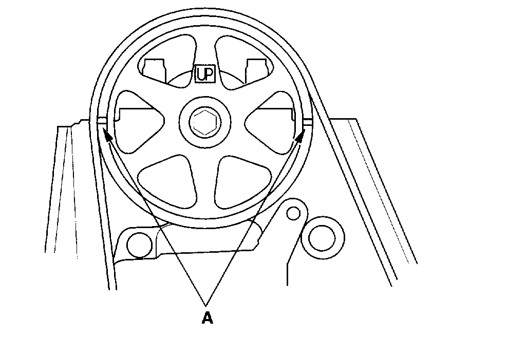

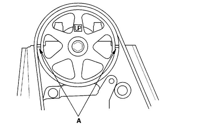

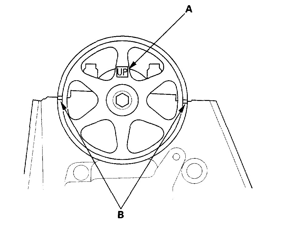

4. Clean the camshaft pulley and set it to TDC.
^ 1 The "UP" mark (A) on the camshaft pulley should be at the top.
^ 2 Align the TDC grooves (B) on the pulley with the too edge of the head.

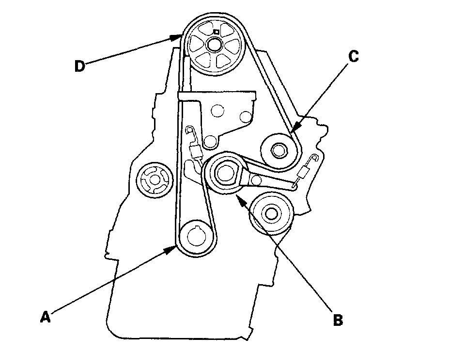

5. Install the timing belt in a counterclockwise sequence, starting with the drive pulley.
^ 1 Drive pulley (A).
^ 2 Tensioner pulley (B).
^ 3 Water pump pulley (C).
^ 4 Camshaft Pulley (D).

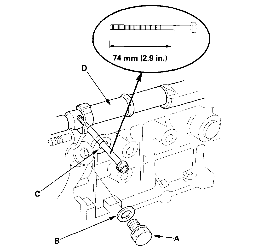

19. Align the rear balancer shaft pulley with a 6 x 100 mm bolt (or equivalent).
^ 1 Remove the bolt (A) and washer (B) from the maintenance hole (C).
^ 2 Scribe a line on a 6 x 100 mm bolt, 74 mm (2.9 inch) from the end.
^ 3 Insert the bolt in the maintenance hole and into the hole in the balancer shaft (D) up to the line you scribed.
pic 19

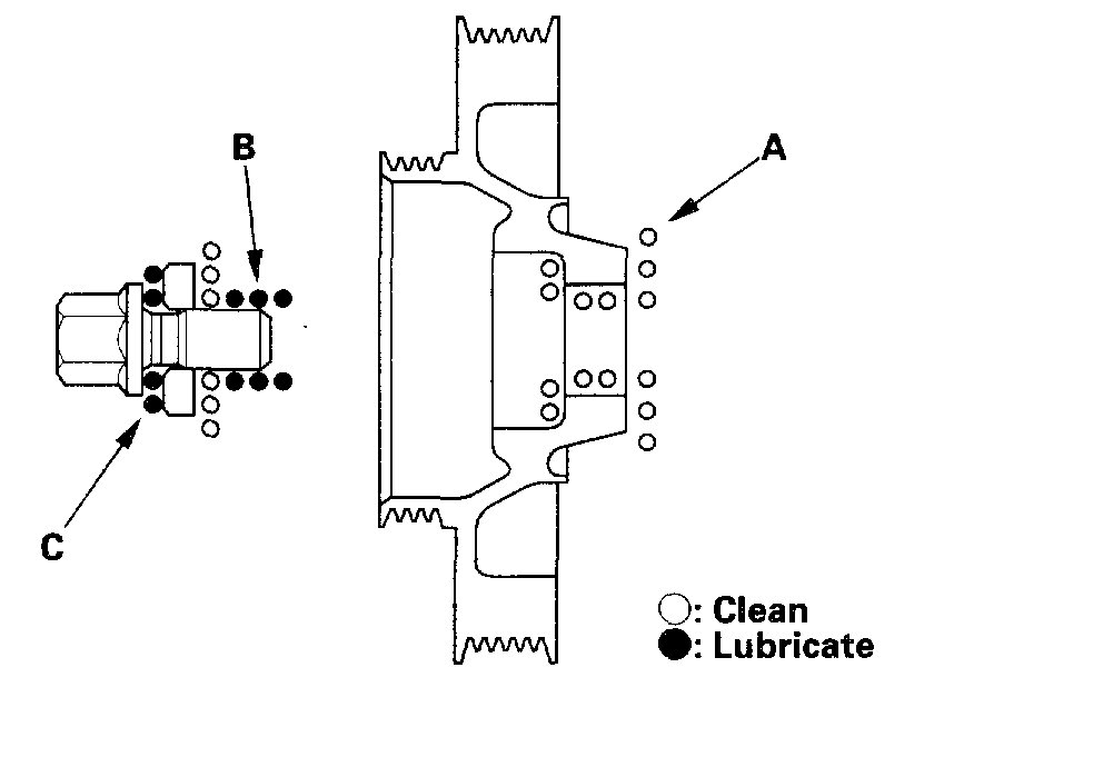

28. Clean the crankshaft pulley bolt and washer.
pic 20
29. Clean all oil off the inside face (A) of the crankshaft pulley, and apply lubricant to the pulley bolt (B) and washer (C).
pic 21
30. Install the crankshaft pulley, and hold with holder handle (a) and holder attachment (B).

Hi, it's a 2.3 4 cylinder I'm not sure about the sohc it's not my car and I'm not crazy knowledgeable. I'm more of a YouTube guy that didn't want to spend big money on smaller jobs that I could handle. I've done water pumps powers steering pumps fuel injectors, front end work etc., but this is my first time with this type of stuff. I've gotten in a little deeper water than I prefer but the more knowledge the better I suppose.
With all that said I've already got the balance belt off to and replaced the crank position sensor. What I need to know is if I have to take the timing belt off and realign everything. I should add i didn't put some lock bolt in that step 19 pic 10 rookie mistake I guess. I asked if he wanted me to pull the timing belt too because the balancer belt was cracking he said no he had it done but I would assume they would have both been changed the same time. I just don't want to destroy his engine.

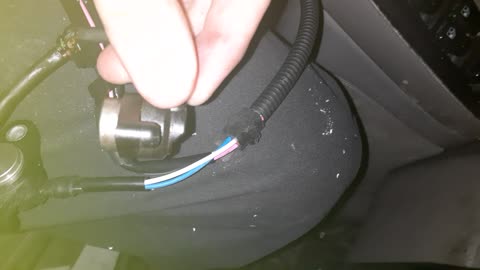

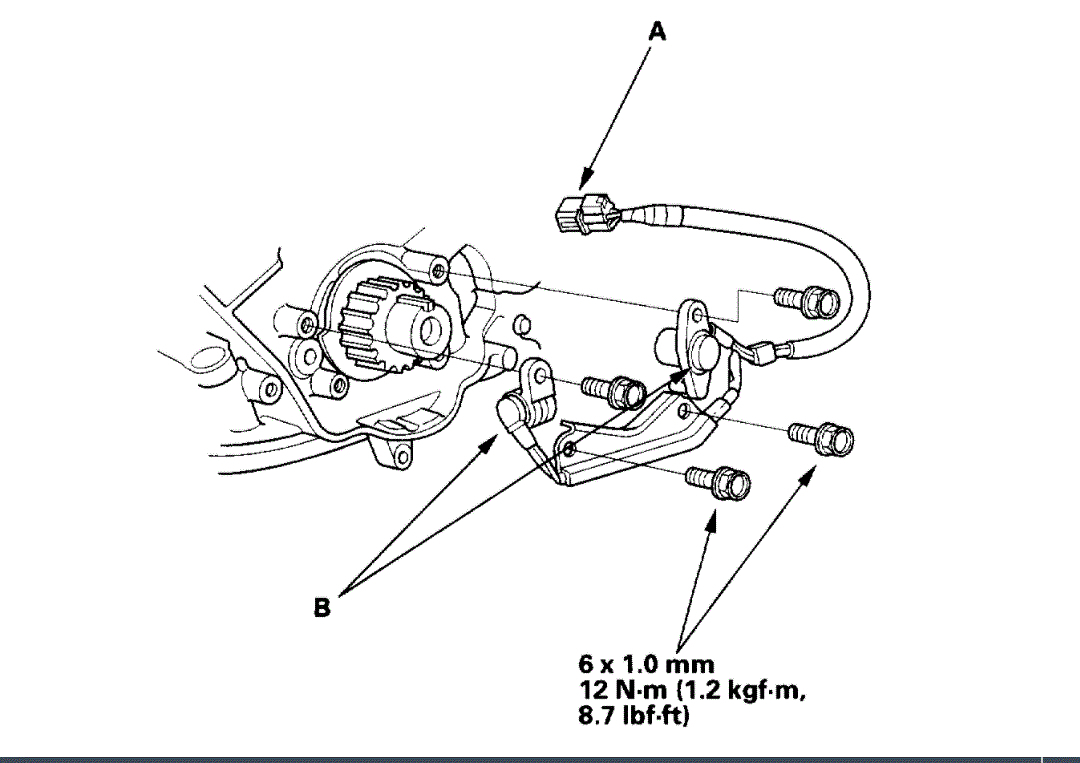

I've also now run into another problem. The sensor that they say is for this car does not match up. The left one plugs in fine but the right one the bolt hole does not line up with how it fits. When it twist it to line the hole it doesn't fit right anymore. Everything looks good by eye but I don't want to crank it down and mess it up.
Jan 3, 2021 at 1:26 PM
Dan,
You will need to do it over. I would suggest putting it back at TDC and confirm the marks for the cam are correct. Now, as far as the sensor, we need to confirm if it is a Vtec engine or not. That is likely what is causing the variation in the crankshaft position sensor. Usually, it will say Vtec on the valve cover or engine cover.
Jan 3, 2021 at 6:40 PM
