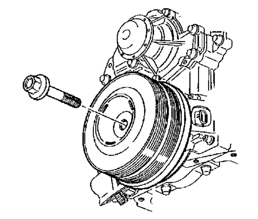

I'm removing a harmonic balancer on the car listed above base model .Do I have to lower the sub frame to get it off or is there a trick?

I attached the procedure and some pictures for the replacement for you.
https://www.2carpros.com/articles/how-a-harmonic-balancer-works
You will need a puller. You can get one at a parts store.
Crankshaft Balancer Replacement
Tools Required

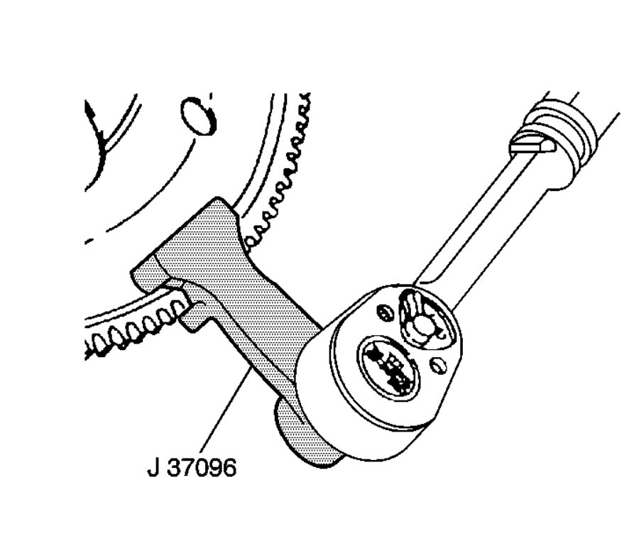

J 37096 Flywheel Holder

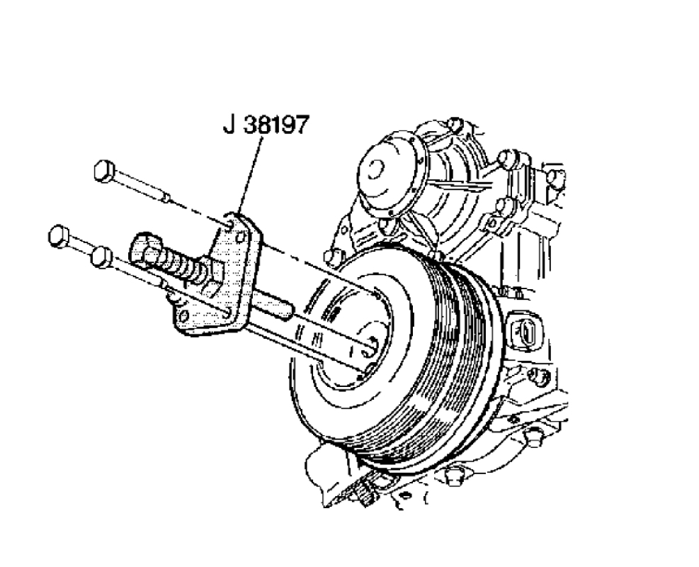

J 38197-A Crankshaft Balancer Remover
J 45059 Electronic Torque Angle Meter
Removal Procedure
1. Disconnect the negative battery cable.
2. Remove the drive belt.
3. Raise and support the vehicle. Refer to Vehicle Lifting.

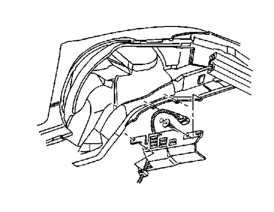

4. Remove the right front tire and wheel.
5. Remove the right engine splash shield retainers and the engine splash shield.
6. Remove the torque converter covers.
7. Use the J 37096 to secure the flywheel in order to prevent the crankshaft from rotating.
8. Remove the crankshaft balancer bolt and discard the balancer bolt.
9. Install the J 38197-A.
Important: Do not separate the crankshaft pulley from the crankshaft balancer. Service the crankshaft pulley and the crankshaft balancer as an assembly.
10. Remove the crankshaft balancer.
11. Remove the J 38197-A.
