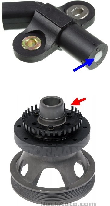

The toothed tone ring for the crankshaft position sensor is on the back side of the vibration damper. When it came loose, the sensor had no teeth and gaps to detect, so it stopped developing signals. To the Engine Computer, the lack of signal pulses means the engine stalled. The computer doesn't know why the engine stalled, but since one possible cause is a fuel line was ruptured in a crash, the computer turns off the fuel pump to stop dumping raw gas on the ground.
By wobbling around, the teeth on the back of the vibration damper likely hit and damaged the crankshaft position sensor. Start by looking at that. This photo shows both parts. The blue arrow shows where the damage will occur to the tip of the sensor. The red arrow is pointing to the teeth that are detected by the sensor. Note there are some uneven gaps between them. Those are how the computer determines which piston is coming up on top dead center.
