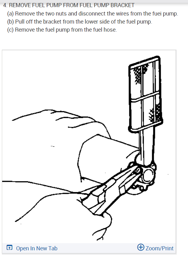

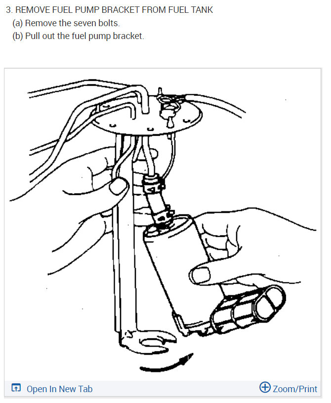

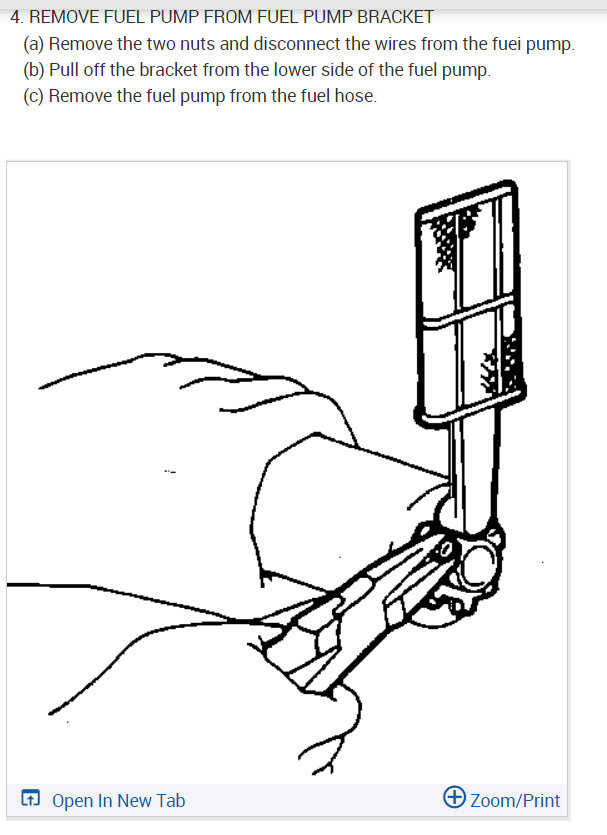

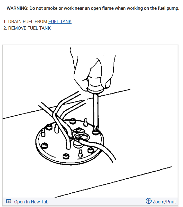

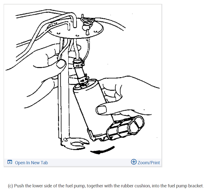

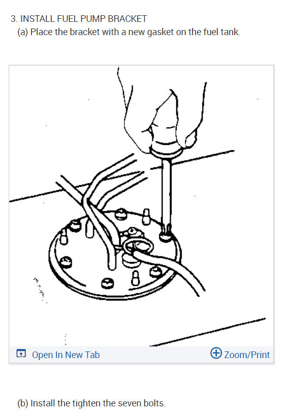

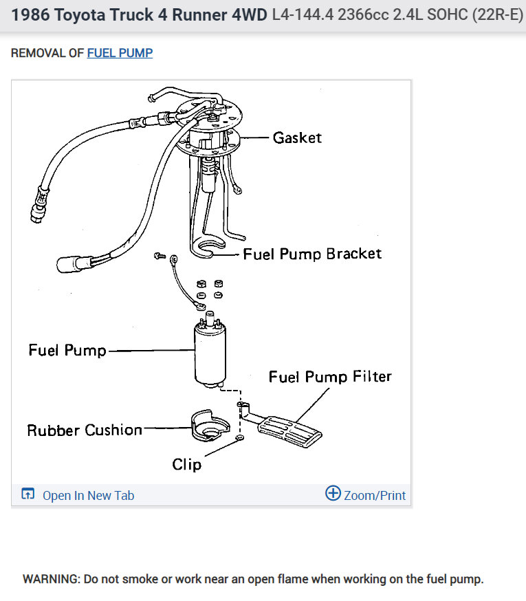

Here is how to change the pump and filter out in case you need it. Check out the images (below). Please let us know what happens.
