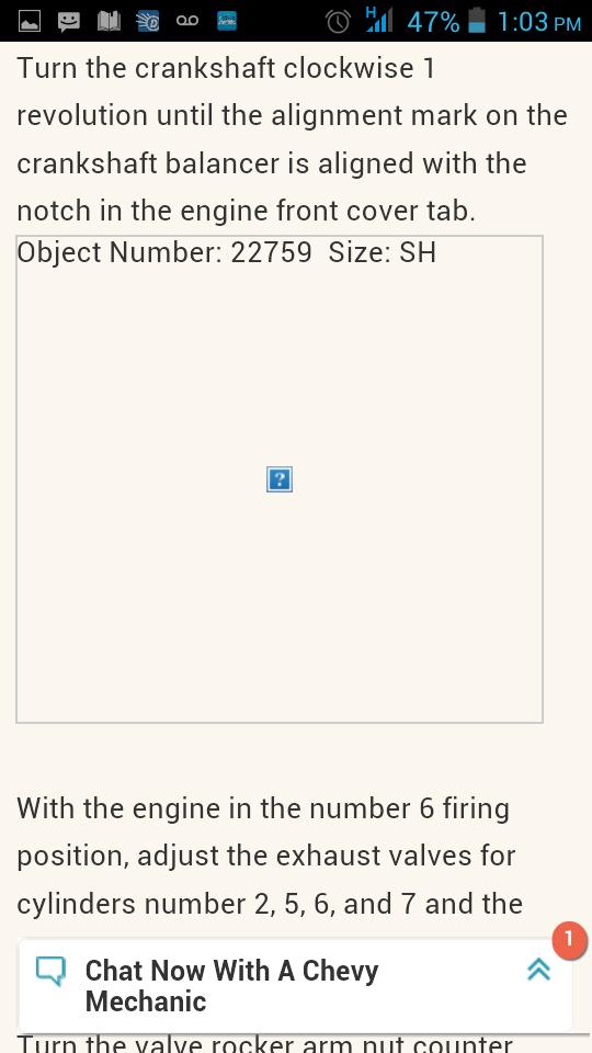

I'm surprised to see such a detailed set of directions. These should be a standard GM cylinder head with a common and simple procedure.
