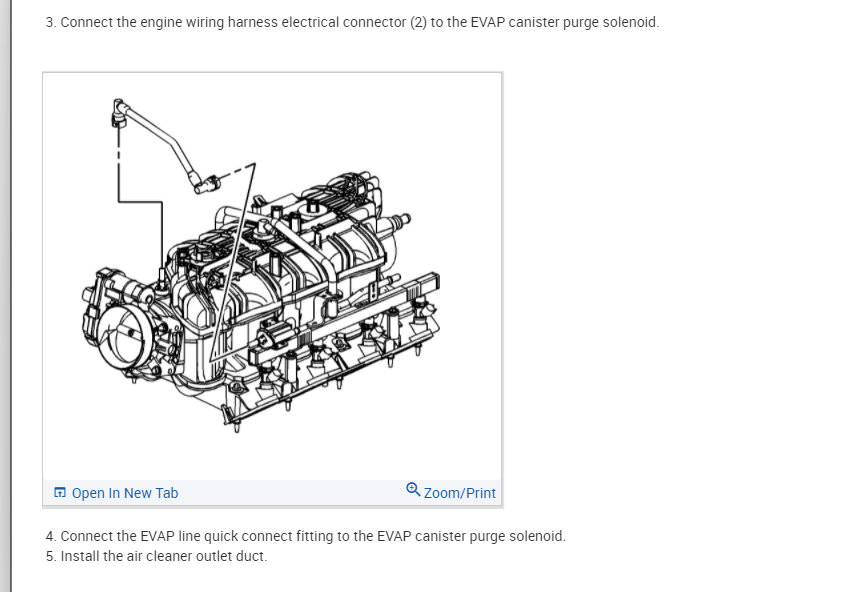

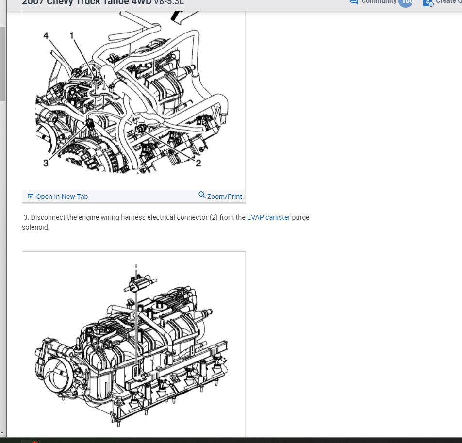

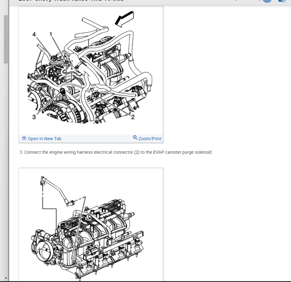

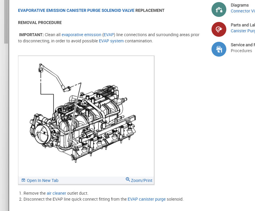

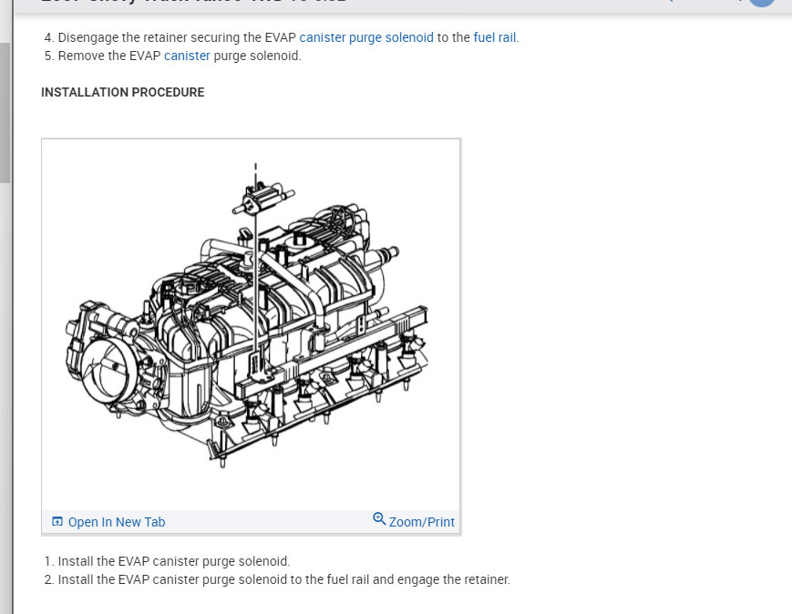

I am attaching the process below on the purge so let's run through this and let me know what questions you have.
