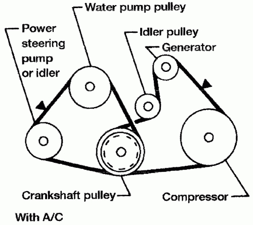

It sounds like a couple different problems. First, the squeal sounds like the serpentine belt is loose. I have attached a picture of the belt. The belt that has a gen in it is the one of question. Make sure it is tight.
