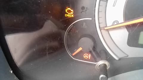

I noticed that the EPS light comes on ignition switch on, but when the car starts the light will shut off but will come back again within minutes or less as I show in the video below.
Please, how do I solve this problem permanently?

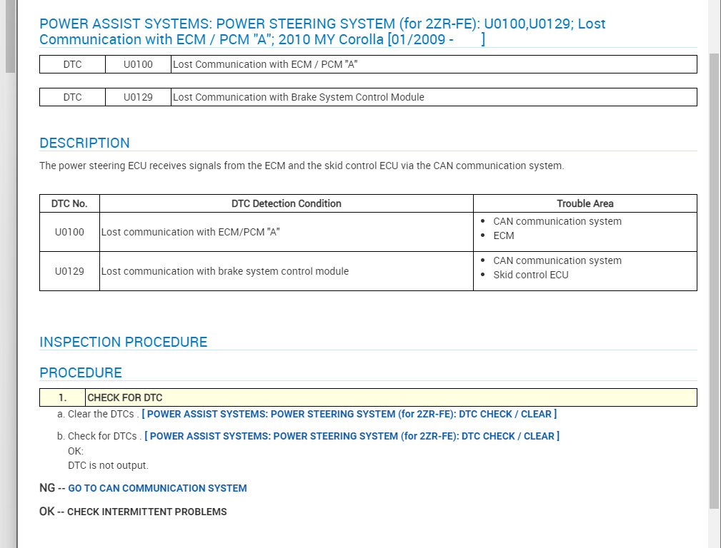

Can you get a picture of this or another video of what is happening when you plug this back in?

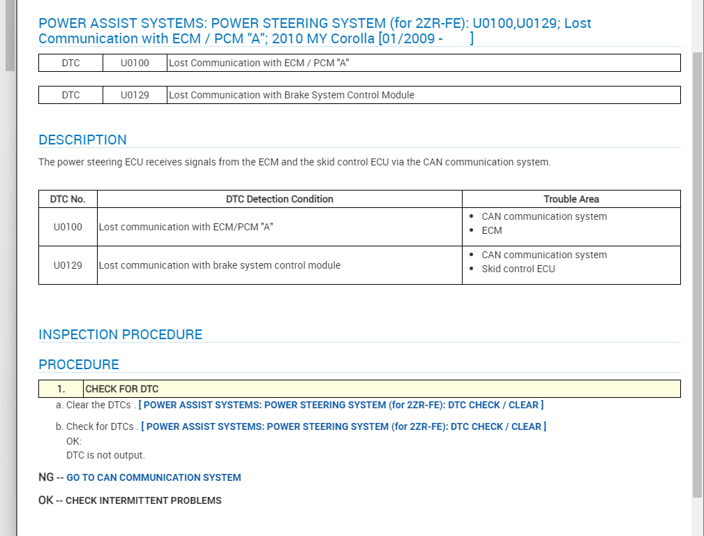

Basically, if there is smoke coming out of anything when you plug it back in then there is a circuit that is shorted, and that component is most likely failed. It may be due to wiring issue or the module itself was shorted.
So, we need to start with finding out what you have with this smoke because I am attaching the info on this U code as that is going to be the cause of your power steering issue.
Lastly the reason you have the light turning on and then off and back on is because when you turn the key on, the cluster does a self-check, and it tests the light. So, it turns it on and off. Then the power steering module reports the code, and the cluster displays the light.

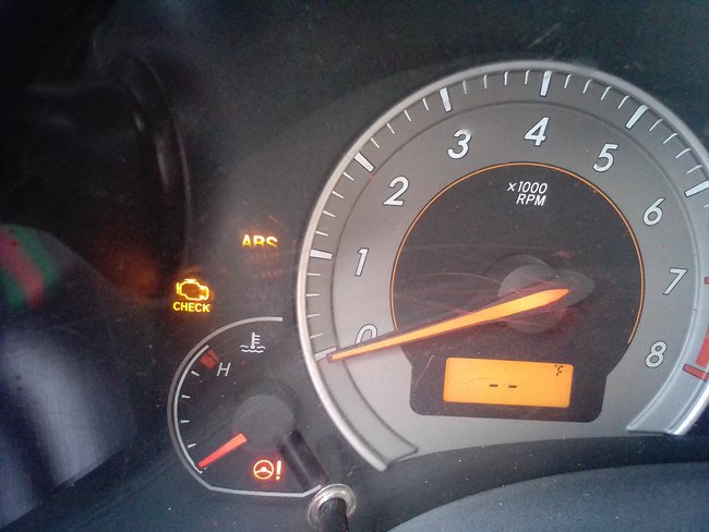

That's another light that I captured- the ABS light. But their major concern was the hard steering wheel.
I also noticed that the deflated tire pressure light was on, on the dashboard.
In addition, I noticed that the dashboard steering wheel light as the mechanic showed me in another Corolla that he was working a different thing on but same model and year, I observed that there was a discrepancy there. In the car I worked on, with a hard steering- the steering wheel light remained on after it started but on the other car that the mechanic was fixing a different issue the steering wheel light went off a few seconds after it started.
He related to me that the steering wheel light should go off after a few seconds when the car starts and idled, and I saw and understood vividly what he was saying.
May 1, 2022 at 4:42 AM
Okay. If the brake module was the one that was releasing smoke, then that would make sense why we have that light on now.
However, we should have some codes directly related to that at this point. If we don't then let's address what we know we have and then any other issue that is not repaired by the steering issue.
Let us know what happens this week and we can go from there. Thanks

I would focus on the U0129 code. Basically, that is telling you that the brake control module is not communicating on the communication network. That is going to cause the power steering motor to stop operating if the communication network is down.
So, if he said there were connector issues or wiring issues then that is what we need to focus on. If everything is connected and the light is on, and the power steering still does not work, then you most likely are going to have a wiring issue or the module has failed.
So, wherever the smoke was coming from is going to need to be replaced.
However, before you replace the module, just test the wiring for shorts to ground.

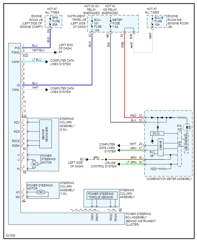

However, the wiring diagram is not fully understood, can you please elaborate more on this also?
May 1, 2022 at 7:03 PM
What about it is not understood and I will see if I can explain it?
In quick summary the electric power steering assembly is shown on the left of the diagram and connected to it is the electric motor which is what gives you the power steering fluid pressure.
So, we need to make sure we have power going to the module and ground. Then if the motor is getting power to turn on.
Basically, I am just supplying it in case we find we have a possible electrical issue.
May 2, 2022 at 6:20 PM
