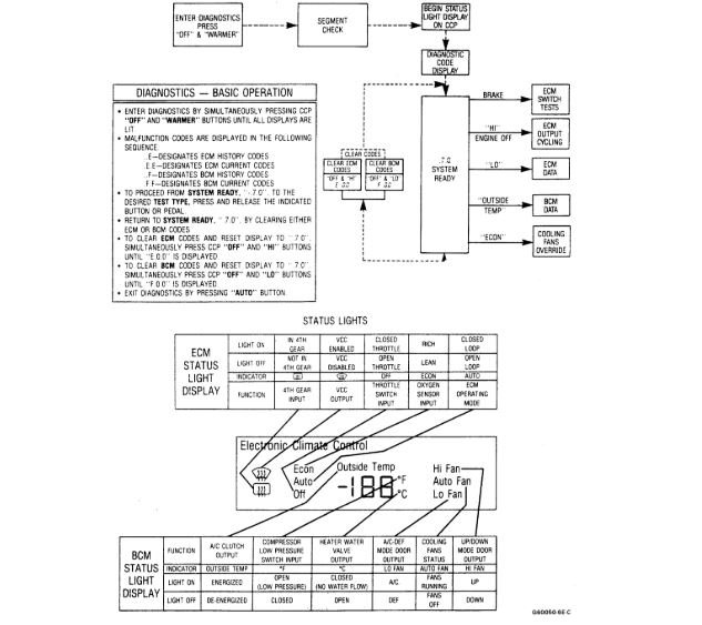

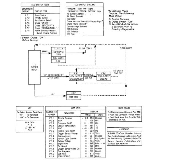

Did you check for any codes on the dash display?
