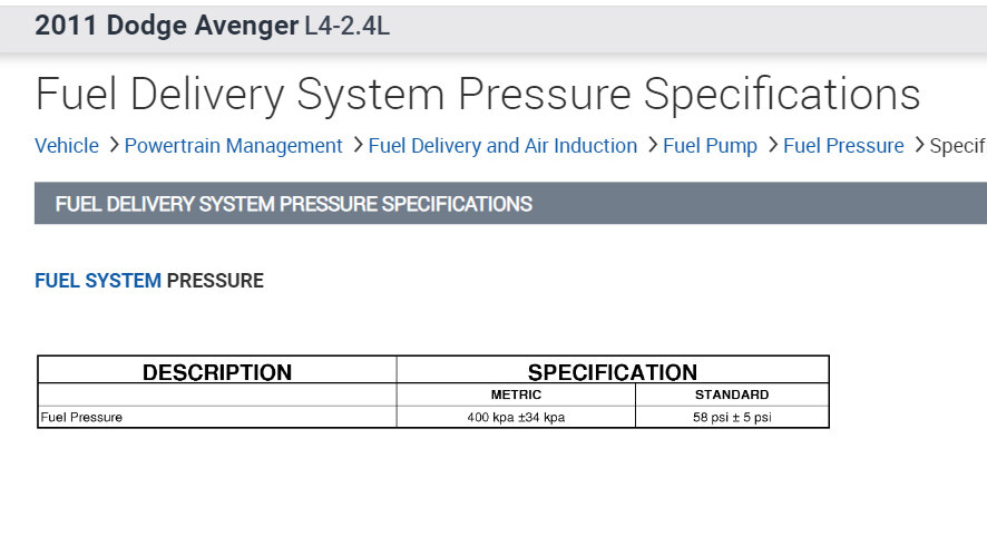

The fuel pressure regulator is located in the fuel tank and is part of the fuel module. You may want to consider checking the fuel pressure to confirm it is within specification.
Here is a link that explains how it's done:
I attached the manufacturer's fuel pressure specifications below. You will need a fuel pressure gauge to perform this, but most parts stores will lend one to you.

See pic below.
