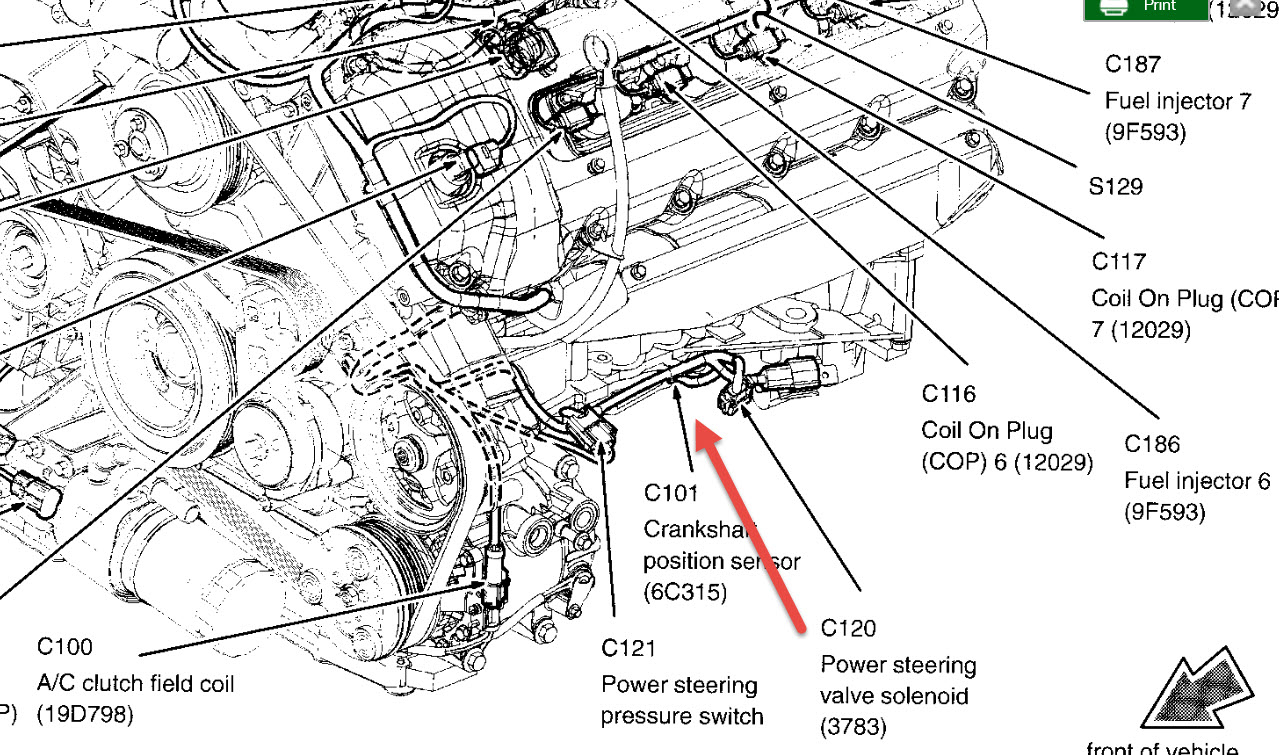

Fuel pressure drops from 45 to 30 psi in five minutes. Where is crankshaft positioning sensor located?

see pic for crank sensor these can go bad and not send a code.
