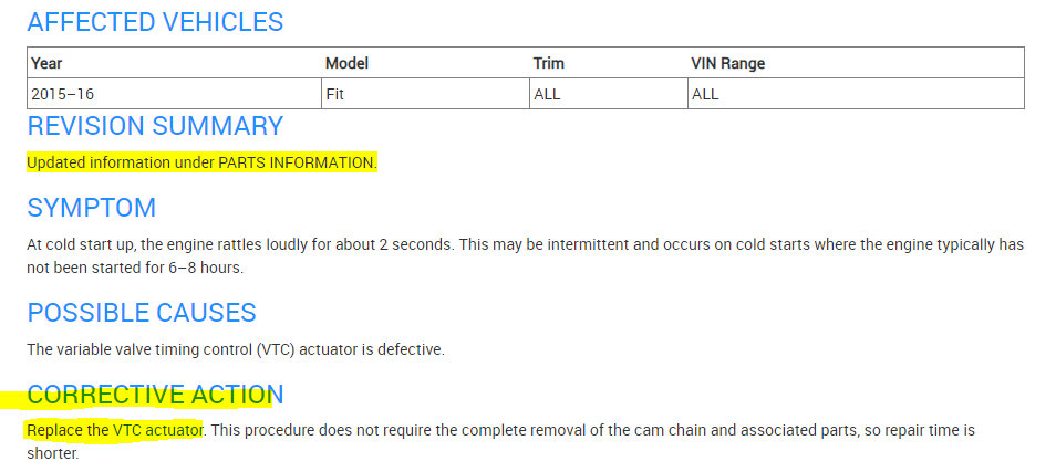

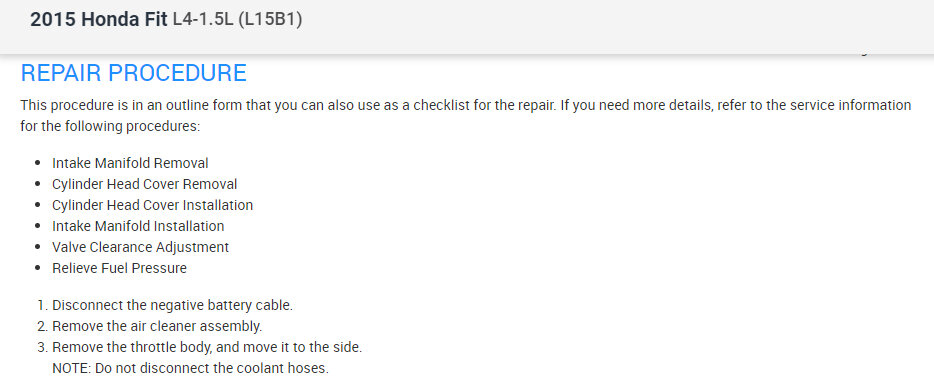

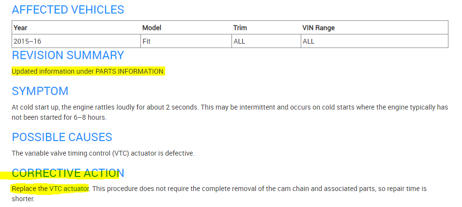

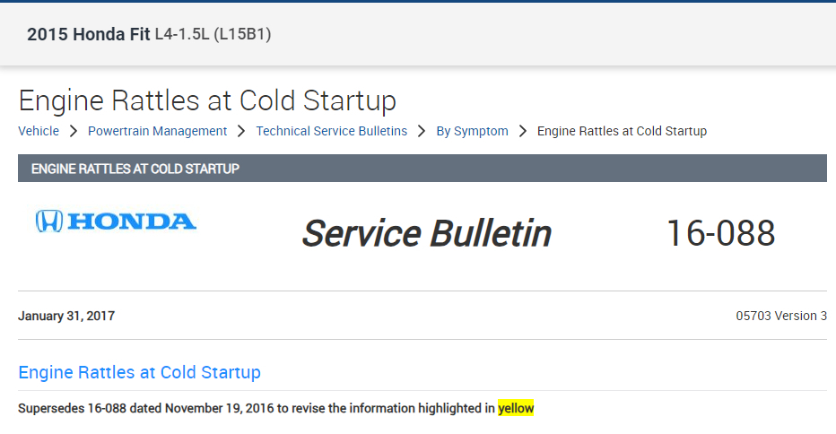

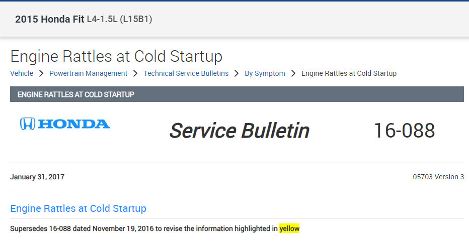

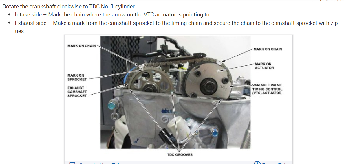

If I had to guess, I would say the variable timing control actuator (VTC) is faulty. This has been an issue on these vehicles.
I did some checking and found a technical service bulletin related to a rattle on cold start. Take a look through it and let me know if you feel it is relevant.
See pics below.
May 14, 2024 at 6:53 PM

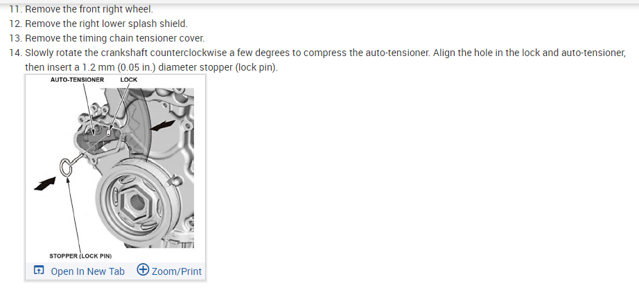

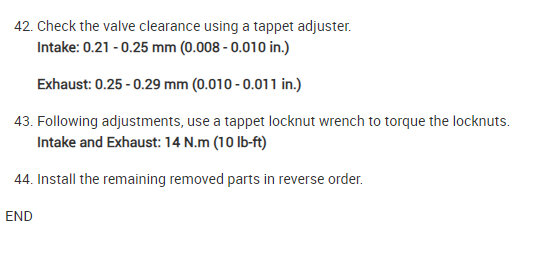

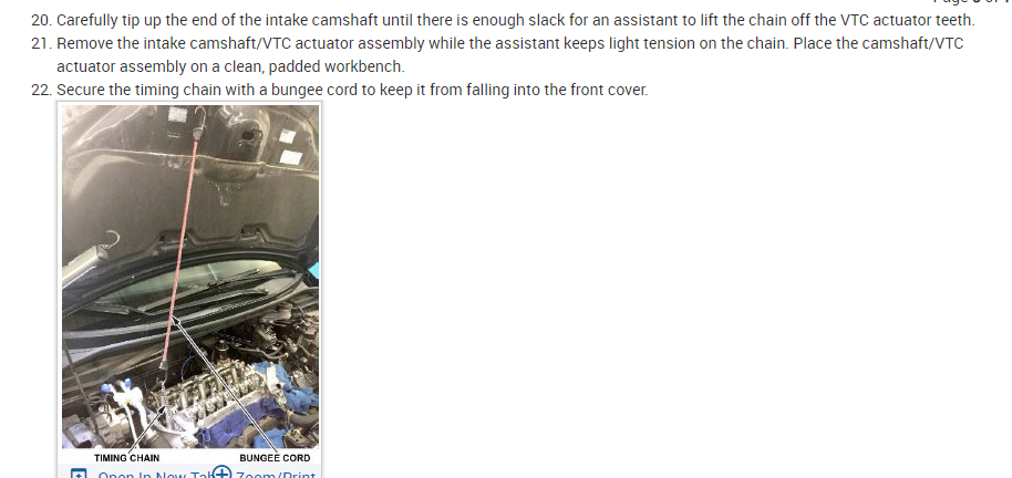

That's what I was thinking too but wasn't positive so asked the professionals lol... Can the VVT solenoid be taken out and cleaned? Also can you let me know where it's located on motor please?
May 15, 2024 at 4:55 AM

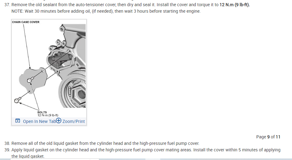

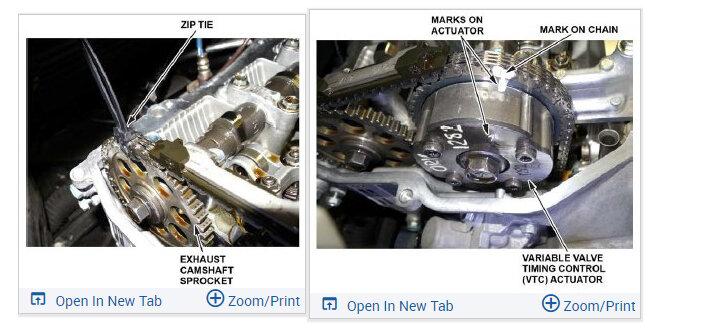

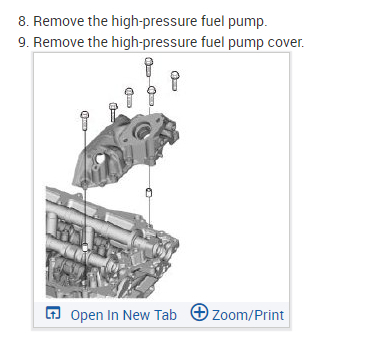

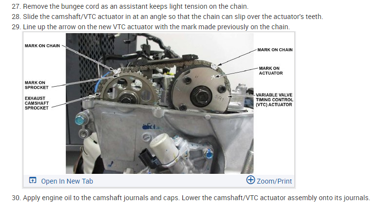

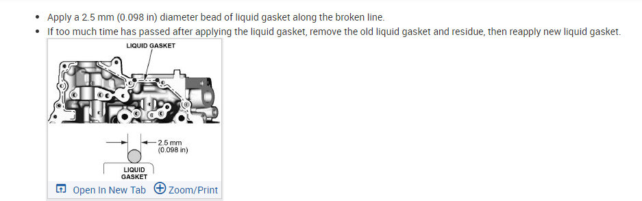

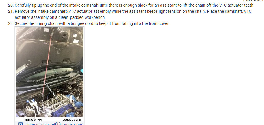

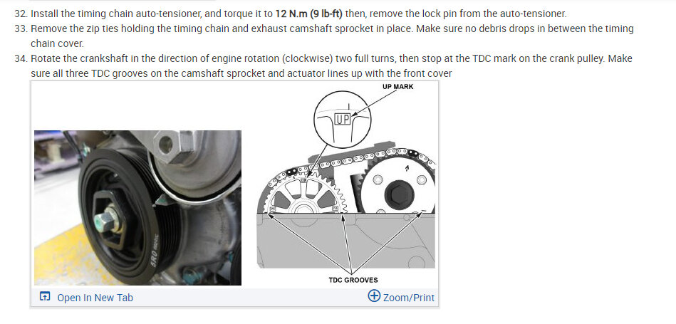

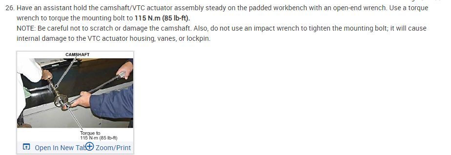

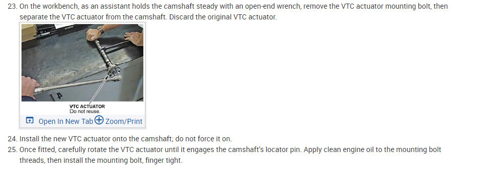

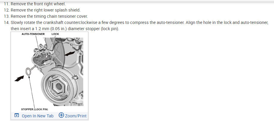

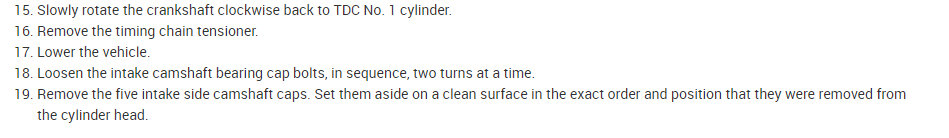

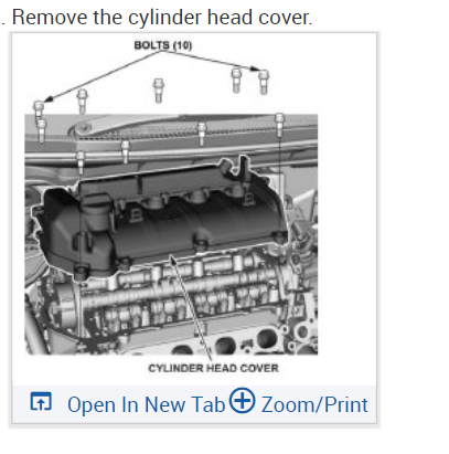

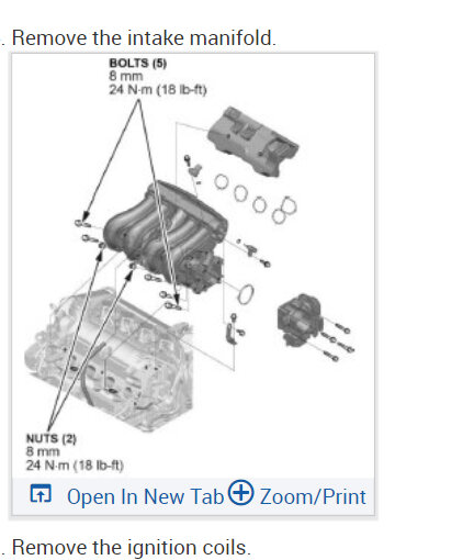

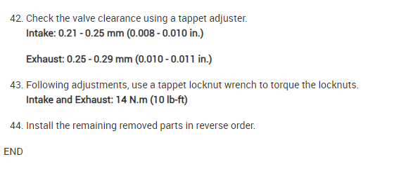

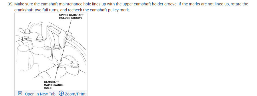

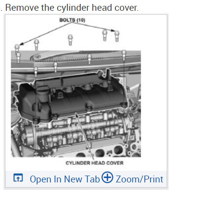

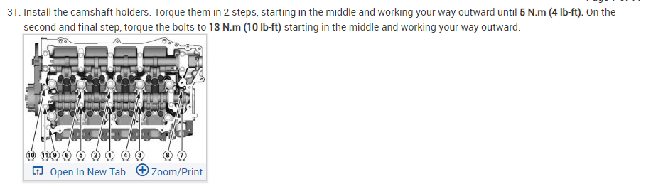

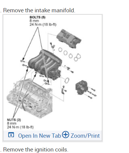

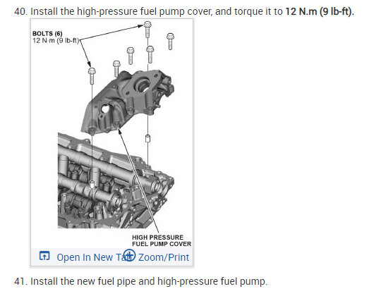

I would recommend replacing it. Cleaning may or may not help. Once you see what is required to access it, you won't want to do it twice.
I attached the directions below. Take a look through them and let me know if you have questions.
See pics below.
May 15, 2024 at 8:05 PM
