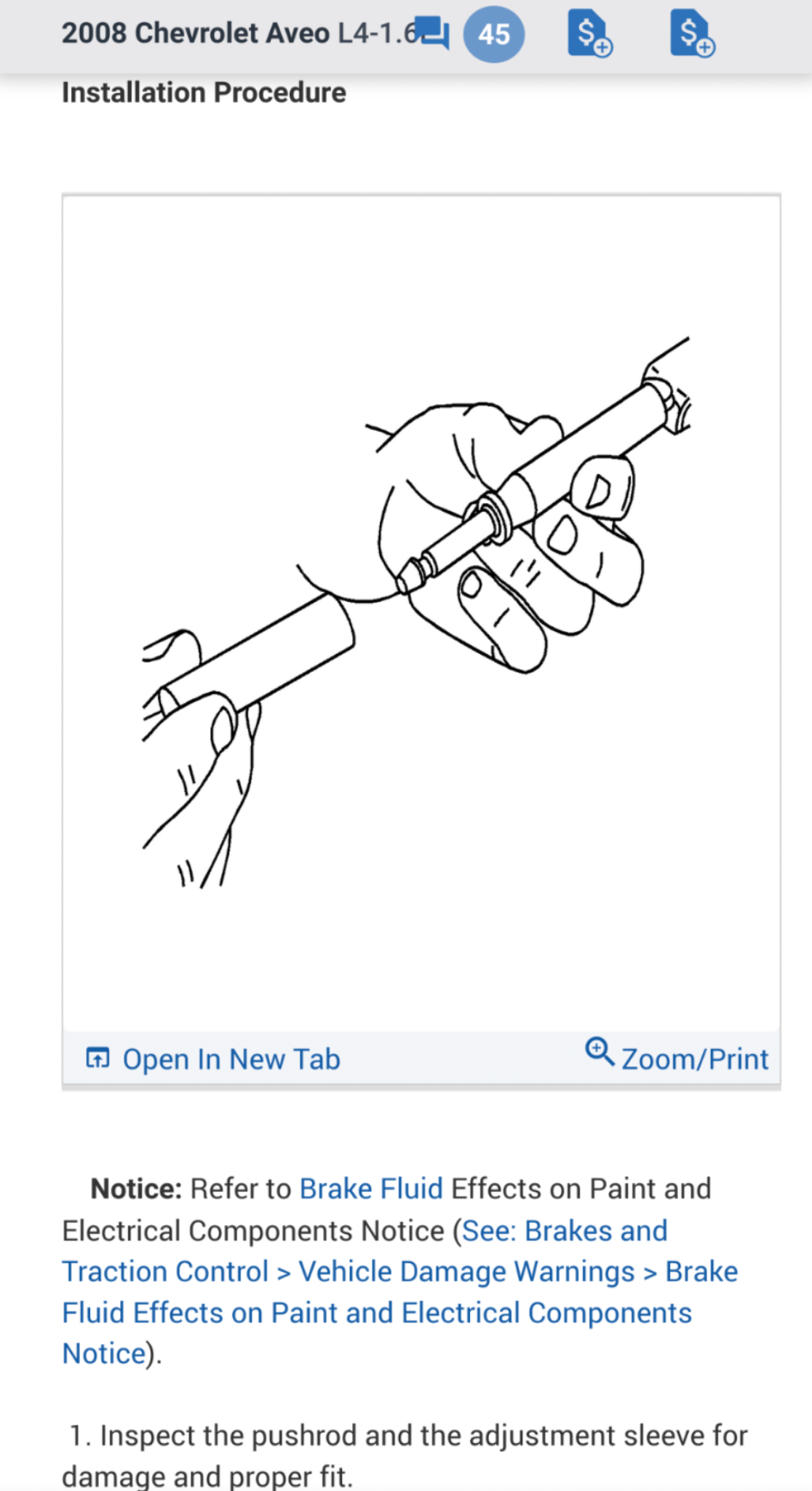

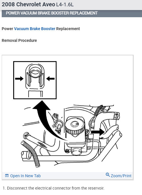

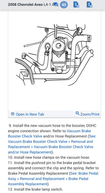

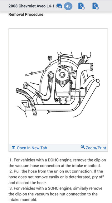

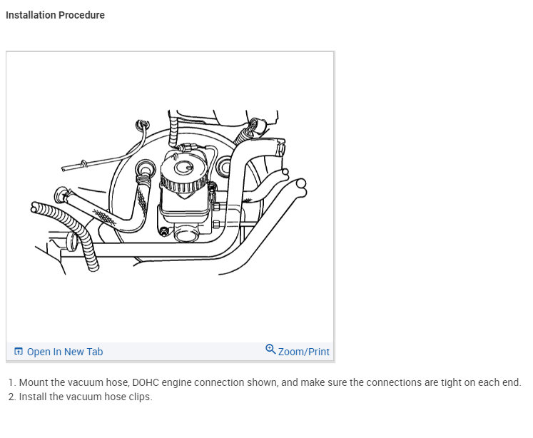

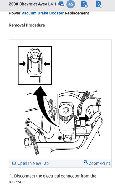

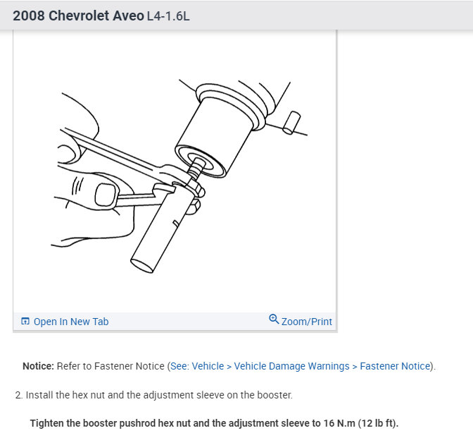

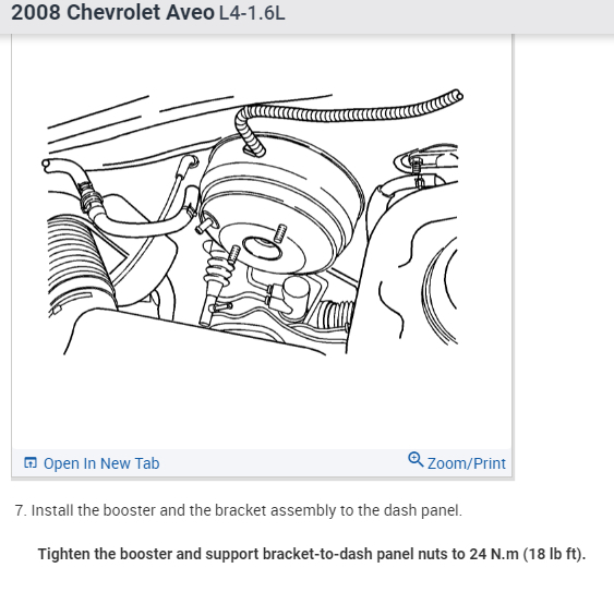

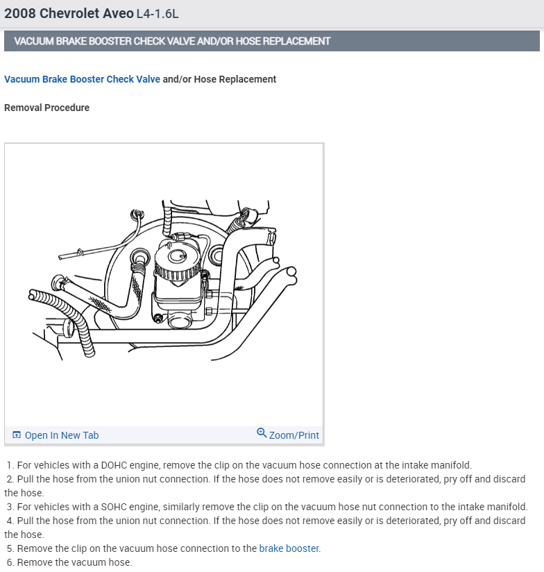

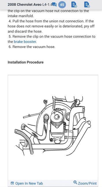

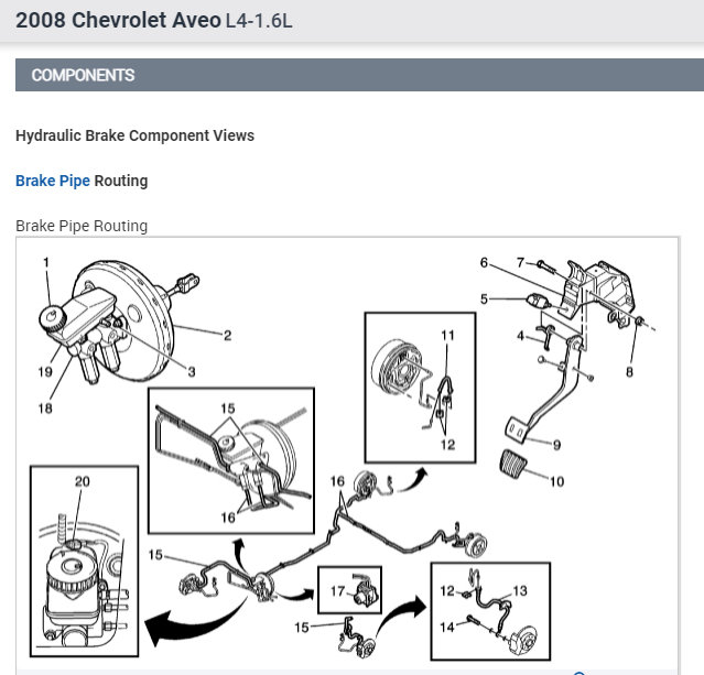

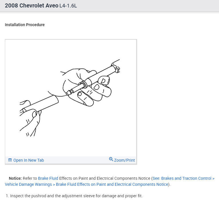

Hello, I'm Harry. Given your description, I would suspect the brake booster is failing. But first I'd check the vacuum lines for leaks. Especially the one going to the booster. Also take a good look at that check valve (mounted to the booster, vacuum hose one the other side of it). If it's allowing any blowback then it could easily be your issue. Replacing it is cheap and should be done even if you need a new booster too. I'm attaching instructions on the check valve to this post. I'll do another post shortly regarding removing and replacing the booster.
May 12, 2021 at 3:14 PM
HARRY P
  • 2,292 POSTS

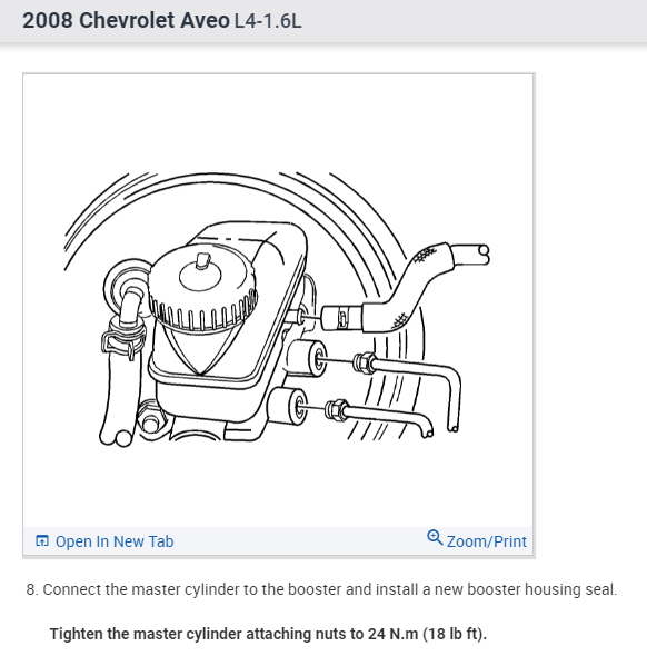

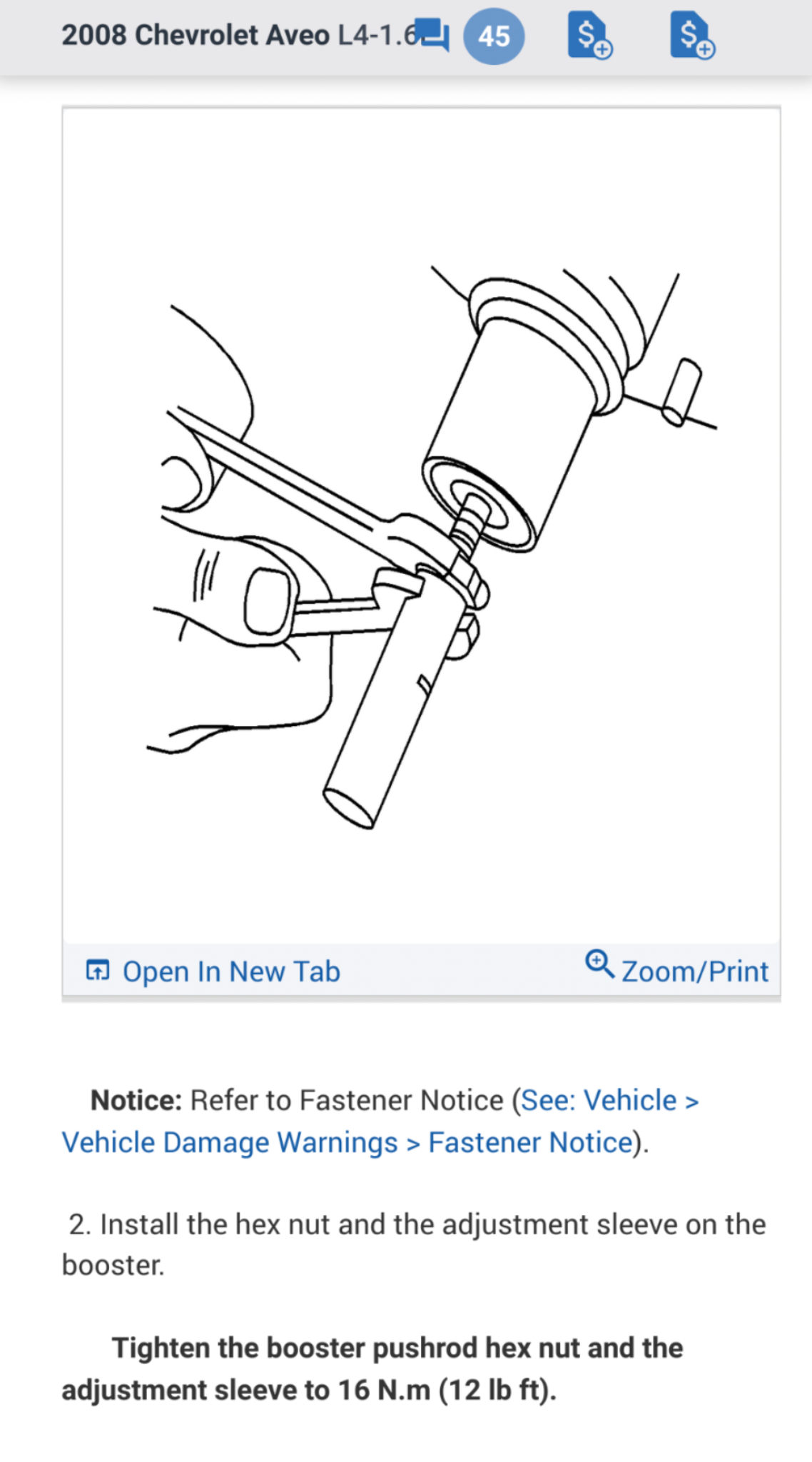

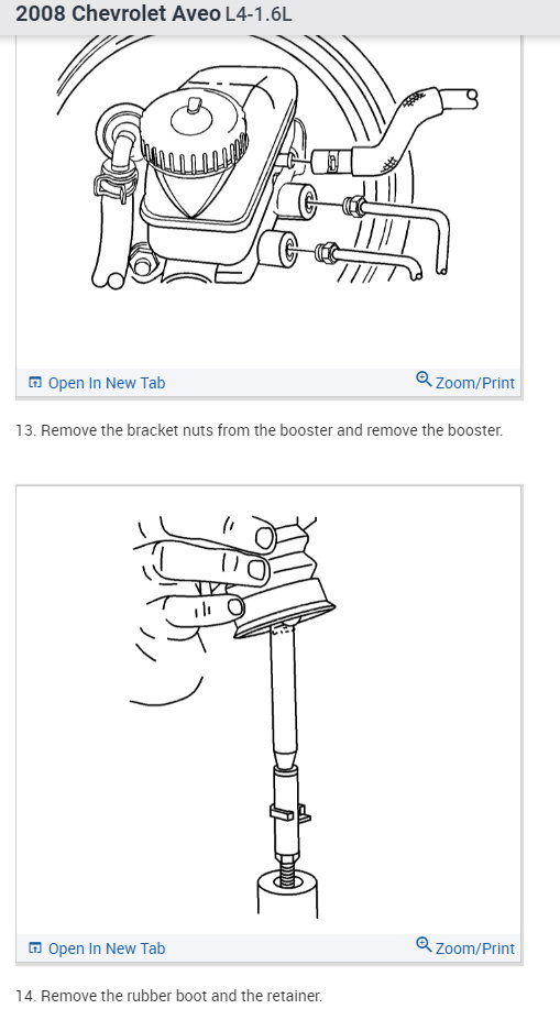

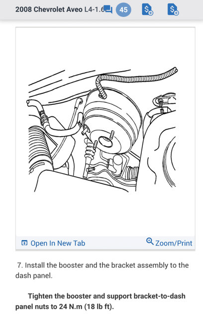

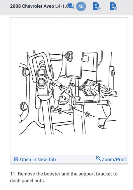

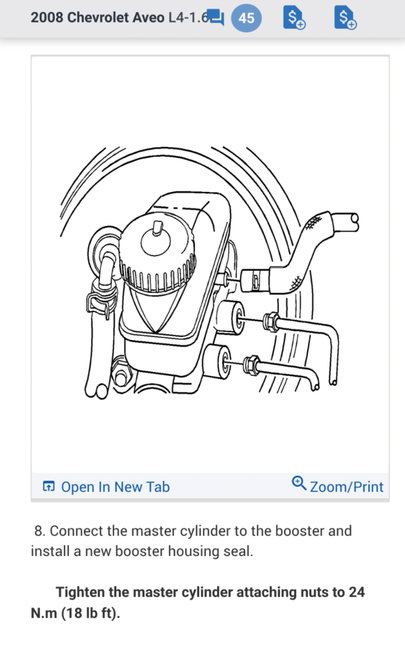

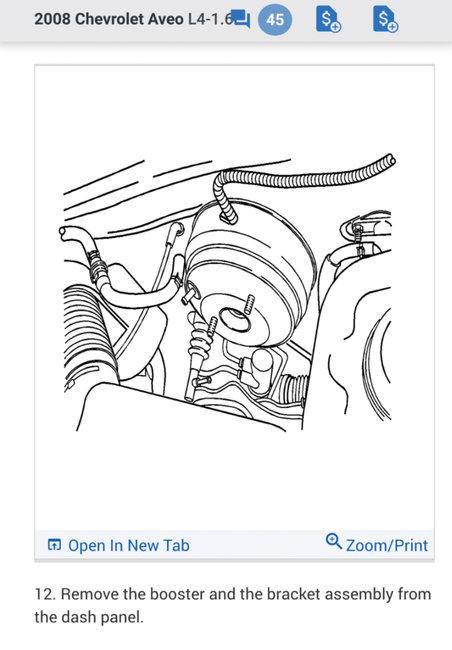

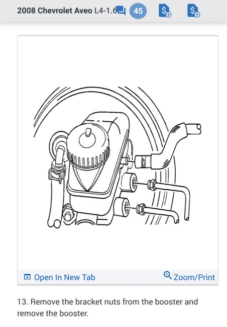

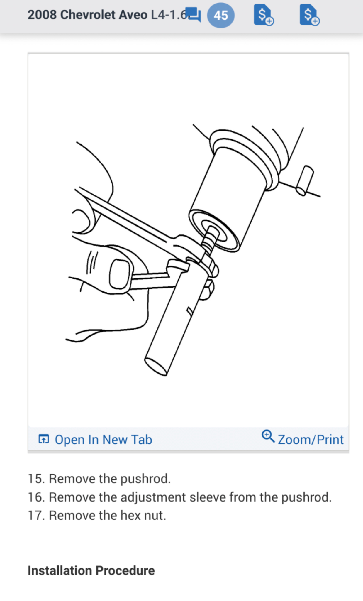

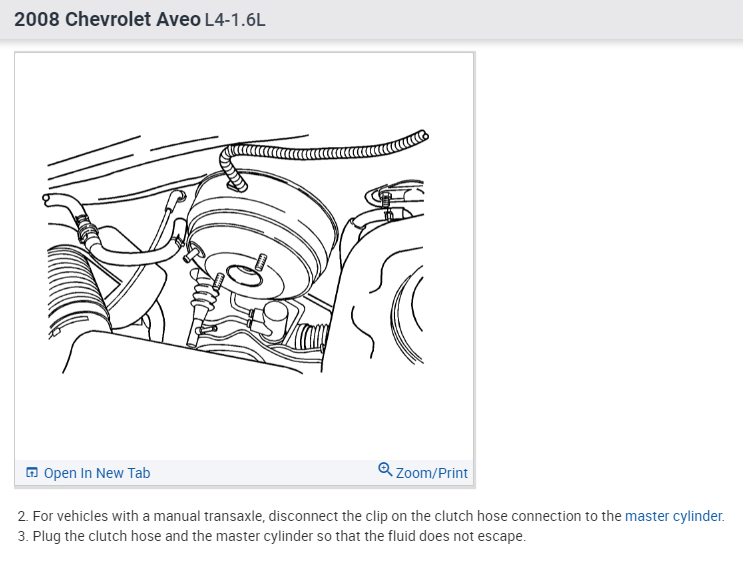

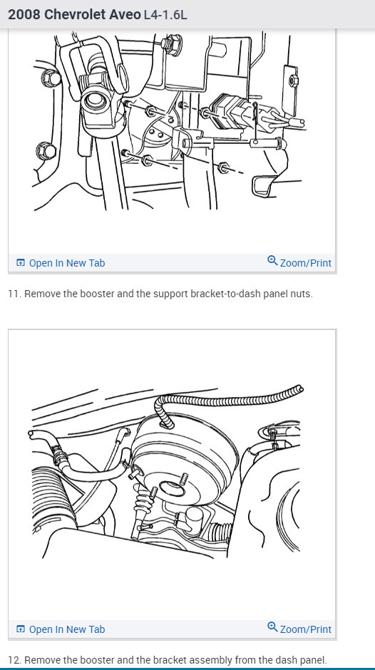

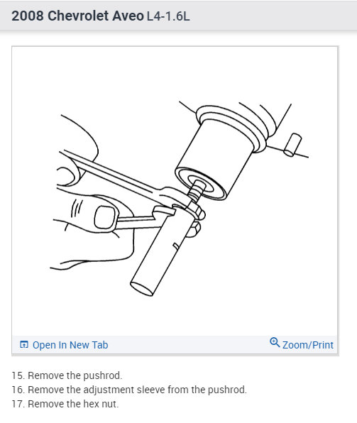

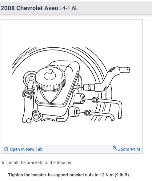

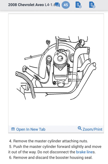

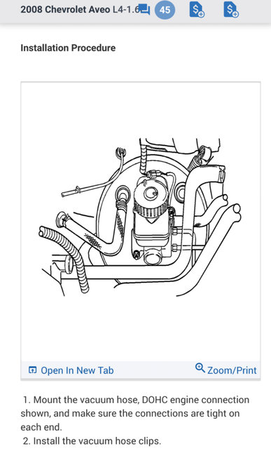

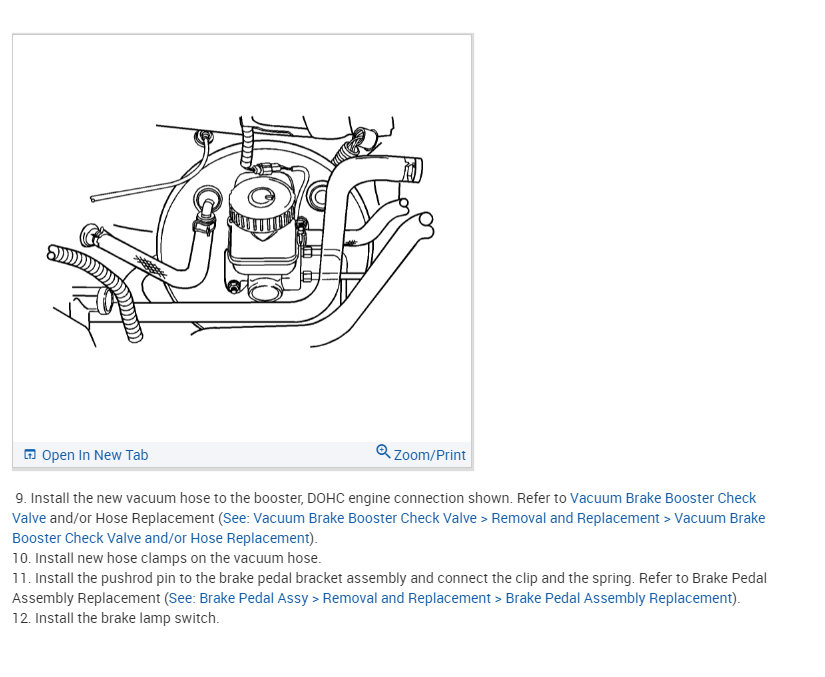

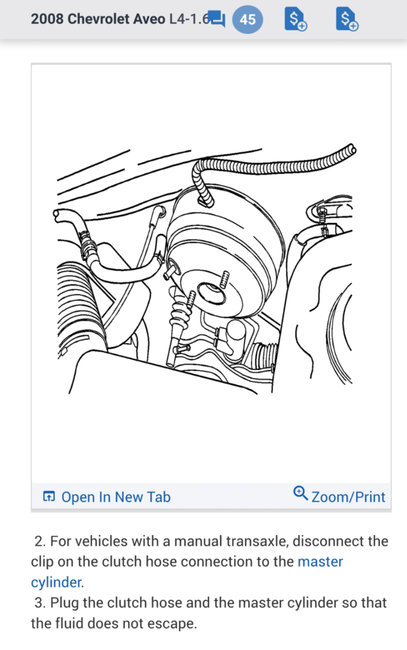

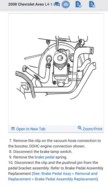

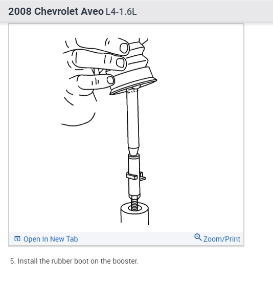

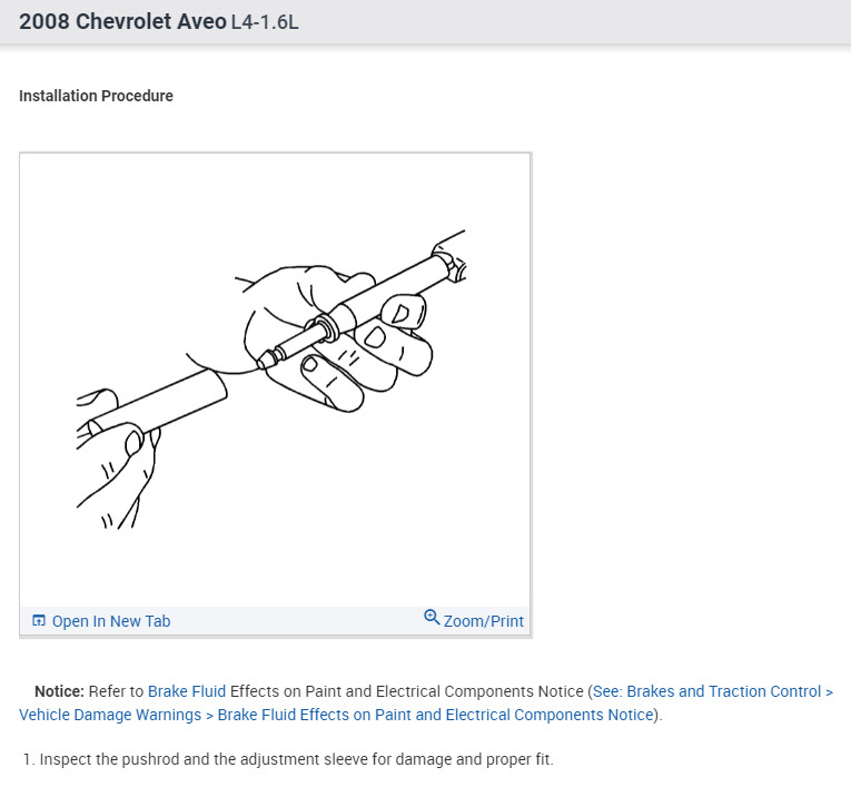

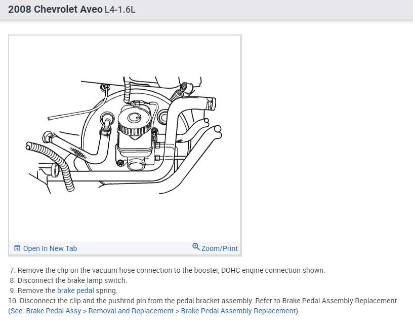

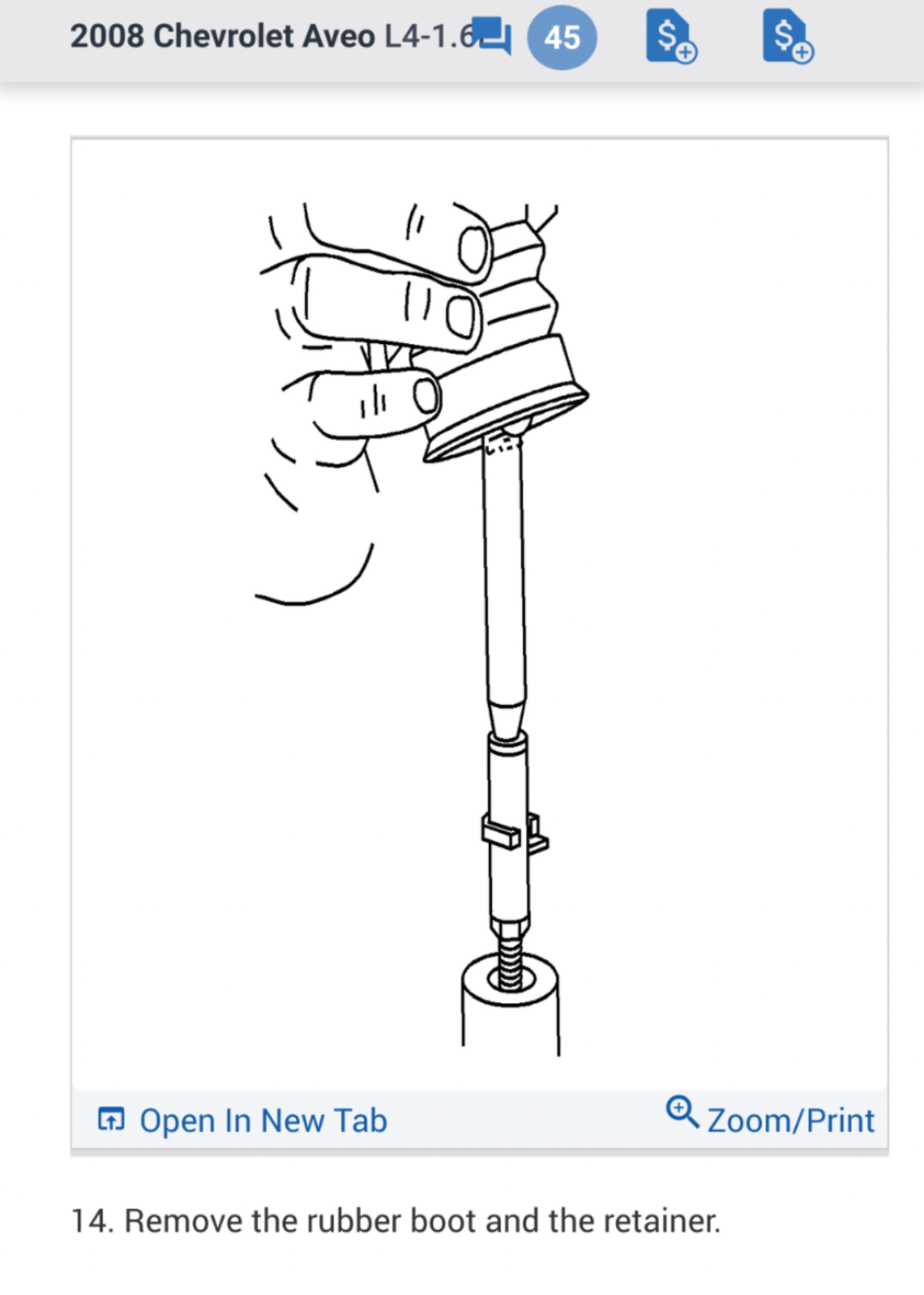

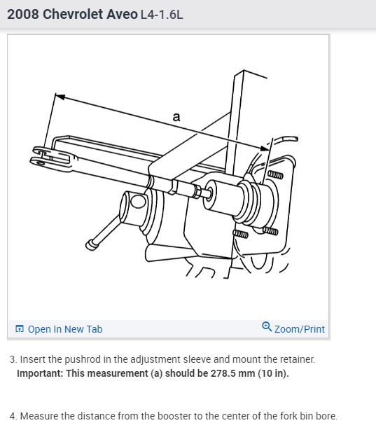

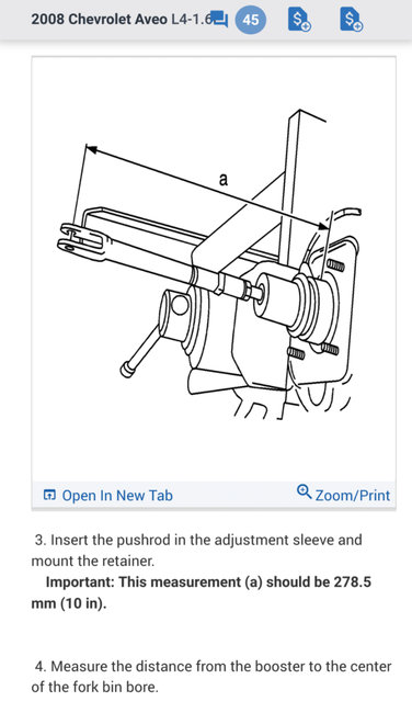

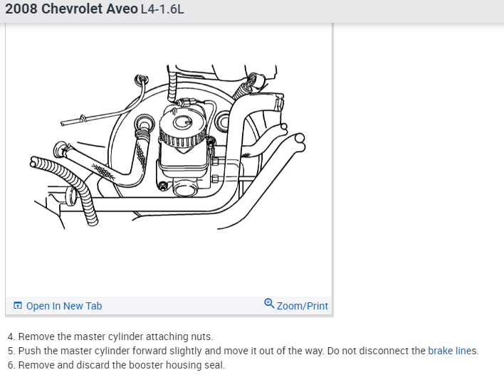

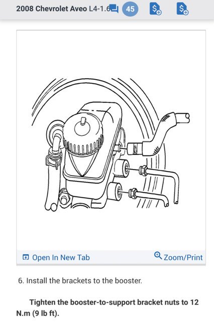

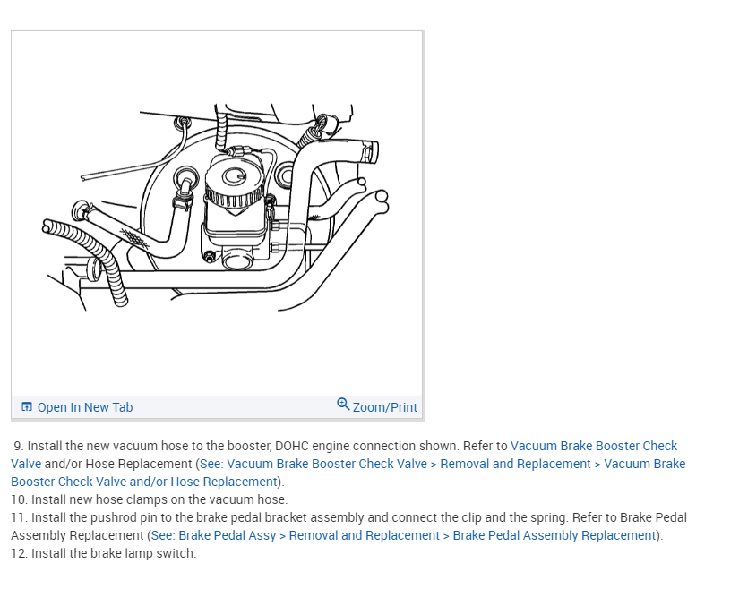

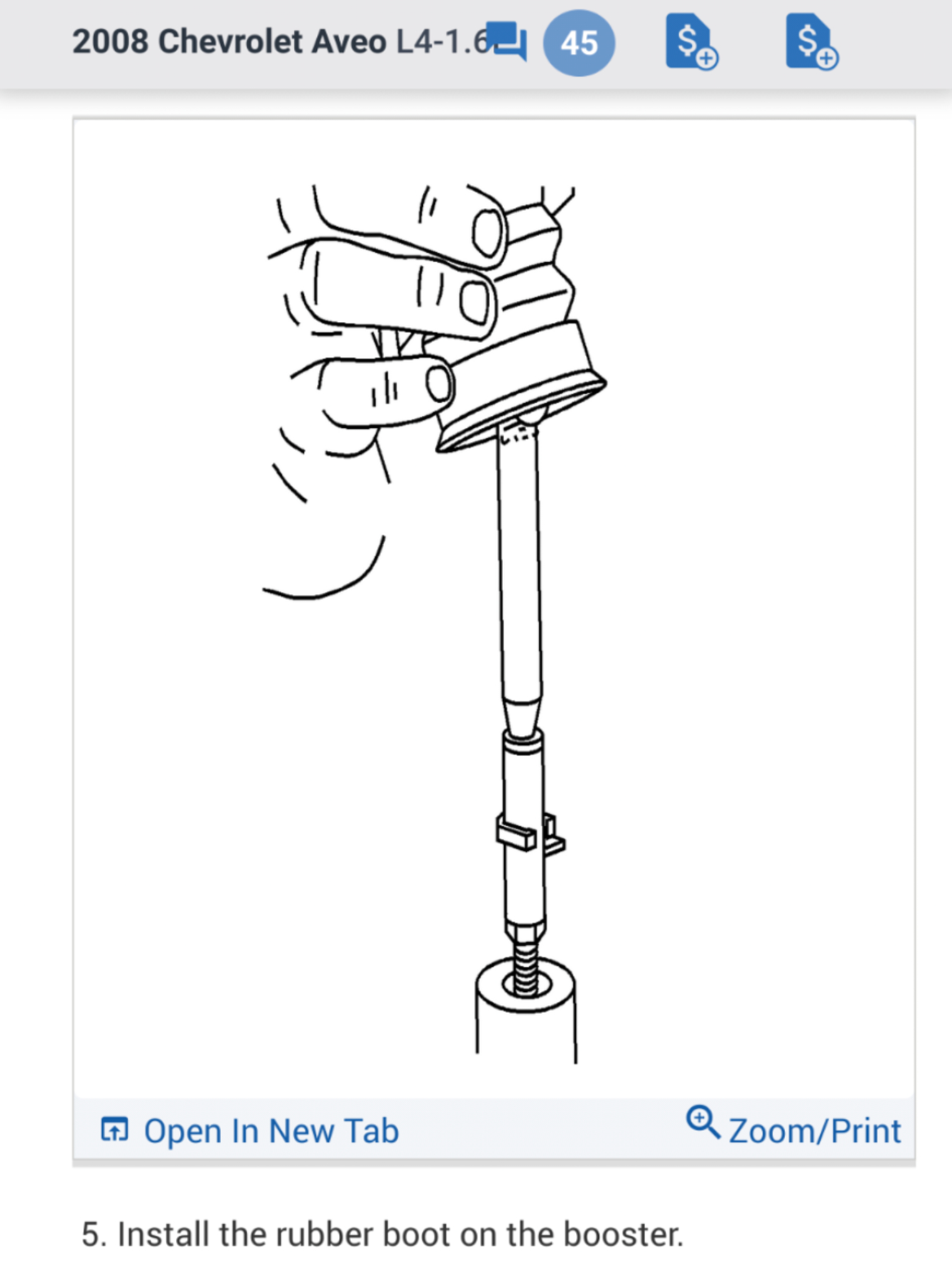

And here's the booster procedure. In my experience, while I haven't done the job on your specific vehicle, I suggest removing the driver's seat. It'll be a little more bearable.
May 12, 2021 at 3:33 PM
