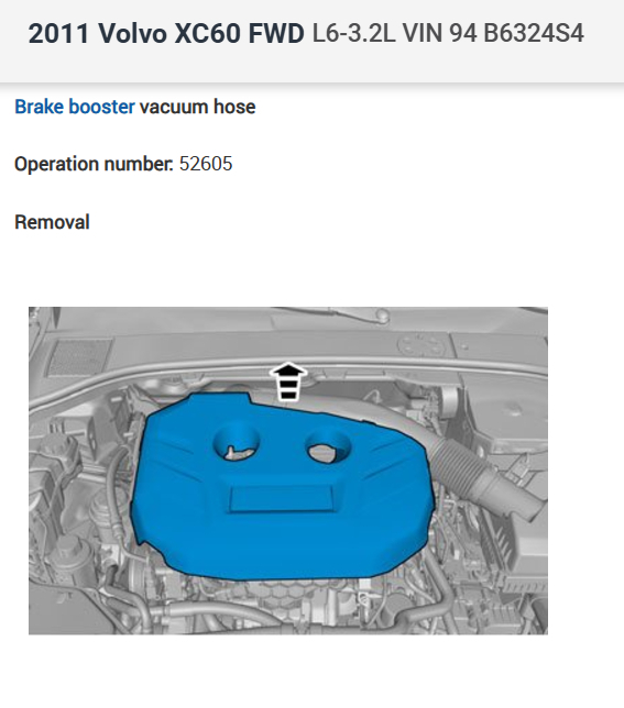

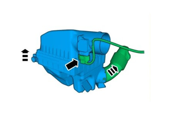

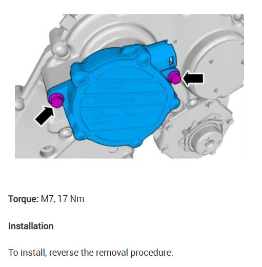

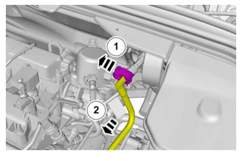

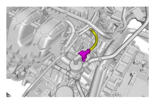

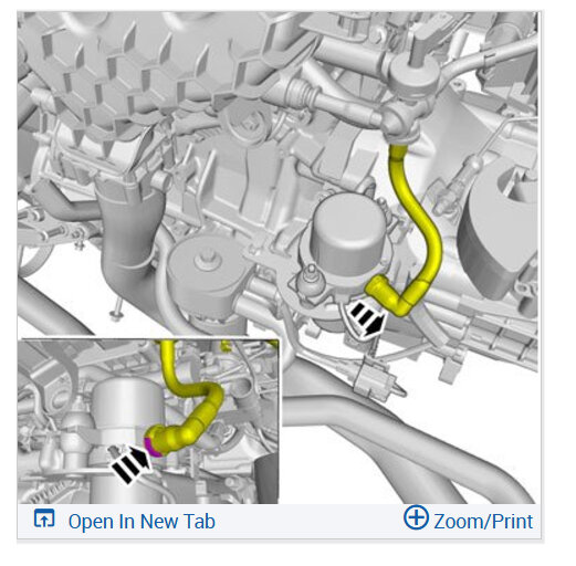

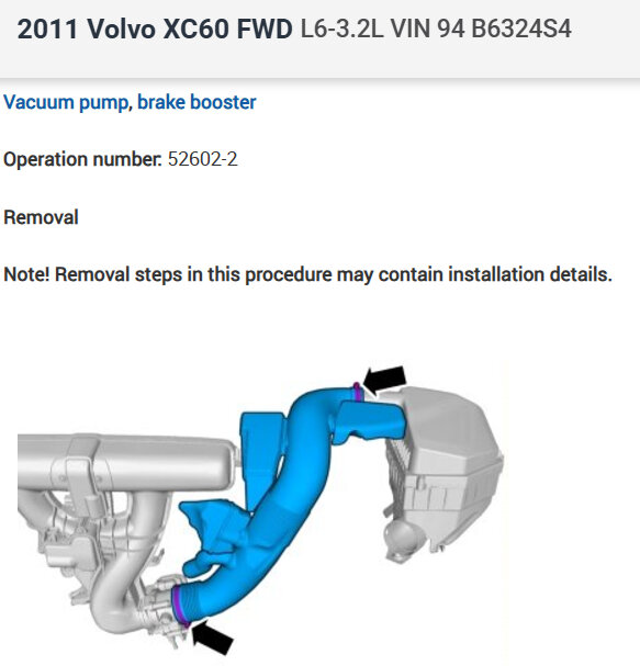

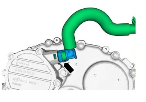

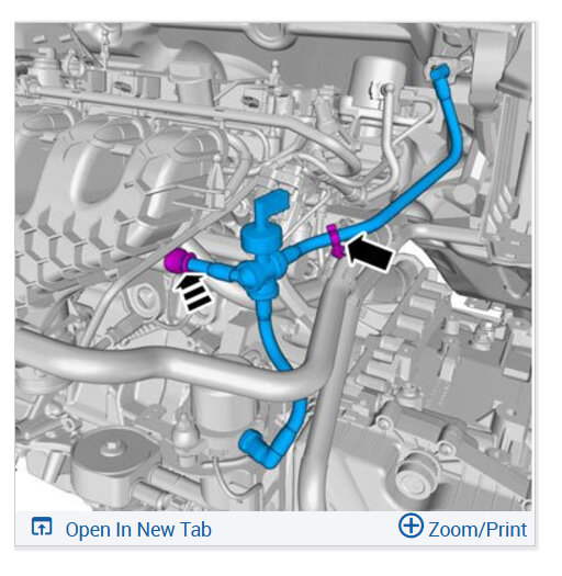

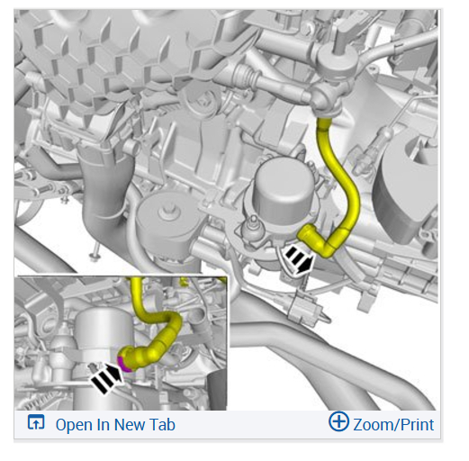

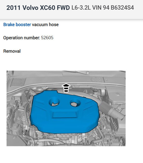

When the brake pedal is hard to push are the brakes locked up? If not it sounds like the booster is going bad or the vacuum pump stopped working, I would start the engine with the vacuum line removed from the booster to see if there is vacuum and try to see how much, it should be enough to refill the booster quickly. Check out the images (below). Please let us know what happens.
