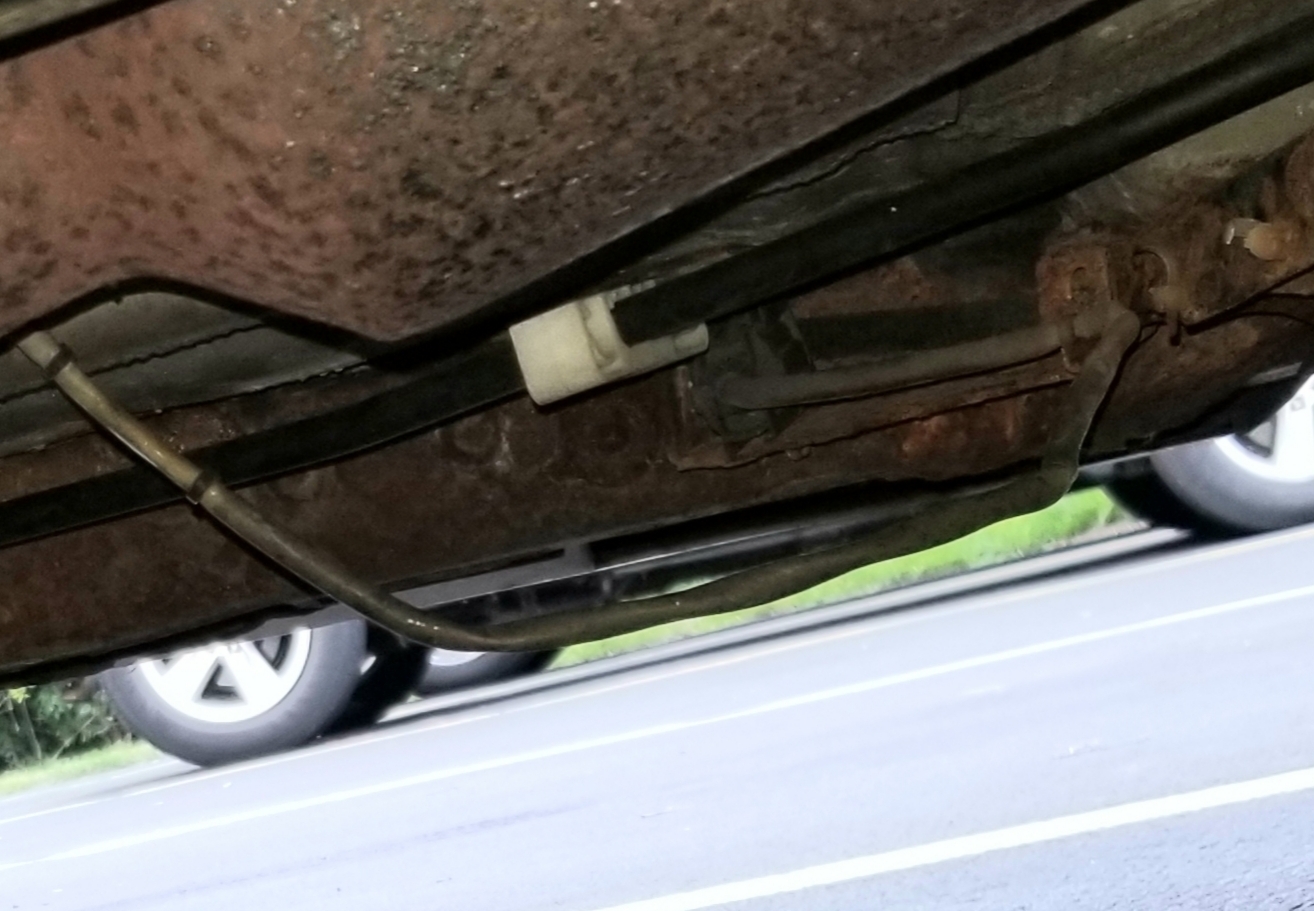

Looked under my car after having new lower control arms installed and there is a hanging cable underneath in the center of car behind drivers' side
Any ideas what it is?

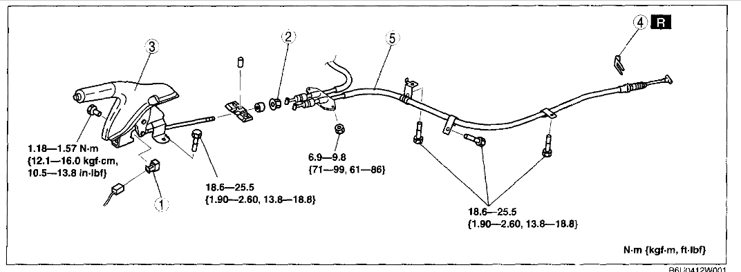

Follow it and see if it goes to the parking brakes. I believe it is a brake cable, but it's hard to tell for sure.
I attached the only pic I could find. See if it runs from the center near the park brake lever and then back toward the rear.
See pic below.

Something is weird...not sure if you got my response, Hopefully you did...that it was the O2 sensor cable..ziptied it
