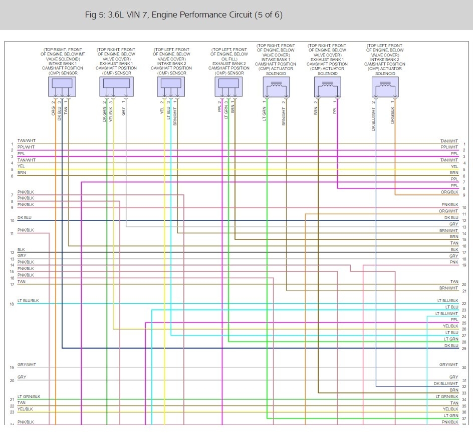

Okay, I have the car listed above. I have code P0017, and P0018 . The car starts up great , and runs great, this car never gave me any issues, my question is , how can I test hall-effect camshaft sensors using a voltmeter?
May 30, 2017 at 9:31 AM

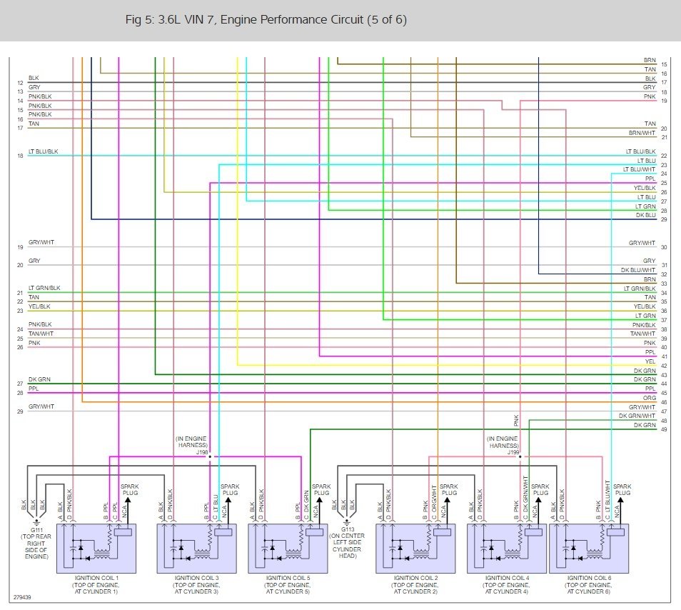

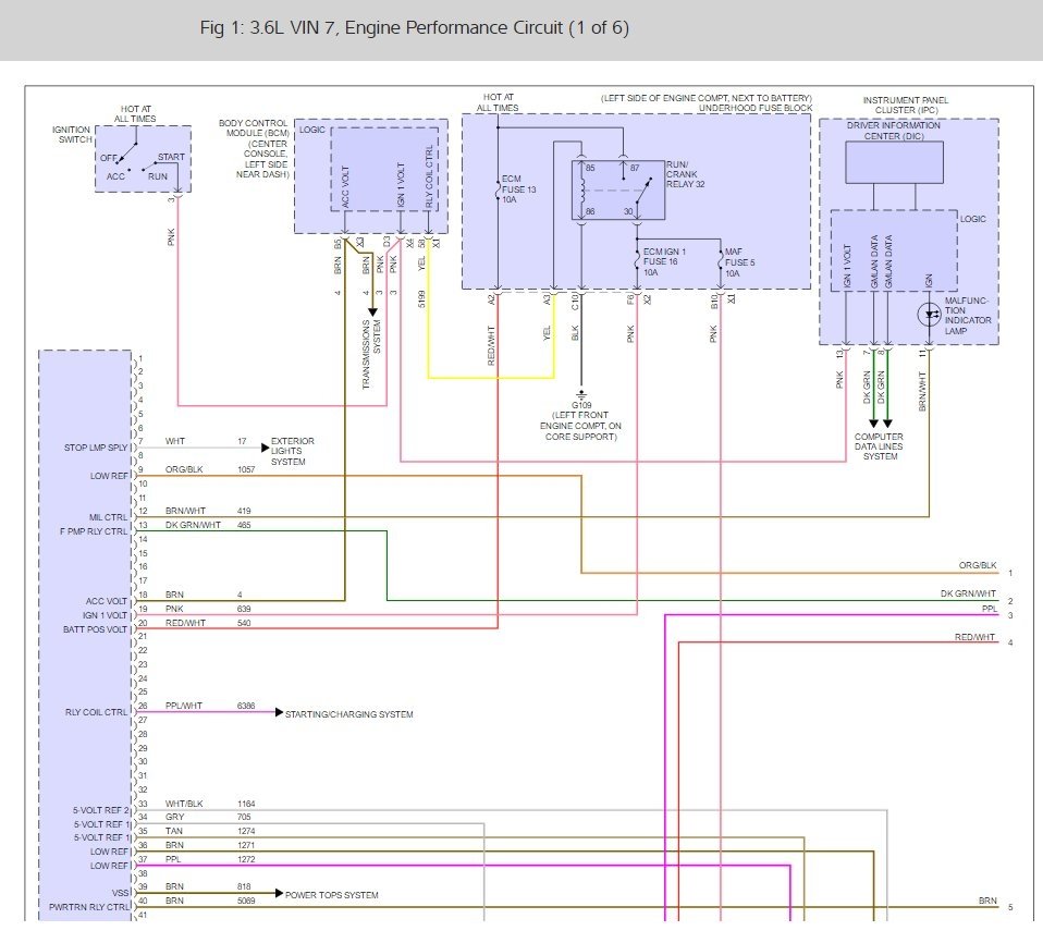

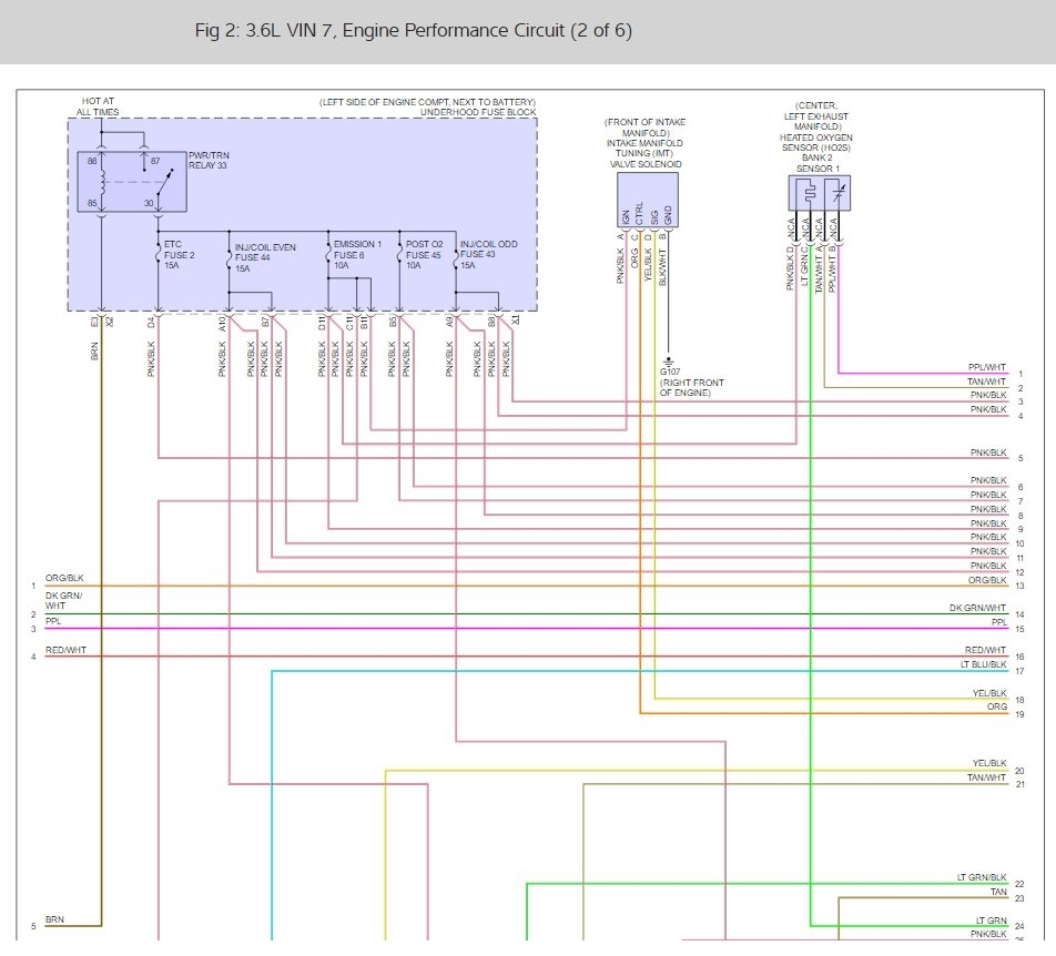

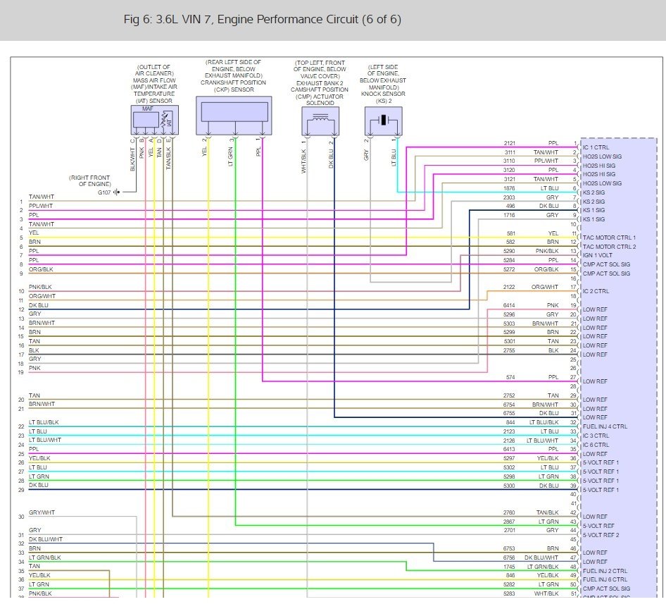

Those codes have to do with the camshaft and crankshaft correlation and are set when the timing chain, guides or camshaft actuators wear out. I have found the engine wiring diagrams (below) for you so you can test for reference volts and signal along with the guide on how to use a voltmeter so you can do some testing.
Please run some tests and get back to us so we can continue helping you.

The problem won't be the sensors. As Ken said this is related to timing chain wear. It causes the crankshaft to be slightly out of time to the camshafts. That lag causes the computer to throw codes. If you have an O-scope you can look at the signals and see they are out of sync. The only repair is new timing components.

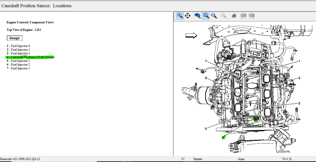

ASHLEY CAIN

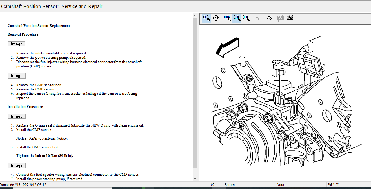

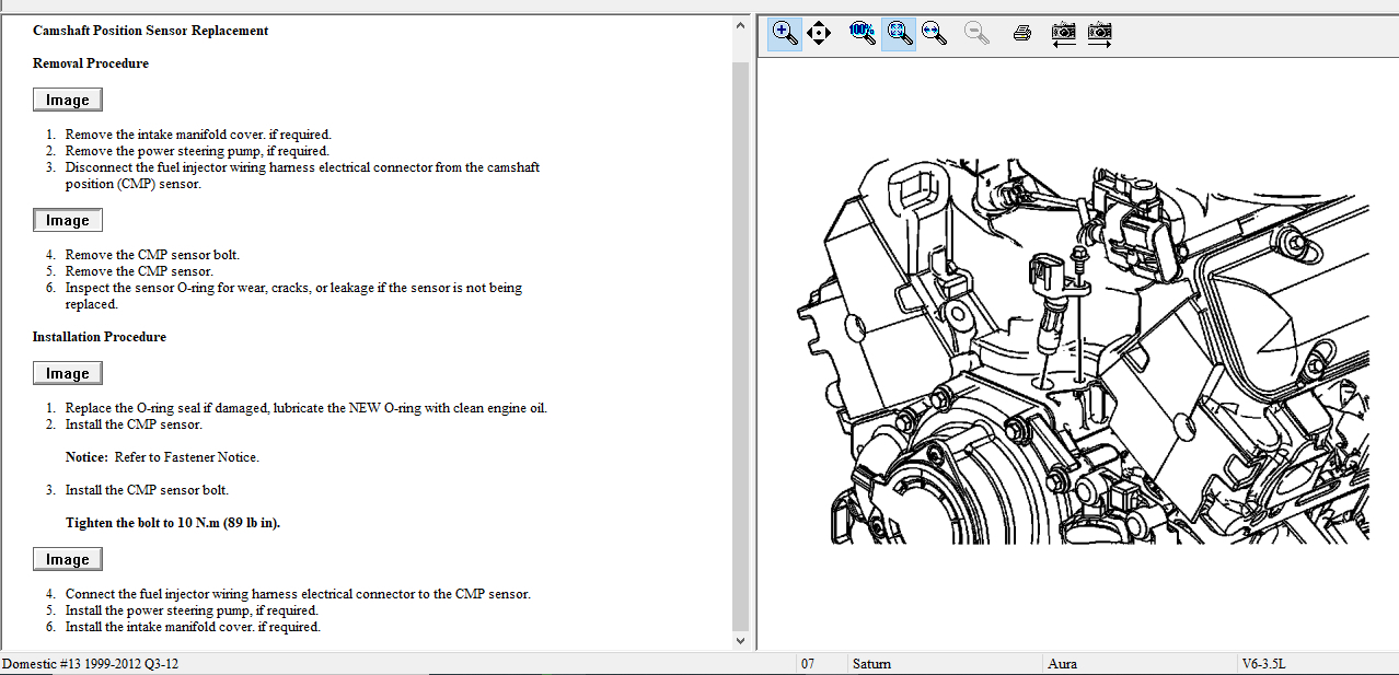

I am trying to replace the sensor but I cannot find the location of the sensor. Someone please help me. I'm sure I'm just overlooking it but it's starting to frustrate me .
Feb 8, 2021 at 5:27 PM (Merged)
SEVAG P
  • 405 POSTS
hello.
check the pictures and the procedure below how to remove and reinstall camshaft sensor for 3.5 L engine.
