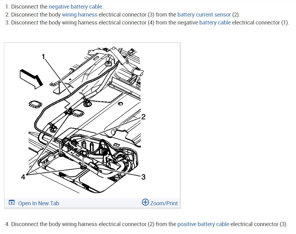

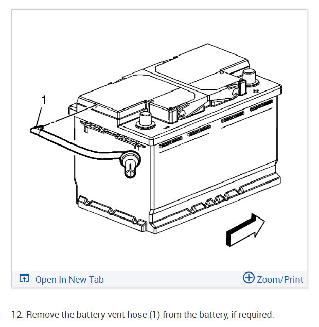

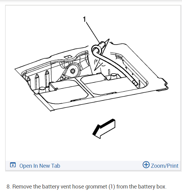

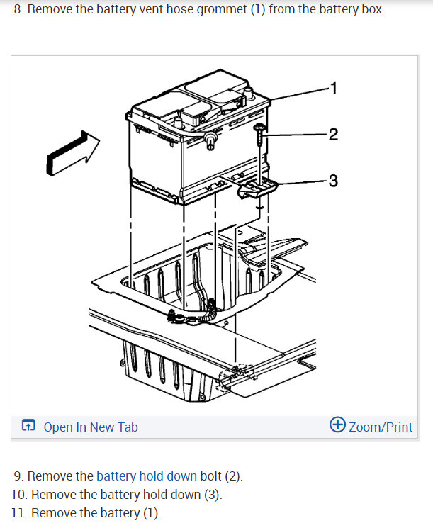

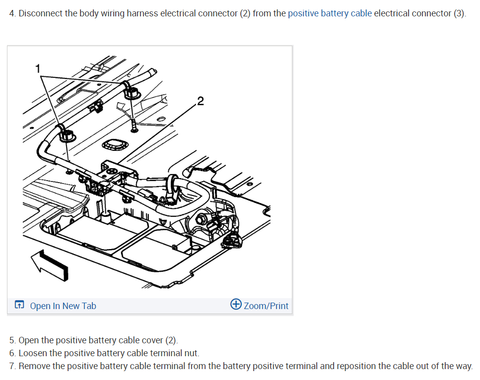

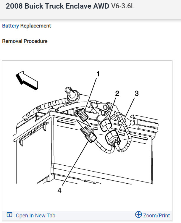

Yep, I would replace the battery, it sounds like it is defective. Also, I would check the positive battery cable for corrosion which can be internal and hard to find. These instructions may help you. Check out the images (below). Please let us know what happens.

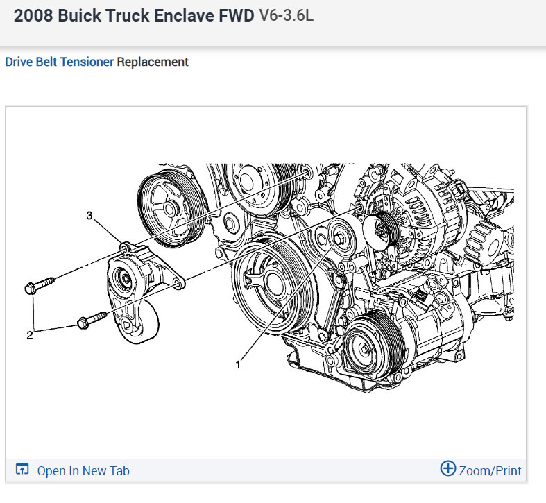

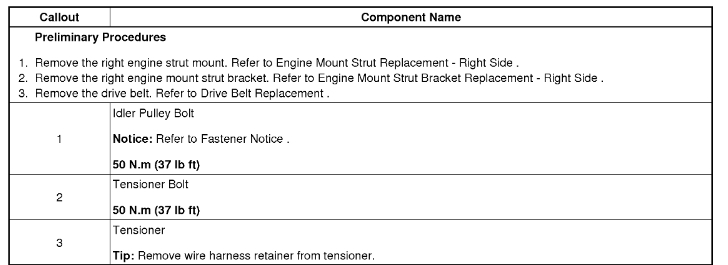

The alternator seems like it is working okay, the voltage will naturally go down as the battery is charged up. When the engine is running how does the serpentine belt tensioner look, is it bouncing around? I have seen these tensioners cause vibrations. Here is what I am talking about. Check out the images (below). Let us know how it goes.

I had just replaced the tensioner, and idler(s) pulleys before the Alternator shorted, and it did freeze up and burnt the belt off so maybe it do some additional damage. I will take a look while its running.
The vibration feel/noise is strongest between 1400 and 2000 rpm, goes away if i lift off the throttle.
