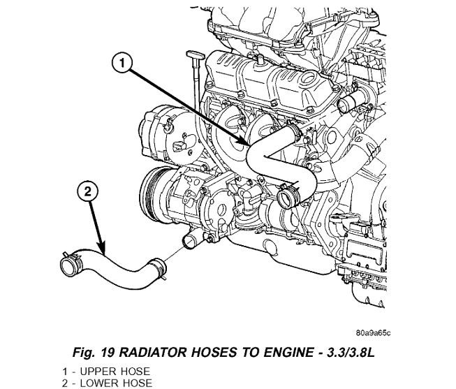

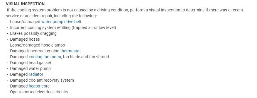

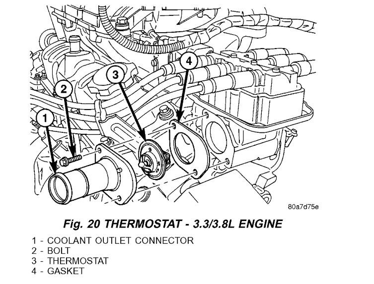

I would start by replacing the thermostat. If the coolant is getting too hot, it will boil in the surge tank and create air which will not allow heat.

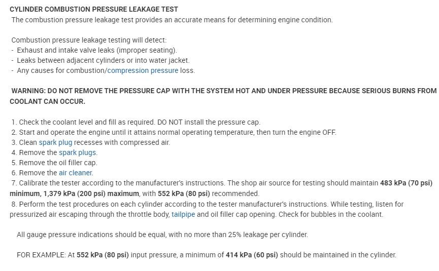

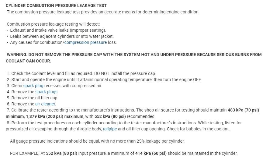

The other possibility is that a head gasket may be leaking compression into the cooling system from the overheating. This would require major work replacing the head gaskets.
