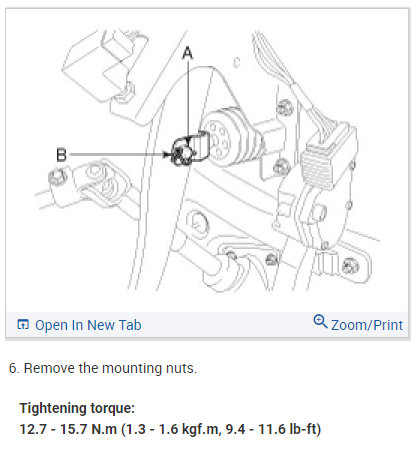

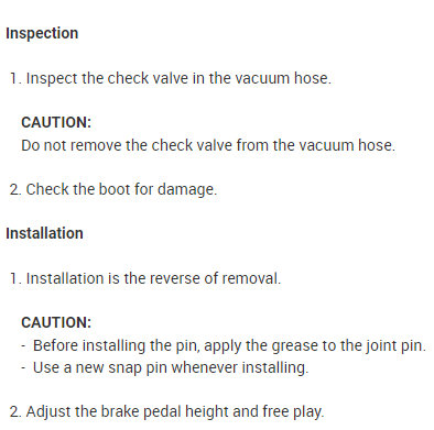

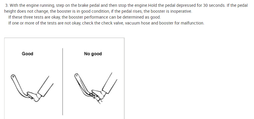

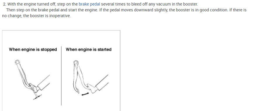

When I brake at high speeds or when I first drive the car, there are no weird braking sounds. However, when I have driven the car for about 25-30 minutes and hit the brake at slow speed (like coming up to a light or stop sign or speed hump), there is a loud hissing sound coming from the driver's side. I don't hear anything outside the car and it doesn't do it all the time. I need to replace the booster.
