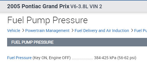

It is very possible the fuel pump may be failing. What I would recommend is to check the fuel pressure to confirm it is within the manufacturer's pressure specifications.
Here is a link that explains how to check the pressure:
You will need a fuel pressure gauge, but most parts stores will lend one to you. Also, I attached the fuel pressure specs below.
Try this and let me know what you find.
See pic below.
