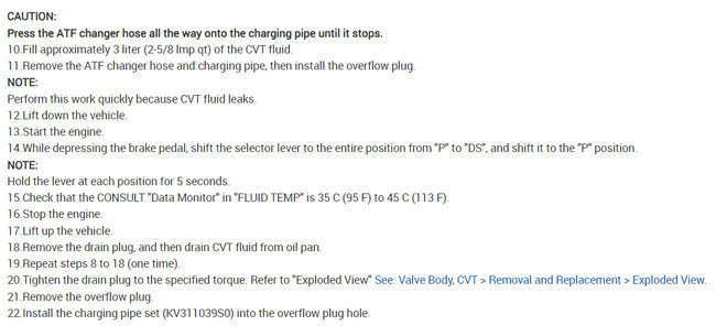

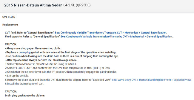

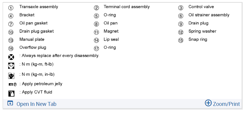

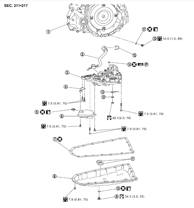

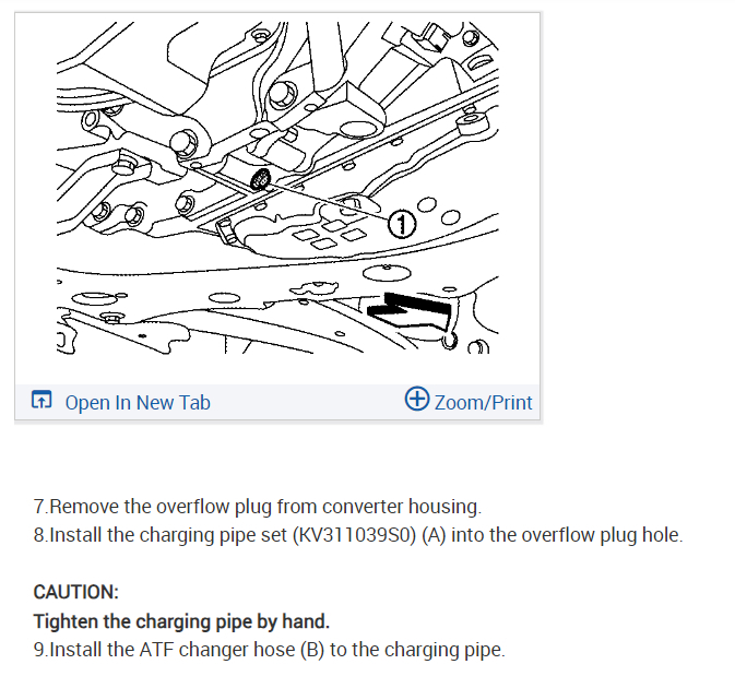

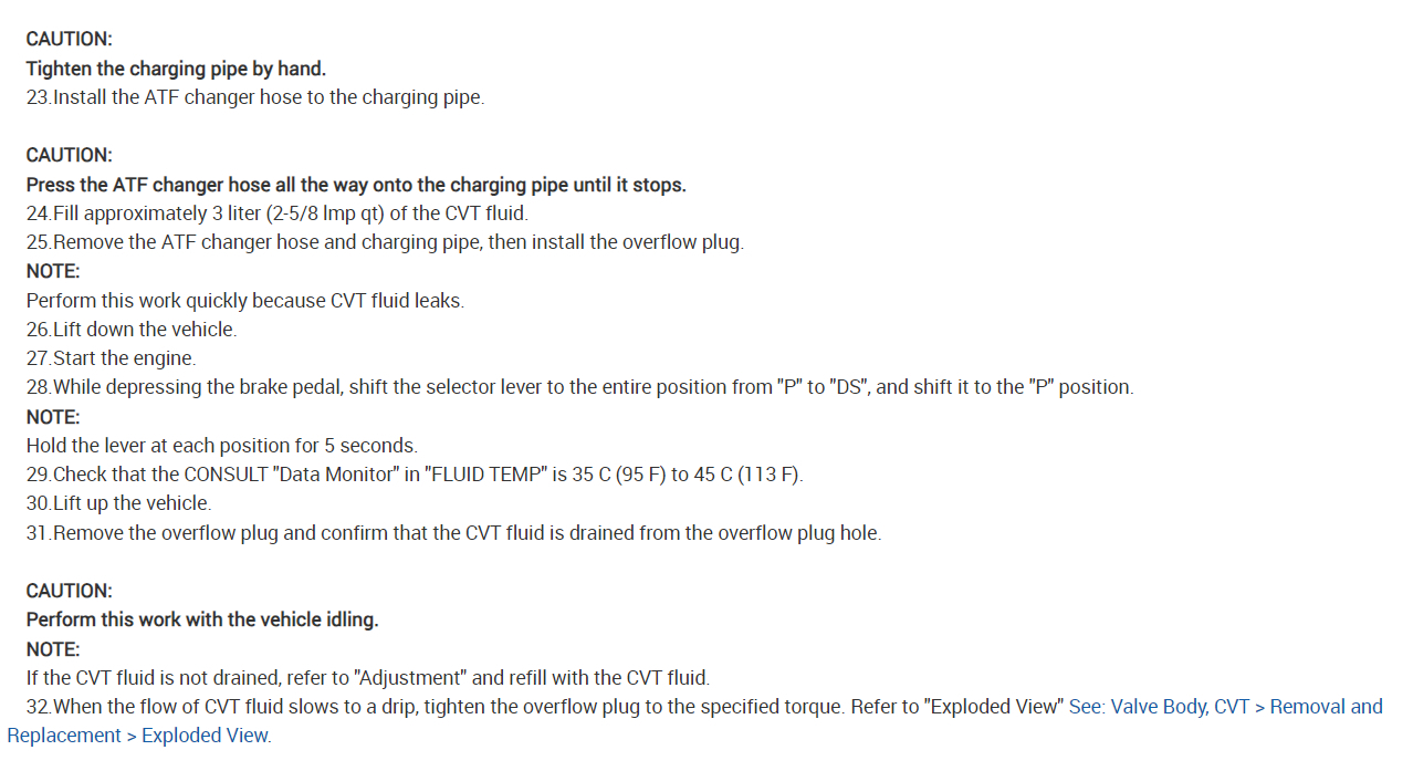

it could be a clogged transmission filter as well. If the noise is coming directly from the transmission, I would swap the filter on and install fresh fluid. Check out the images (below). Please let us know what happens.
