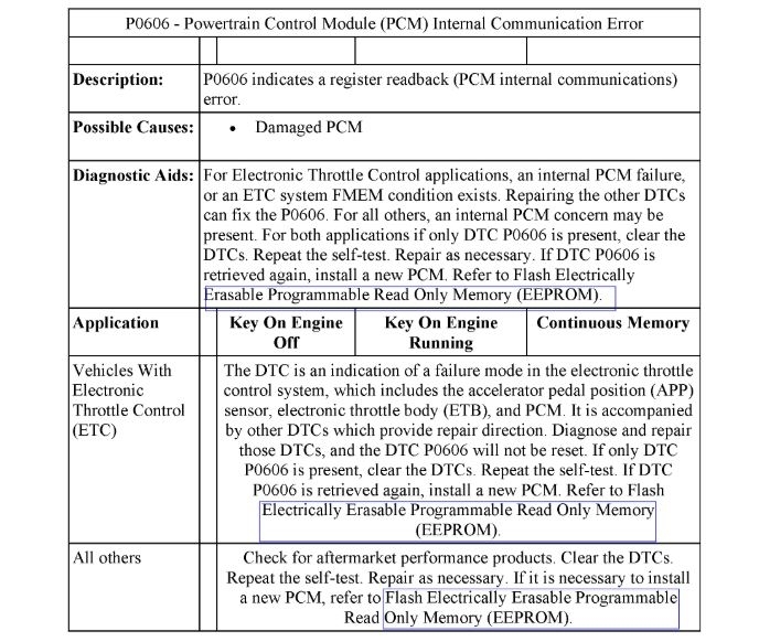

I have the SUV listed above VIN number 1FMZU73K05ZA77144 and I had a diagnostics test done.There were three things all transmission related. P0606-Processor Fault Code. P0733- In Correct Gear Ratio #3. P0745- Pressure Control Solenoid. In which order would you recommend in repairing and would replacing one eliminate the others?
