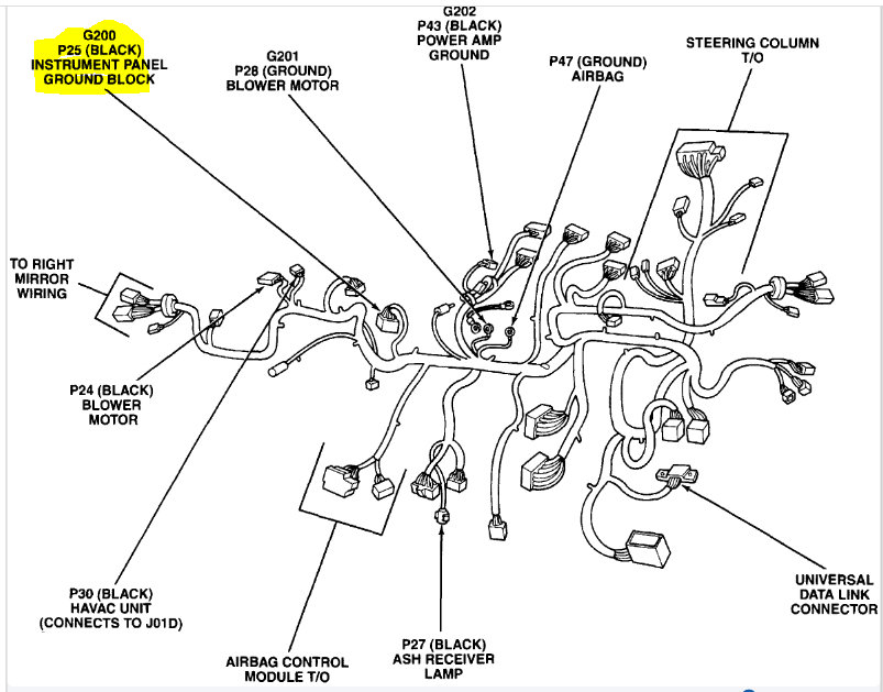

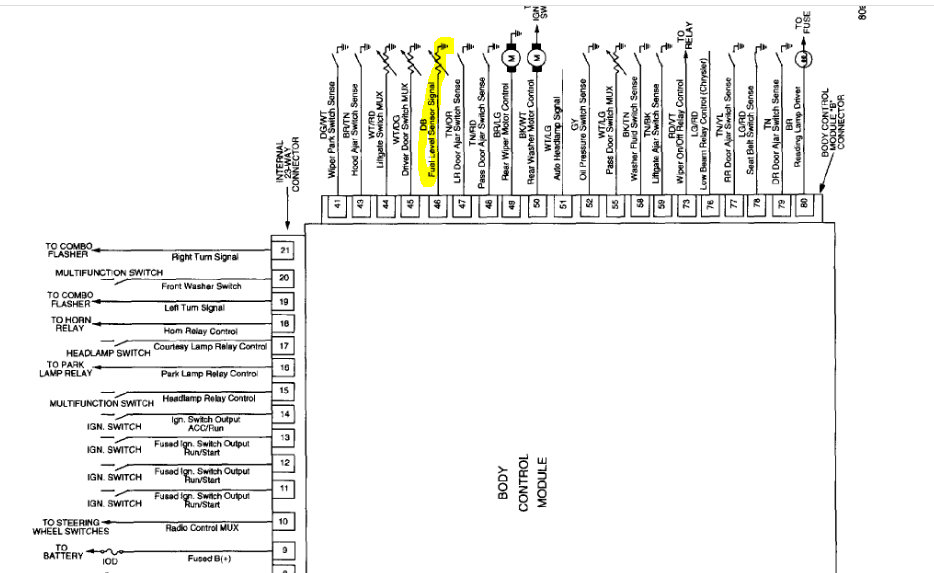

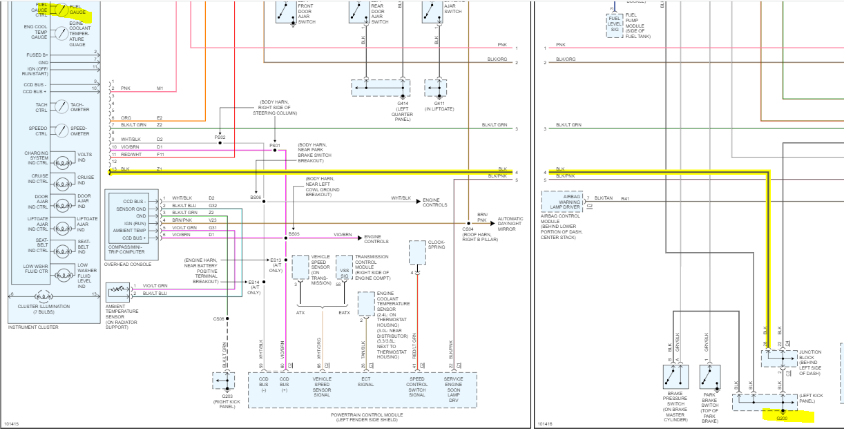

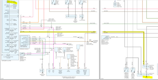

The ground for the rheostat itself is with the fuel pump. The body control module receives a fuel level sensor signal by supplying power to the rheostat which functions as a resister.

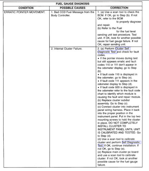

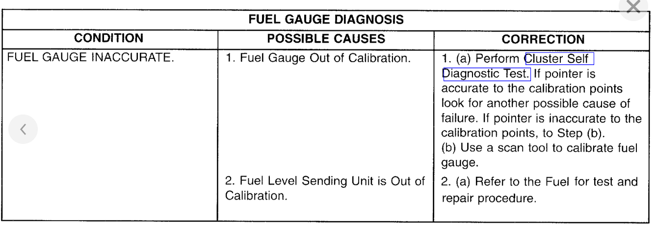

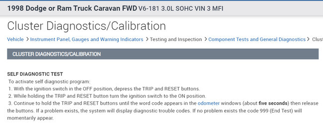

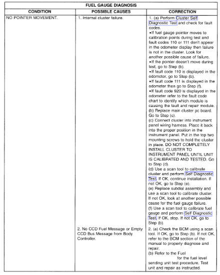

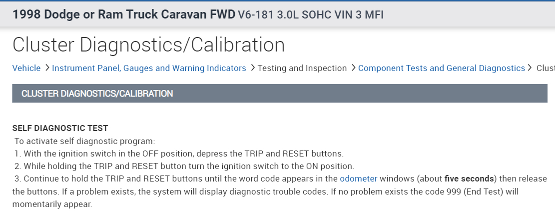

If you haven't already, we need to run the cluster through a self-test mode.

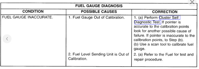

Follow the directions in pic 2. Once you determine if there is a code, follow the diagnostics in the remaining pics.
See pics below.
