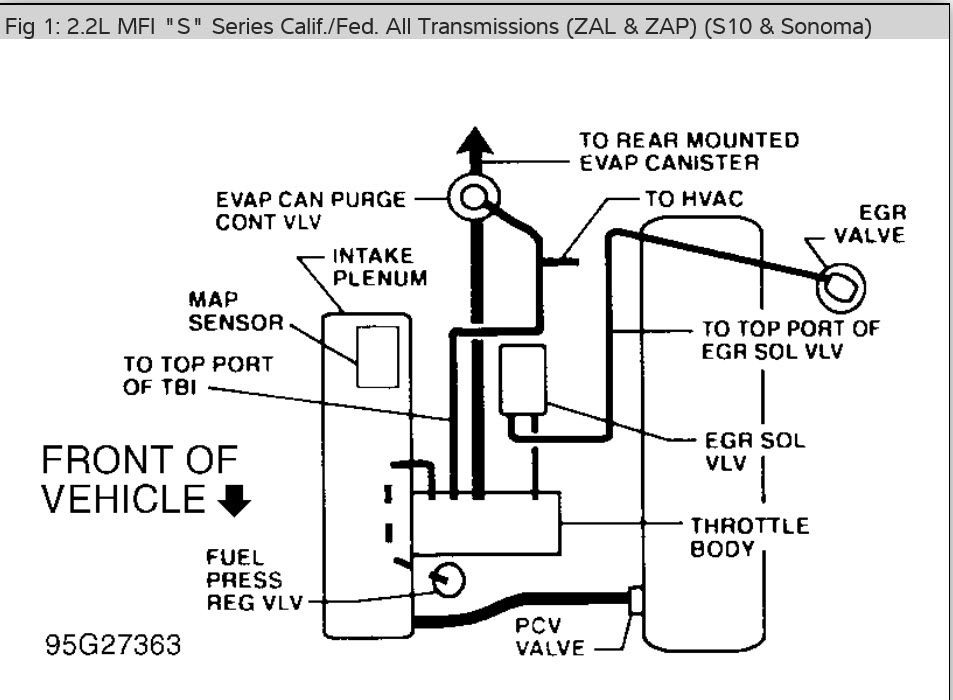

old lines can break , grit from pcv if line was bad , excessive heat, maybe wrong type of tubing this is vacuum schematic for a 4.3L tbi hopefully it is correct

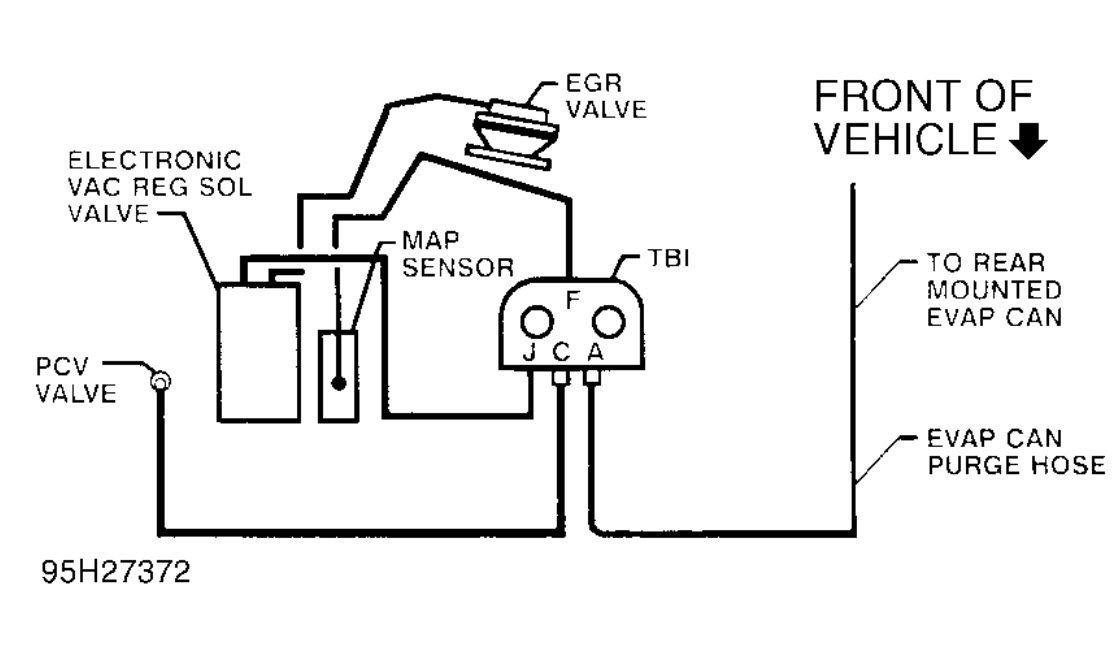

no it won't vapor lock because of electric fuel pump. broken plastic would do it though here is correct one
