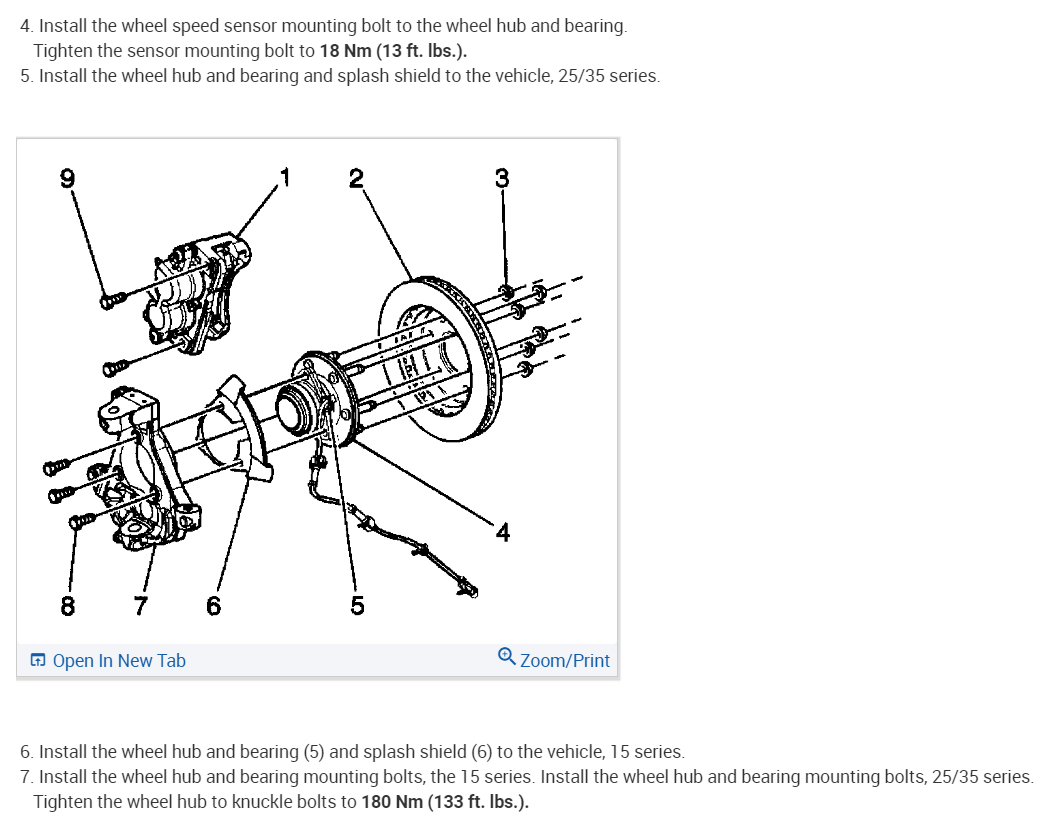

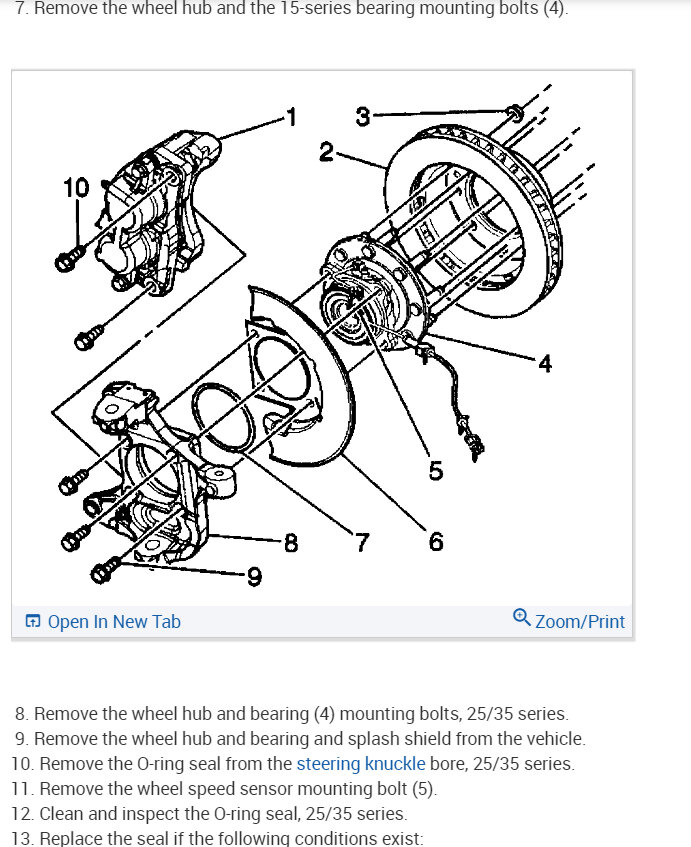

It sounds like the left front bearing hub is defective which will create the problem you seem to be having. Here is a video on how to change the hub bearing correctly:
https://youtu.be/ZgiPRG6jffc?si=npOMtDkwj55Vnbjc

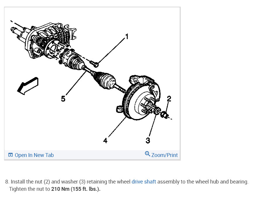

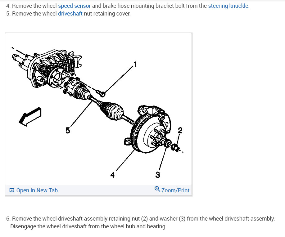

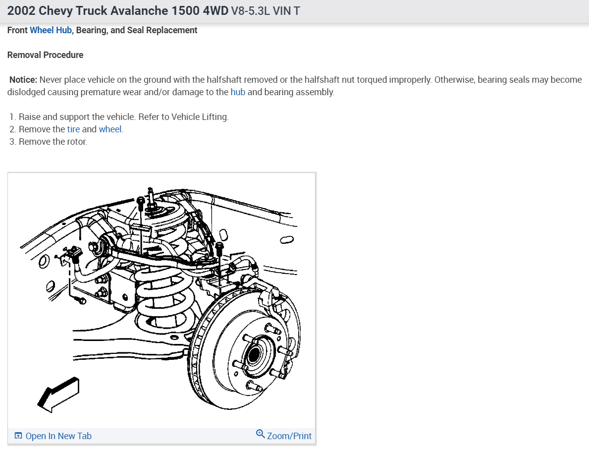

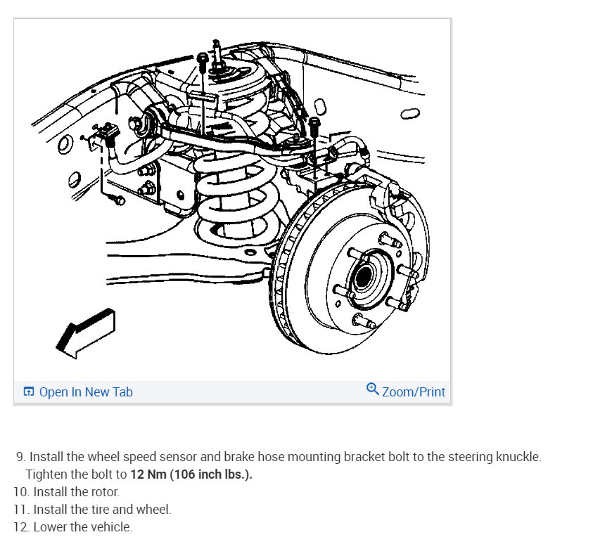

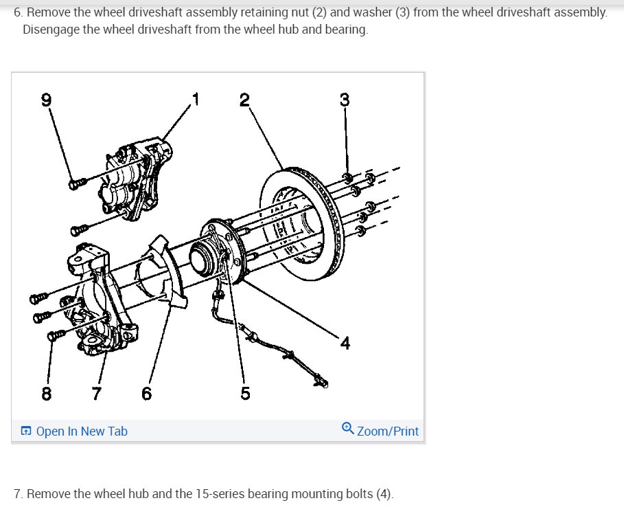

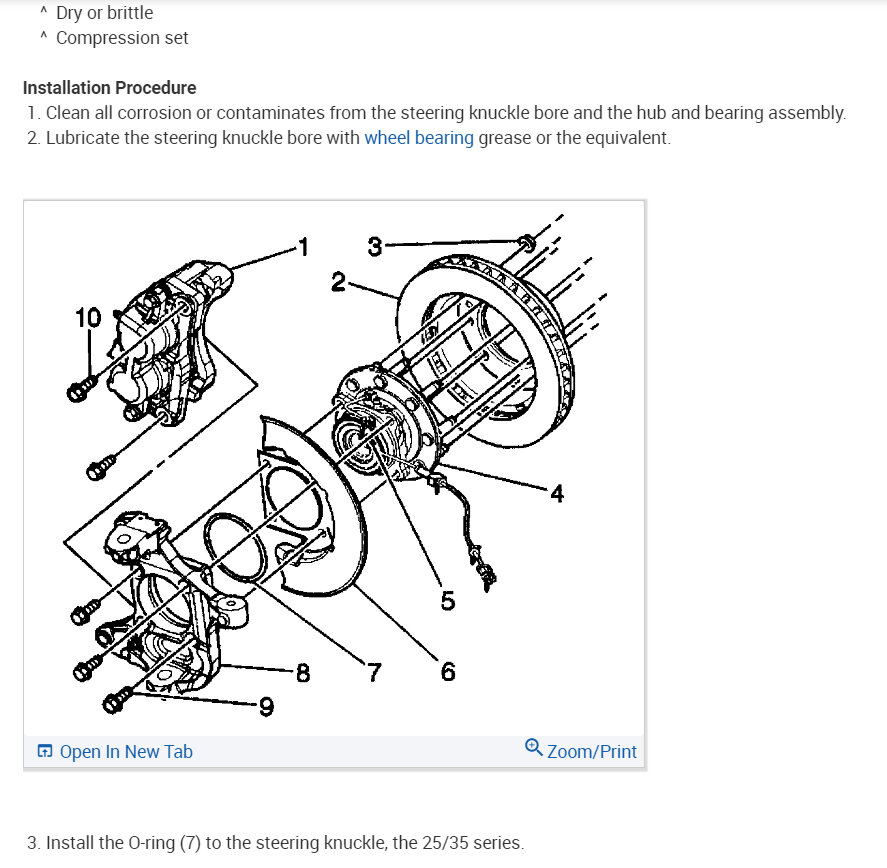

Here are the instructions with torque specs. Check out the images (below). Let us know what happens and please upload pictures or videos of the problem so we can see what's going on.
