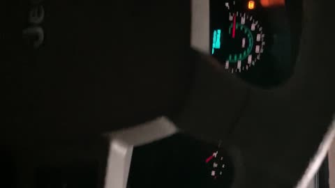

For sure I’m trying to get a video, buts it’s hard to hear over the doors locking. I will try the door thing and let you know. I’ve attached a video last night but it’s almost impossible to hear over the locking.

That is a hard question because you are correct that it is hard to hear. Does it make this noise and the exact same time the doors lock? If so, I bet it is the actuator in one of the doors that is buzzing/grinding.
Can you try something else? Try going to a safe road and keep your door just barely ajar so that the auto locks don't cycle when you hit 15. If it doesn't make this noise either then I am sure that is what this is. Clearly be safe doing this but if you just drive in a straight line you will be fine.

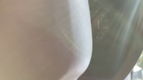

Here’s a video with the door open and the noise still happening.

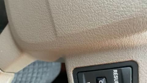

Here’s another video.

I am sorry, but I am not picking out when it is doing it. Do the locks still auto lock when you had the door open? On that second video was it right at the end of it?
Oct 17, 2020 at 5:32 PM
CONNOR MOULTON
  • 8 POSTS
No worries. It’s at 10 seconds of the first video and the first noise like 2 seconds of the second video.
Oct 18, 2020 at 12:09 AM
Okay. Is it the single click or clunk noise? I was under the impression that it was a repetitive grinding noise.
If this is a single clunk noise that only does it once I would not worry about it. However, did the auto locks cycle when the door was open?
Oct 18, 2020 at 6:37 PM
CONNOR MOULTON
  • 8 POSTS
Yeah, it’s like a pop kind of noise it’s like a second or less. And I'm not sure I can check tomorrow. Honestly wasn’t paying attention.
Oct 18, 2020 at 6:44 PM
Got it. If it does it right when the locks move I bet it is related to that. It does not sound like ABS or anything concerning like that. Clearly it can be annoying but I would not be concerned.
