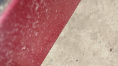

This is the video.

Kindly go through the video.

Thanks sir, it was the front engine mount.

Thanks for the video sorry for the slow response, glad you got it fixed. please use 2CarPros anytime we are here to help. Can you please leave us a rating?
